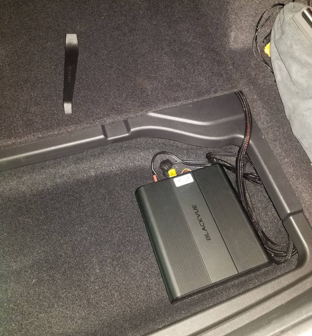

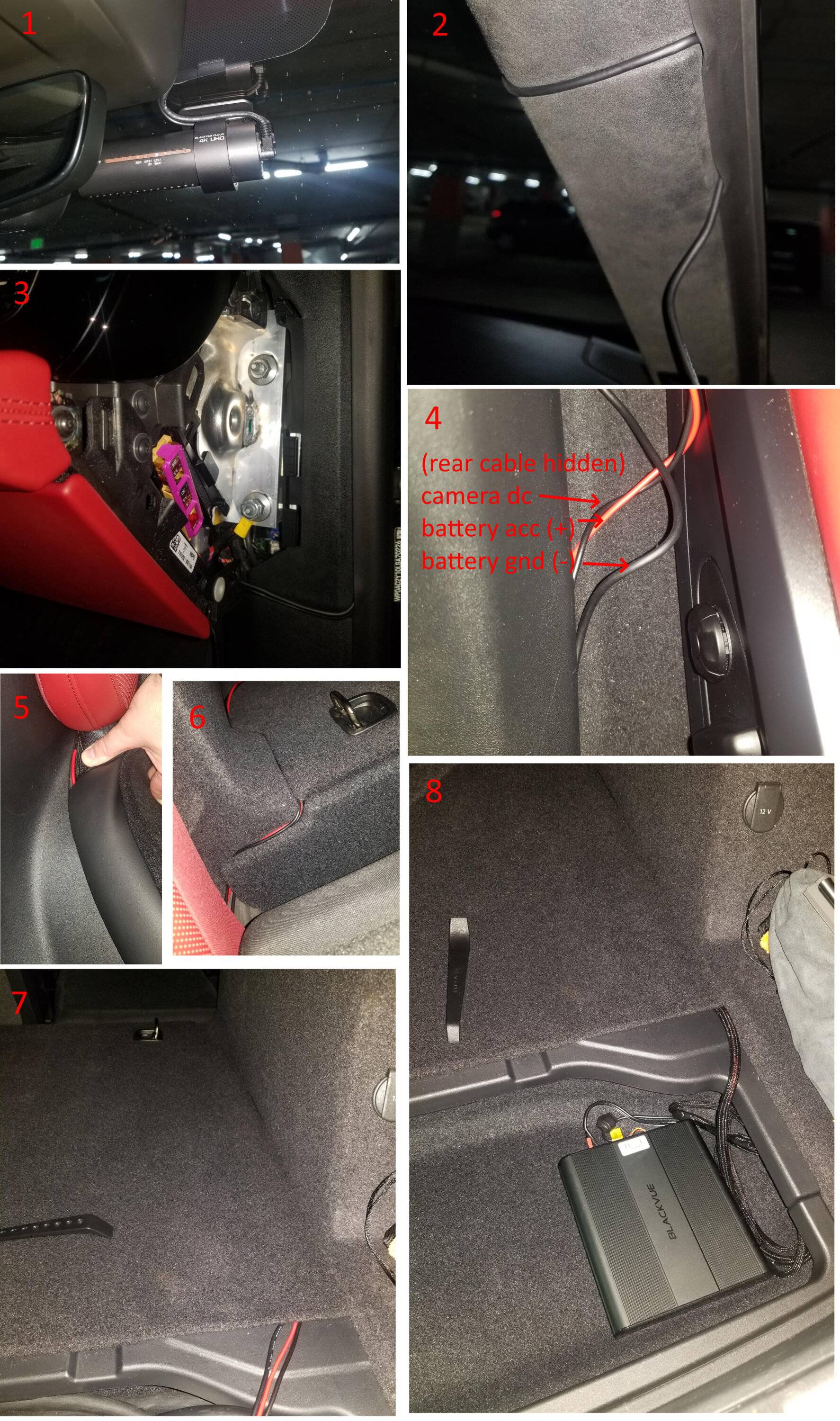

I just installed a front + rear camera with a battery (Blackvue DR900X 2ch + B-124X battery) tucked away in the trunk, and I thought I share some details of the installation :D (btw. if you plan to do this yourself, get the newer DR900X Plus which has an improved image processor).
Porsche Taycan Blackvue DR900X dashcam+ battery B124X installation battery-in-trunk
There are various options to power the dashcam:
  1. Use the cigarette plug -- this is the easiest but once the car is off it will only record for about 30min.
  2. Hardwire the dashcam to the fusebox of the car: this way the camera can keep recording powered by the 12v battery of the car. Now, in theory this is the most elegant solution -- if the car will keep charging its internal 12v battery from the high-voltage battery, the camera can keep recording for a loooonnng time (weeks, months?). However, if somehow the car fails to keep charging the 12v battery while off, then there is a lot of trouble as one cannot open or start the car anymore :-( (This used to happen with older Taycan models, and still seems to be the case if the HV battery drops below 10%). I personally don't want to risk this, so, option 3:
  3. Use a separate battery just for the camera (the B124X) which can power the camera for about 18 hours. This battery is hardwired to an "ignition" fuse so it is only charged from the car 12v battery when the car is "on" -- no risk anymore to drain it.
To install the battery, again there are a few options:
  1. hardwire it in the passenger footwell with an easy cigarette lighter connection to power the camera (see this thread where the battery is put under the passenger seat)

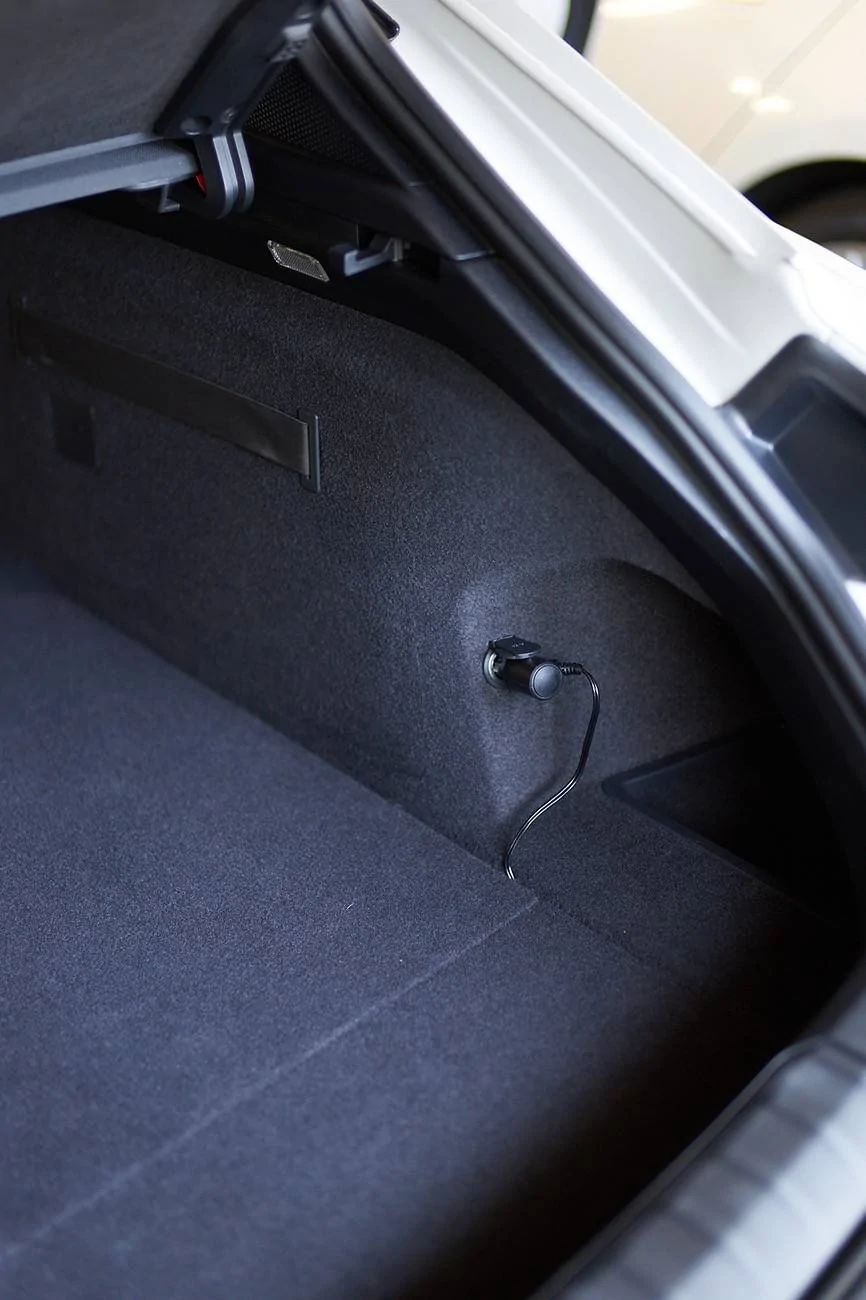

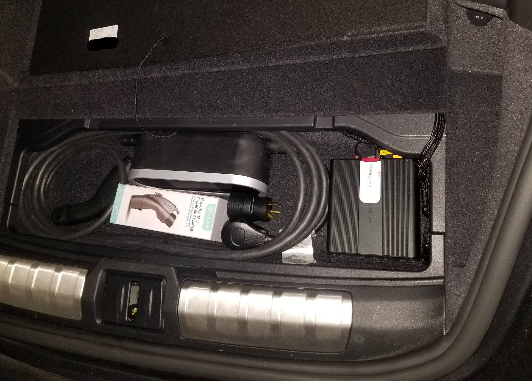

  2. Use an extended camera power cable, and place the battery in the trunk using the 12v cigarette lighter outlet there to charge the battery (see this post for an example). This is still a bit risky though: after turning off the car, the camera battery will charge from the 12v car battery for about 30 minutes -- but it will draw more power than just a camera (5A vs. 0.4A) and that may drain the 12v car battery perhaps... well, in theory as the car should charge the 12v battery from the high-voltage one. So it should be ok, but again, for me I do not want to risk this.
  3. Hardwire in the passenger footwell fusebox, but use an extended battery power cable (and extended camera power cable) to still place the battery in the trunk. This is what I did -- this way the battery only charges when the car is "on" and it is neatly hidden in the trunk :cool:
Now, the drawback is that you will need to solder some wires together to create longer wires than provided with the Blackvue battery :( Soldering is a bit of a hassle but not too difficult, here is a nice tutorial. And if you don't like to solder, you could always use crimping or nice heat-shrink connectors.
For the hardwired battery power connection, I bought two 17 feet, 14 AWG wires (red+black) from Home Depot and soldered it to the connector that was provided (do not use thinner wires as the charging is done at 9A). For the camera power cable, I soldered the Blackvue provided cable (with the B-124X) to the hardwire power cable that comes with the 900x camera to have enough length.

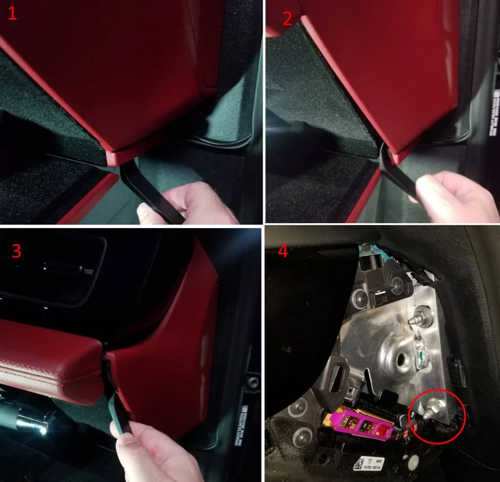

To remove the passenger side panel, work from the bottom to the top and it pops right out. This gives access to a ground screw:
Porsche Taycan Blackvue DR900X dashcam+ battery B124X installation remove-side-panel

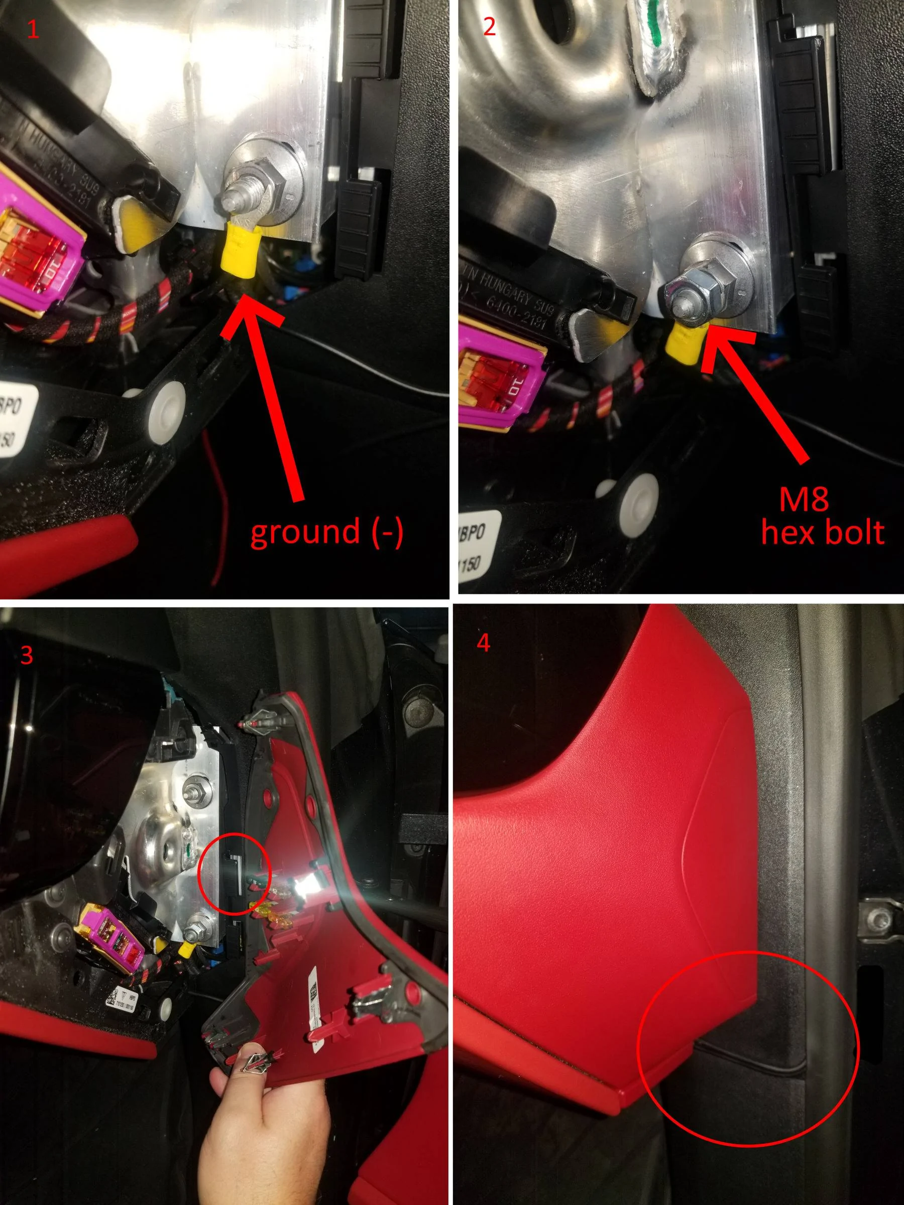

Then, attach the battery power ground wire, which you can do by using an M8 hex nut. That way there is no need to loosen the existing nut. (don't close the side panel until later to hide cables better)
Porsche Taycan Blackvue DR900X dashcam+ battery B124X installation install-side-panel

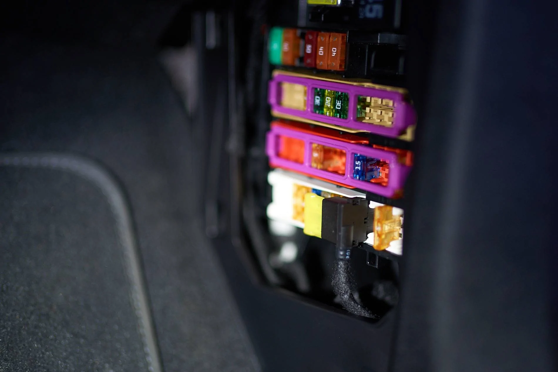

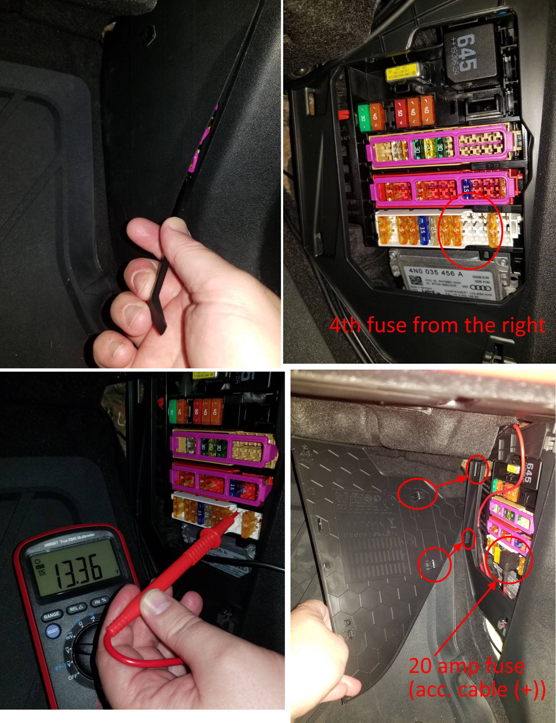

After this, remove the fuse box panel in the passenger footwell :
Porsche Taycan Blackvue DR900X dashcam+ battery B124X installation install-bottom-fuse

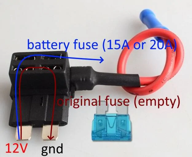

The fourth fuse slot from the right at the bottom row is unused, but gets powered only when the car is on, just what we need. (The manual says this fuse location is only used for "right-hand-drive" vehicles to power the BCM control unit). Use the fuse-tap that comes with the B-124X and the provided yellow ATC 20A fuse (actually, if you have a blue 15A fuse that would be a bit better as charging is at most done at 9A).
Place the new fuse at the top of the fuse-tap and leave the bottom one empty (as it is an unused fuse slot), and attach the red acc. cable for the battery to the fuse tap using the provided crimp connection using a crimping tool. Insert the fusetap "downwards" as shown in the picture since only the top row of the fuse panel is powered. (don't close the panel until later so you can route cables nicely).
Porsche Taycan Blackvue DR900X dashcam+ battery B124X installation fuse-ta

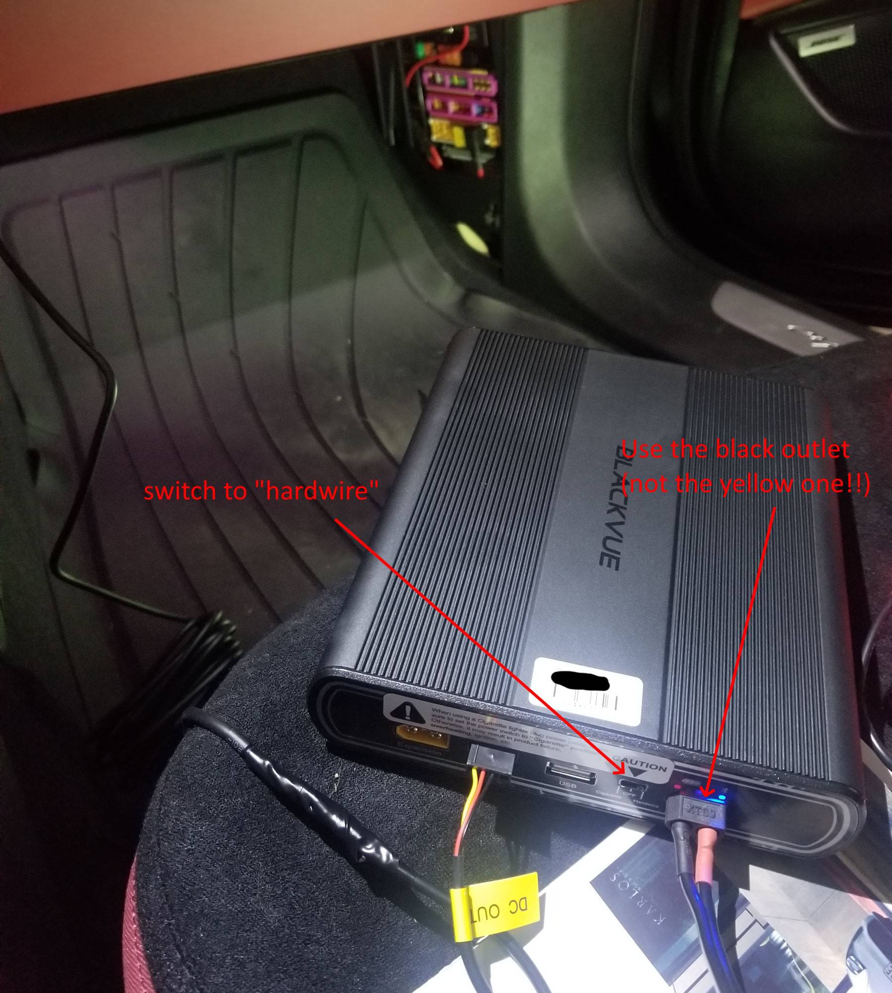

Now test if the hardwired setup is working by directly attaching the B-124X and the camera:
Porsche Taycan Blackvue DR900X dashcam+ battery B124X installation test-install
You can connect with bluetooth to the battery (using the app) to see it charge when the car is turned on, and drain when the car is turned off. (in my case, the new battery was completely empty so needed to charge for a few minutes before bluetooth started working).
If it all worked, we can then route the camera power cable, the rear camera cable, and the hardwired battery power cables all the way to the back. I think the best way is on the bottom of the car next to the seats under the plastic panel there -- can be done just by pushing under it. (I did not remove any panels).
Porsche Taycan Blackvue DR900X dashcam+ battery B124X installation cablin
Quite a bit of work, but happy how it turned out :)

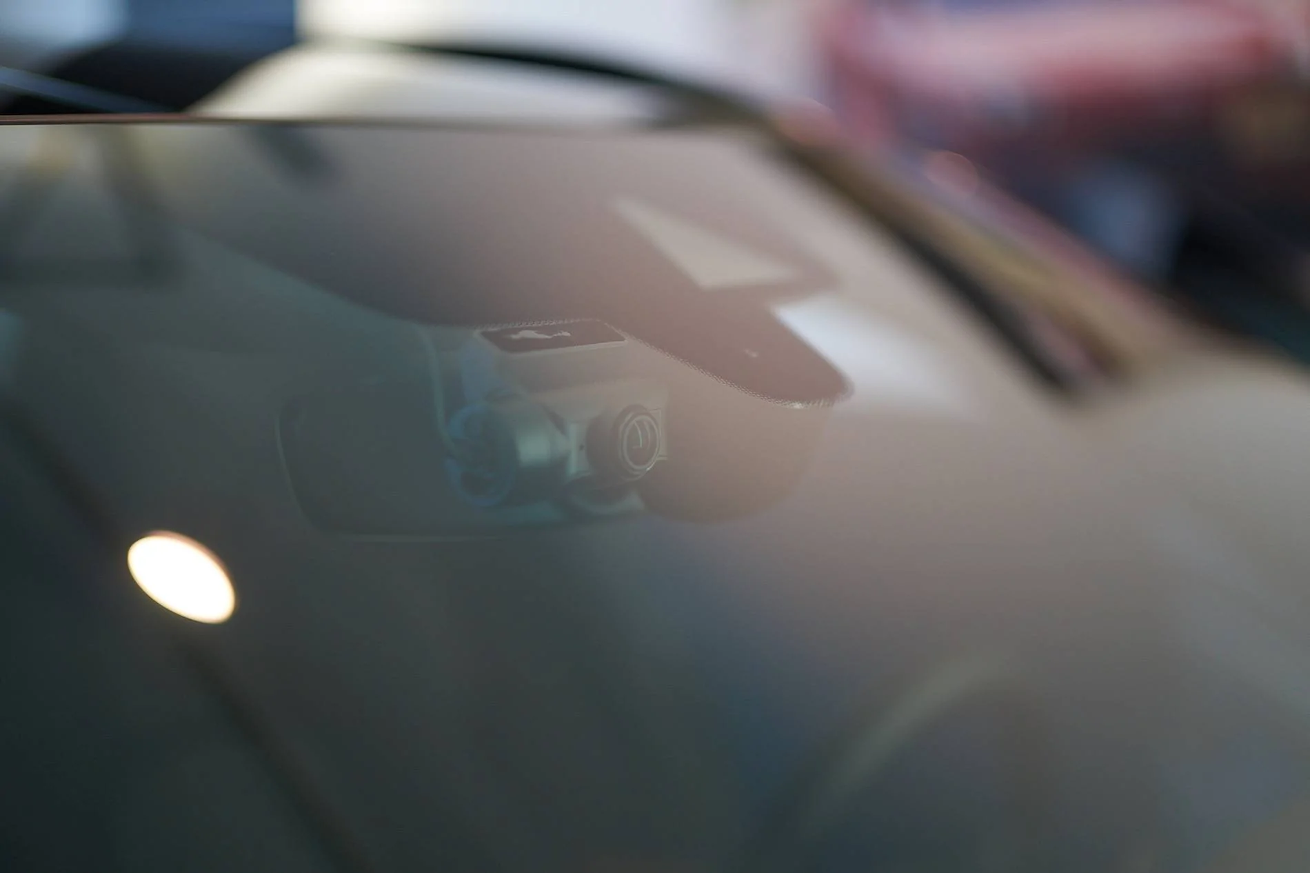

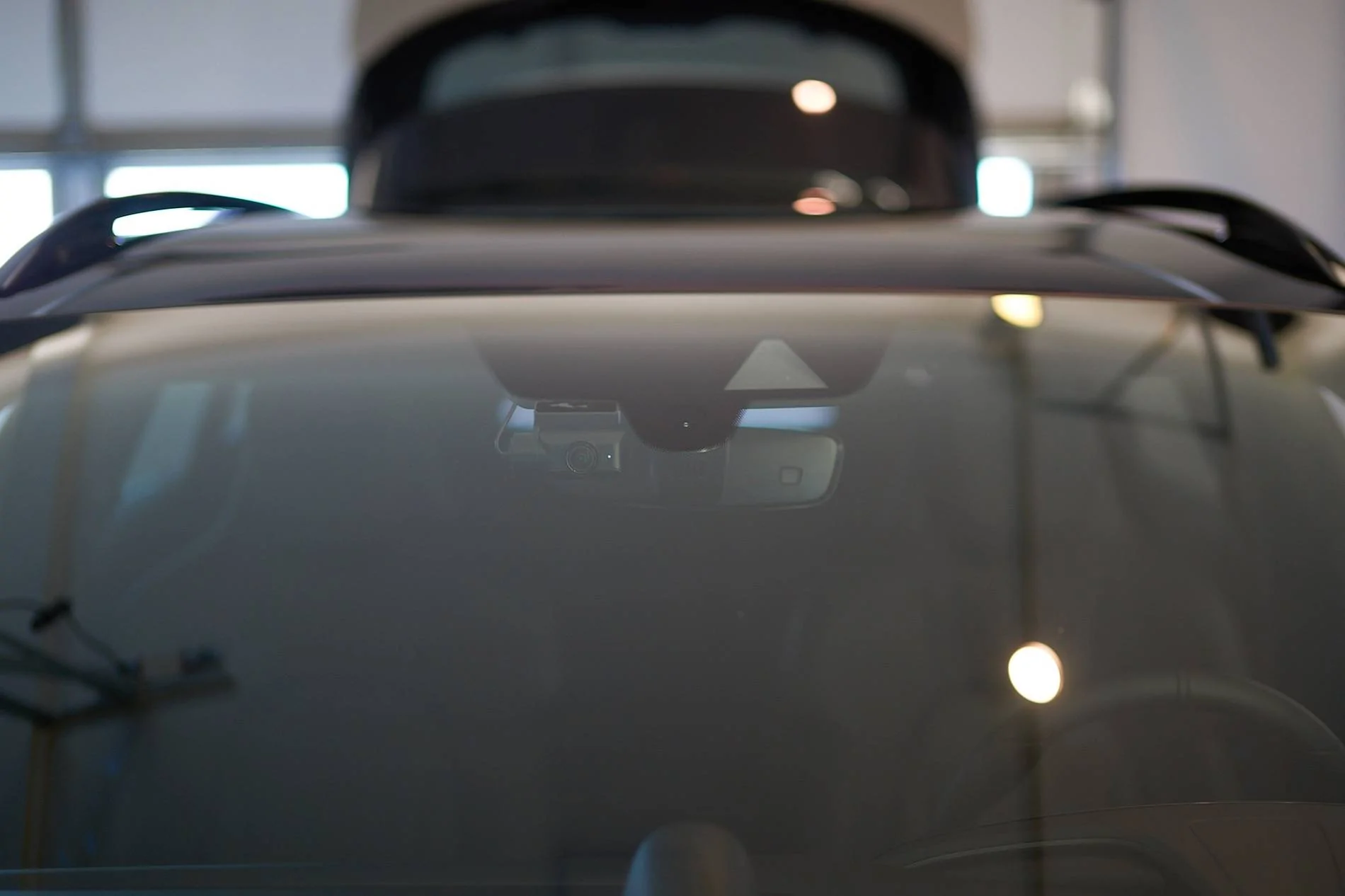

edit: 2022-10-30: it turned out that the camera could not receive a GPS signal at the installed spot as shown above (1). I think this is due to the thermally and noise insulated glass perhaps. I needed to remove it (use the plastic tool again to force it off and use thinner/turpetine to remove the glue residue), and reinstall the camera inside the dotted area:
Porsche Taycan Blackvue DR900X dashcam+ battery B124X installation camera-front
unfortunately that makes it more visible and less centered but overall it still looks fine; I tried other areas but this one is the only one that had reliable gps reception. (here is another thread that uses a similar location -- that one is a tad more to the left but then you will get the black dots into the view).

Some more updates; I got a bit carried away and added an extension battery (B-124E) and also a 4G wifi dongle which works with T-mobile in the US. T-mobile has a $10/month prepaid data plan with the first 2gb high-speed and then low-speed unlimited -- perfect for dashcam uploads.
The 4G wifi dongle connects with a short USB cable to the battery and is thus powered as long as the dashcam is powered. The dongle turns on automatically and re-establishes a connection whenever it gets power. When you first put in the SIM, just power it from a charger and connect to its WIFI from your phone -- you can then go to address 192.168.1.1 with username and password "admin" to adjust the settings.
Here is how it looks installed (with the dongle on top of the B-124E which is on top of the B-124X):
Porsche Taycan Blackvue DR900X dashcam+ battery B124X installation cargo
With the free blackvue cloud account, you can have live-view (and talk and listen), and it will upload video automatically when there is an impact detected during parking mode etc. Still a bit limited (no geo fencing etc) but the other non-free accounts are a bit too expensive for my taste :)

@800v I just got the cloud 970 installed in the same position as your original. How could you tell the GPS wasn't working properly? Error messages in the app? I haven't noticed anything out of the ordinary.

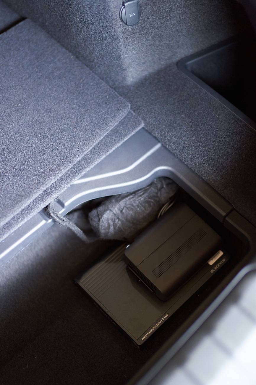

Installed: BlackVue DR970X-BOX-PLUS 2-Channel with the B-130X battery pack (there is a similar, slightly newer B-130A).
Newer model, similar benefits, of note:
  • smaller, stealthier camera units
  • "box" contains processing and memory card and keeping it far from the windshield helps much in reducing operating temperatures (should have less memory card failures, improved life of system)
  • con: B-130X, while having a large 95WH capacity, is non-expandable

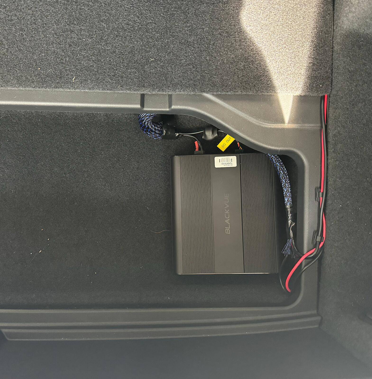

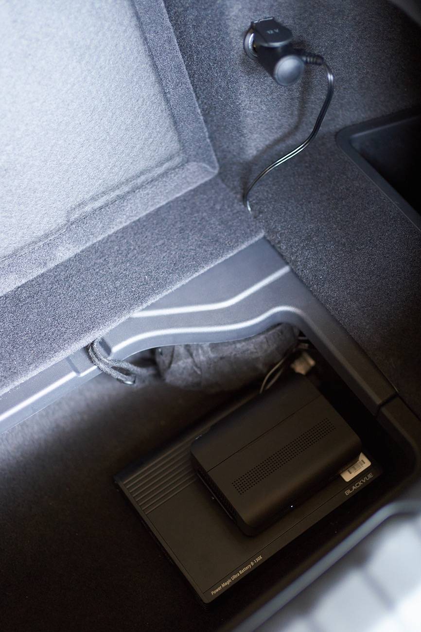

This post was a big help, thank you @800v. My installation was very similar, though as you can see, I went to town on using Tesa PET fleece tape (I hate noises & rattles).
originally installed with cigarette lighter (in case dealership gives me trouble, and it was easier to wire)- limited to 5A charging:
Porsche Taycan Blackvue DR900X dashcam+ battery B124X installation DSC02310
Porsche Taycan Blackvue DR900X dashcam+ battery B124X installation DSC02313
After a few days, realized that short drive days would not be sufficient to charge the battery pack, so hardwired as in OP, 9A charge rate, and freed up the plug I have the cigarette lighter plug tucked in the compartment so it would be easy to swap it in if ever needed:
Porsche Taycan Blackvue DR900X dashcam+ battery B124X installation DSC02319
Porsche Taycan Blackvue DR900X dashcam+ battery B124X installation DSC02314

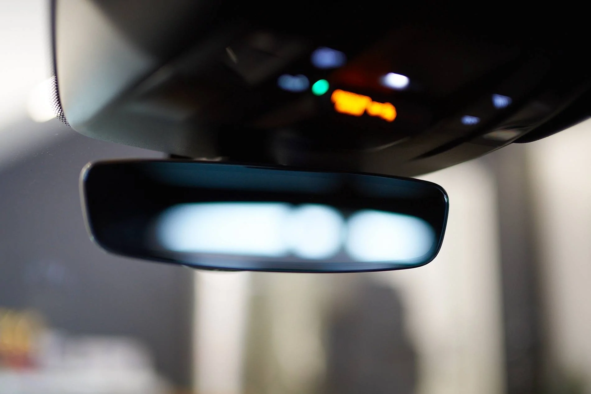

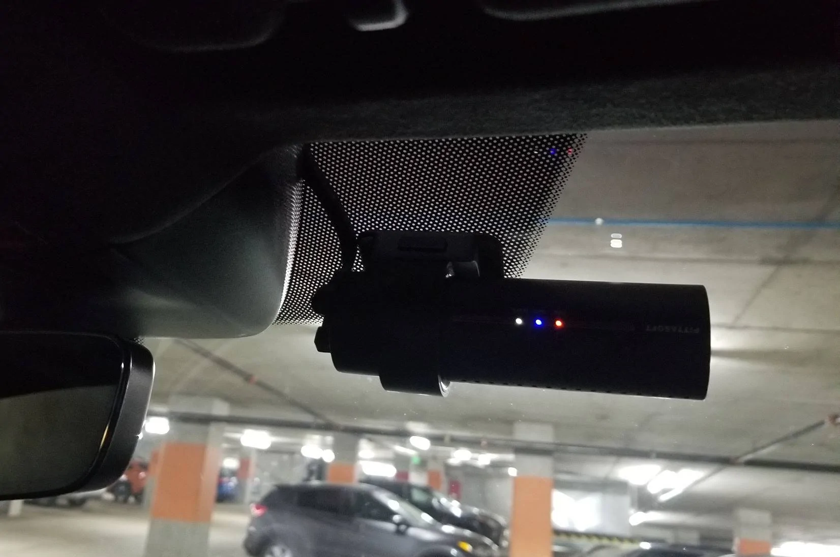

View of dashcam from passenger side:
Porsche Taycan Blackvue DR900X dashcam+ battery B124X installation DSC02323

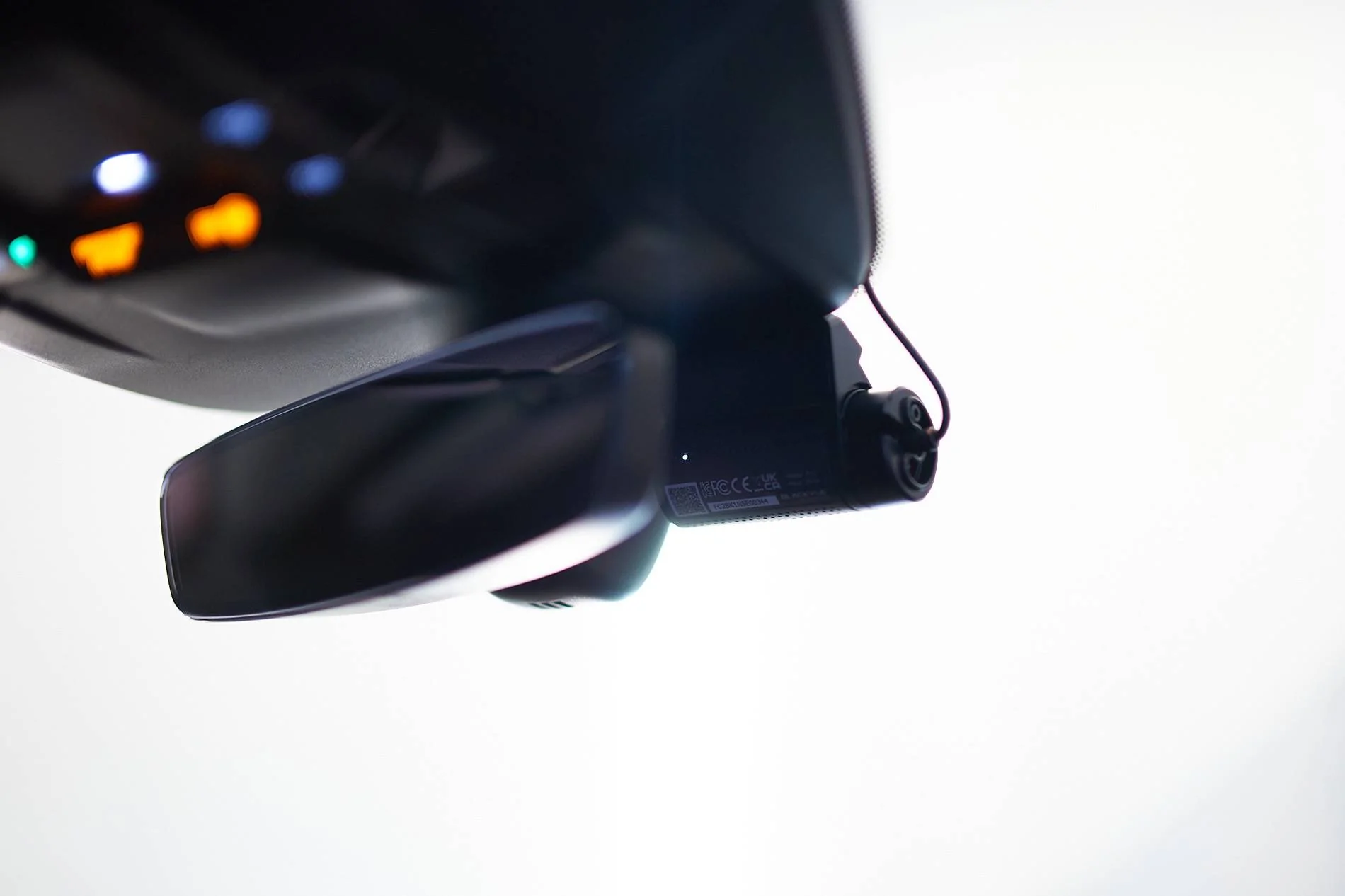

Outside view of front dash cam.
Porsche Taycan Blackvue DR900X dashcam+ battery B124X installation DSC02324
Porsche Taycan Blackvue DR900X dashcam+ battery B124X installation DSC02325

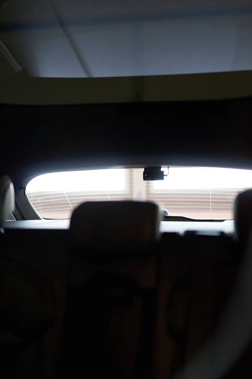

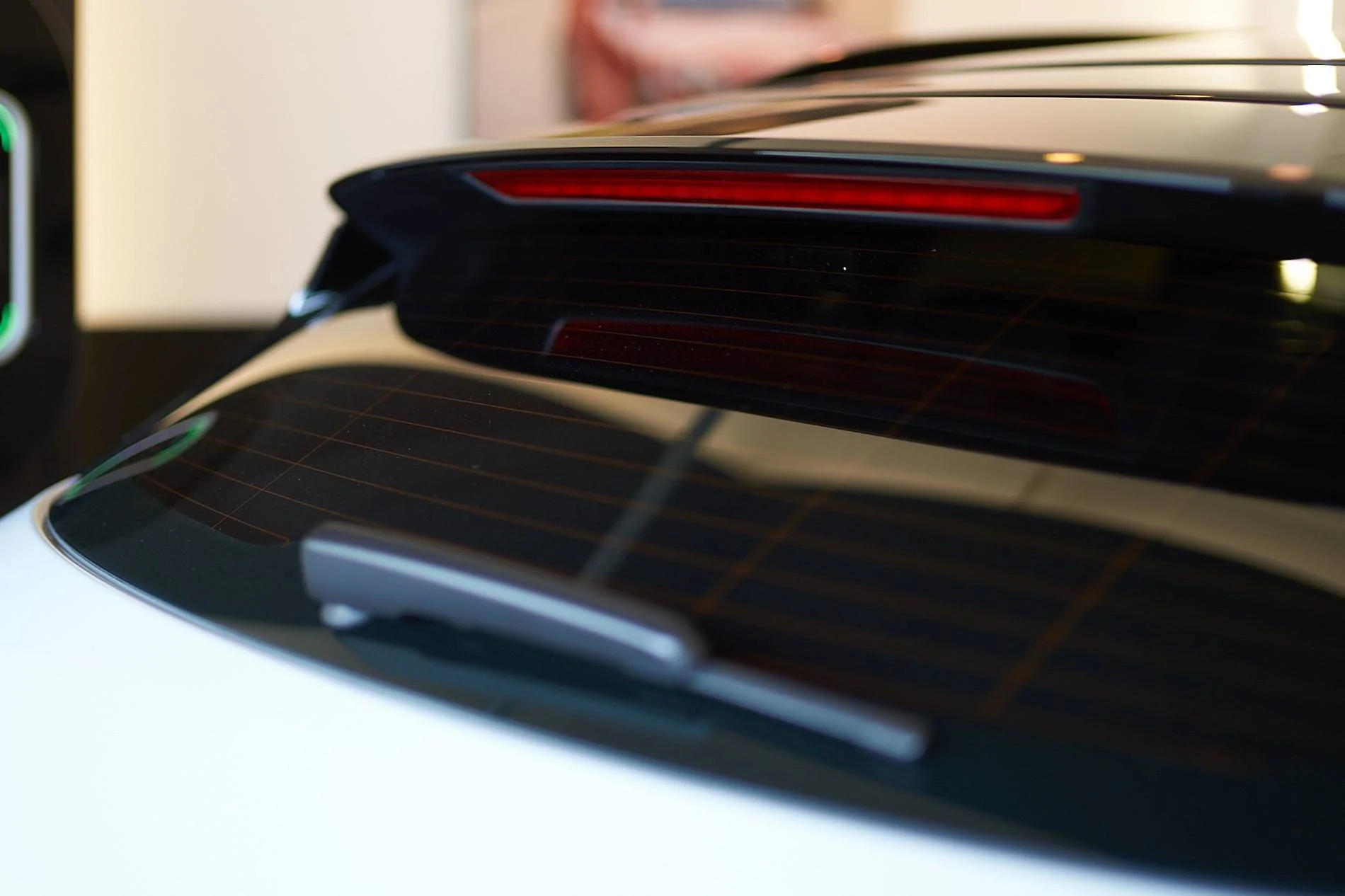

rear camera:
Porsche Taycan Blackvue DR900X dashcam+ battery B124X installation DSC02328

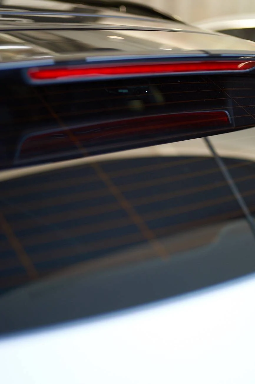

with 30% window tint, it's hardly noticeable from the outside (only the optional LED indicator light)
Porsche Taycan Blackvue DR900X dashcam+ battery B124X installation DSC02329
Porsche Taycan Blackvue DR900X dashcam+ battery B124X installation DSC02330

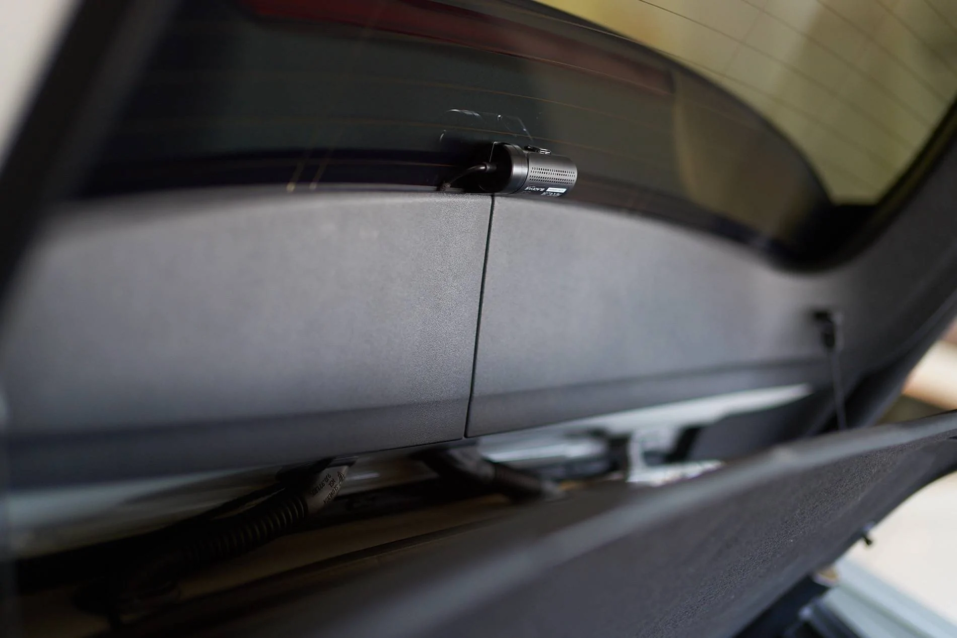

rear camera for box unit has 2 LED indicator lights (one faces the cabin).
Porsche Taycan Blackvue DR900X dashcam+ battery B124X installation DSC02332
driver's view of rear mirror and front dash cam hidden from view

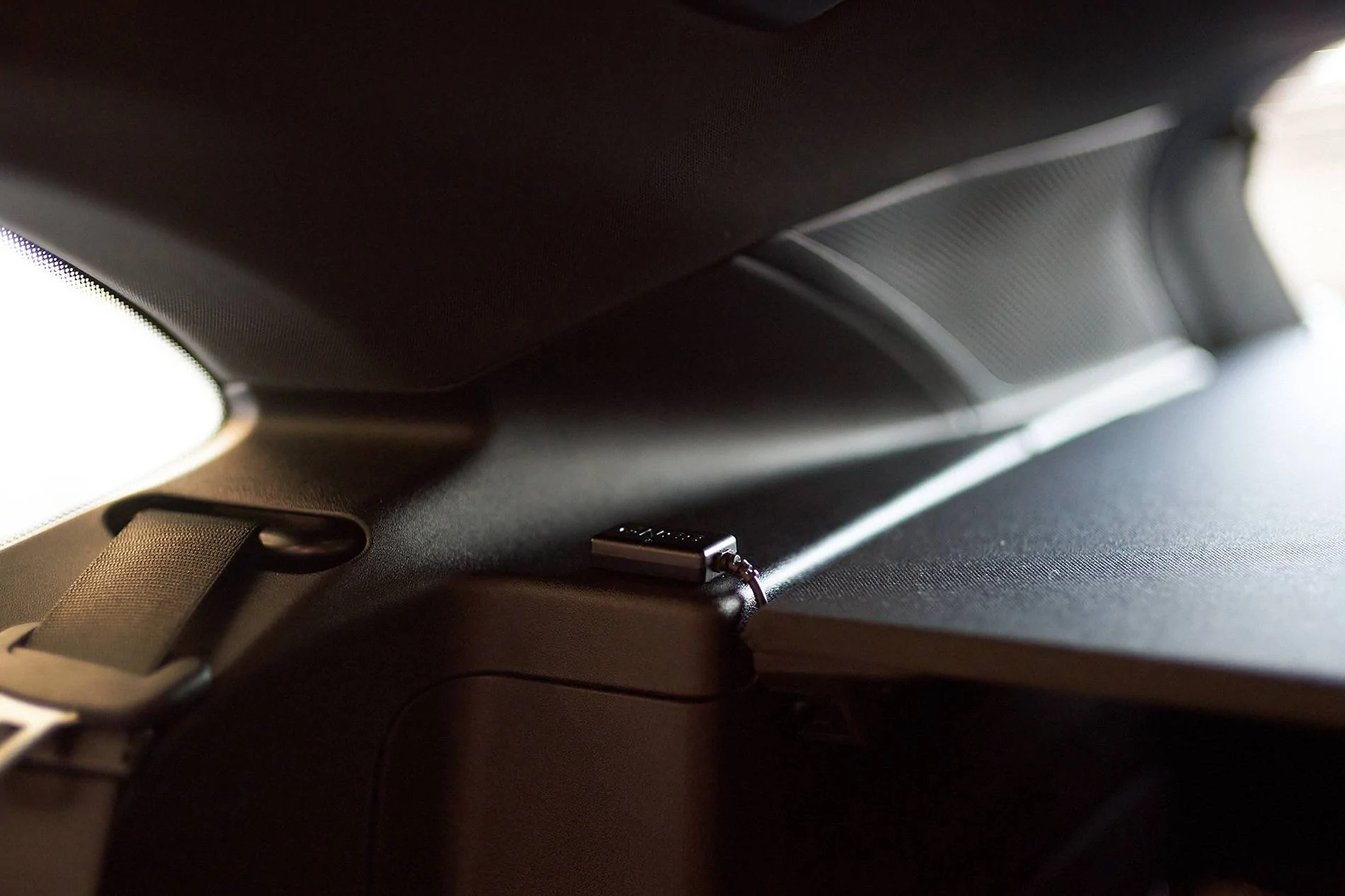

box unit comes with external GNSS / GPS module, in my Cross Turismo, this is a convenient mounting point and gets reliable data.
Porsche Taycan Blackvue DR900X dashcam+ battery B124X installation DSC02338

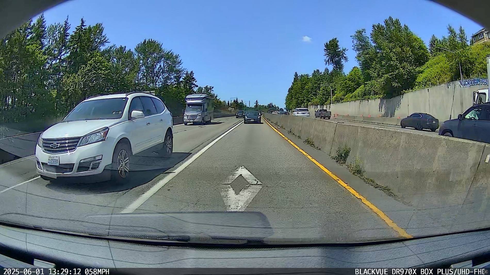

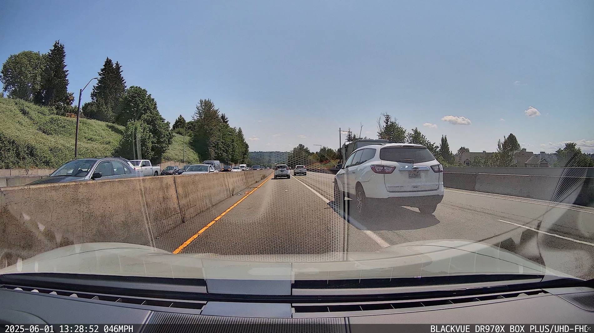

Sample video stills:
Porsche Taycan Blackvue DR900X dashcam+ battery B124X installation cam-front
Porsche Taycan Blackvue DR900X dashcam+ battery B124X installation cam-rear

Good write up thank you. Could you show some images how you wired the rear cam, especially from cabin to rear trunk-glass area.
