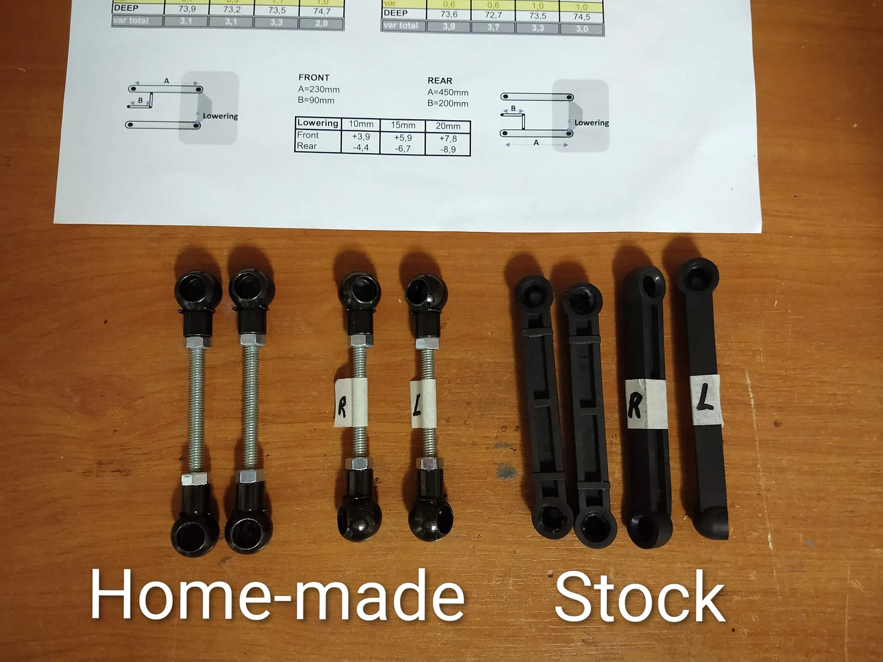

Well, I lowered mine 10 mm and it cost me less than €10.
Ok, I had to make some calculations myself.
The problem is it voids the suspension warranty if they are on the car and there is something wrong with it.
So you need to swap them back and forth as opposed to modifying the adaptations...
For MY24 and up it's the only way though for the end user (or a module), but any module that requires you to cut the original harness is a no-go imo.
Dee
Dee
Dec 14, 2018
78
3,513
4,056
A lot
I don't have warranty nor a problem with the suspension (five years already).
That's a 10 minute job.
The point of my post is that you can lower your car for less than €10 (and you don't need fancy programmer's skills or a computer).
That's the beauty of air suspension. 😉
PS But if you go lower than 15 mm you need realignment.
You can actually see it by the visible increase of camber.
You don't need any programming skills (you are not doing programming, just changing 4 numbers in a box!).
Computer - most people already have that.
I haven't checked the ID of the suspension controller but chances are you can use VCDS and OBD11 as well.
It takes just a minute to change the 4 adaptation values to lower or higher value, and that doesn't involve messing around under the car.
I just never see the point of doing something with hardware that can be done easily with software.
I understand what you're saying but most people here are not into software, they rather pay big money for expensive kits or even €150 links.
My point is, again, to show it can be done for less than €10 and without any knowledge of computers/software.
Besides, if you want to do it by software you need the right program (3VIN-VCDS is €300, OBD11 doesn't work on Taycan).
So you need at least €300 before you can actually do something.
You, as a WizKid, knows how to do this.
I, and many others here on this forum, don't.
I checked my VCDS and even found the security code for the module but still I don't dare to change anything.
It was said you can't even do this in VCDS so...
Hardware is more my territory, that's all, especially when it's less than €10 (and it's fun to work on your own car).
Cheers! 🍻
