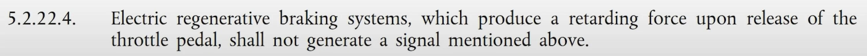

I just came across an interesting bit of information. EU specifically forbids brake lights from being illuminated during EV regen/recuperation! :surprised:
Porsche Taycan Brake lights during recuperation? 1685754774585
More details here. TLDR; in the US it's up to the manufacturer, while in EU it's forbidden. :facepalm:
Update: EU did just fix this regulation problem a couple of months ago.

I updated the original post, apparently they just fixed it in March of this year, so perhaps Taycans will have an update in a year, but maybe not for the US market.
I've just checked the version of the regs used in that video- they're the original ones from 2010.
The ones I posted in April this year are Revision 4 of Regulation 13-H, document dated 5th June 2018, and do require brake lights to illuminate on lift-off (above the specified deceleration threshold)-
https://www.taycanforum.com/forum/threads/regenerative-braking-setting.15633/post-239250
relevant sub-para-
5.2.22.4. Electric regenerative braking systems as defined in paragraph 2.17. of this Regulation, which produce a retarding force upon release of the accelerator control, shall generate the signal mentioned above according to the following provisions:
Vehicle decelerations / Signal generation
≤ 0.7 m/s² The signal shall not be generated
> 0.7 m/s² and ≤ 1.3 m/s² The signal may be generated
> 1.3 m/s² The signal shall be generated
In all cases the signal shall be de-activated at the latest when the deceleration has fallen below 0.7 m/s².
