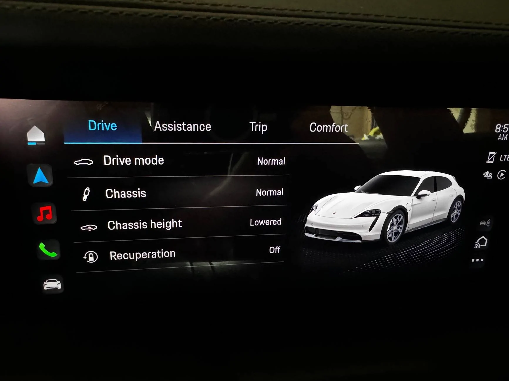

The name changed slightly but it’s still exactly where the manual says it is. That feature is not what you think it is though. It just determines what happens when you lift off the accelerator.
Porsche Taycan Brake Recuperation IMG_1839

I agree with @Hirschaj: recuperation is what happens when you lift off the accelerator. Note that it's off by default in 'normal' driving as Porsche believe this is more economical. Personally, I like it on so fortunately there's a button right there on the steering wheel and an indicator bottom/left of the dash.
As for the brakes, @Bennachie: I was told when I collected my Taycan that the car will use friction more in the first 1000 miles to let them bed in, then afterwards the car prefers to use recuperation for gentle braking and use the friction brakes for heavy braking and coming to a stop. If you're particularly concerned about cleaning up your brakes I'd suggest a couple of heavy braking episodes occasionally would do the job.
