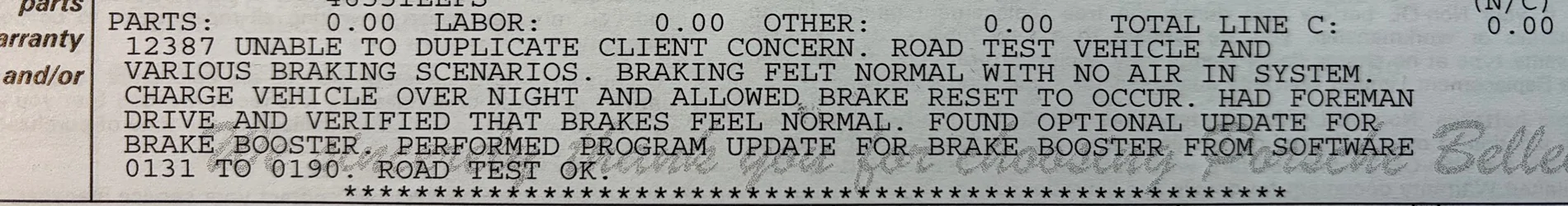

@freinando I experienced something similar and had my service center look at it closely. There was a ""Found optional update for brake booster. Performed program update for brake booster from software 0131 to 0190"".
You might want to check if you can have this update applied.

same here, for the same exact updates, but also included my brake concern.
