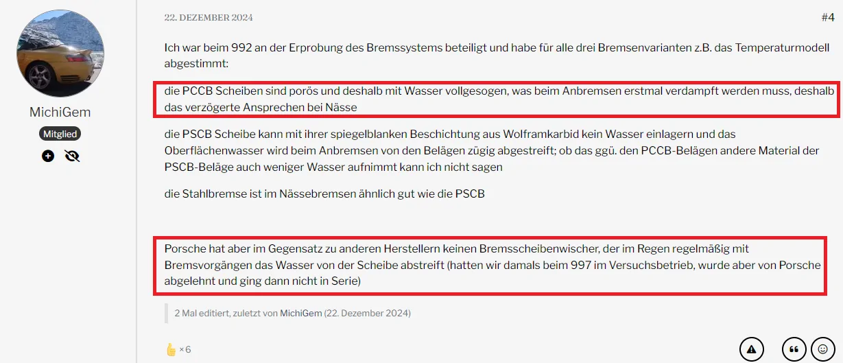

There is a post from a Porsche engineer responsible for calibrating the brake systems on pff.de, who said exactly the same about PCCB, that I am saying here as well. But you do you.
Lol, he makes it looks like the disks are littered with water which isn't even the case.
It's only on a molecular level and disappears within milliseconds when you press the brake, it evaporates very quickly.
I never had such an obvious experience, maybe a fraction of a second but way less than having soap on your disks.
But hé, you are right.

Clearly you know more about the PCCB on Porsche, than their engineer responsible for calibrating the brakes on their cars for over 20 years, have you considered offering them consulting services? ;)
