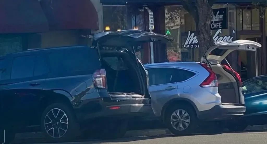

So no obvious answer to the OPs issue of how they got in?
Do you have Comfort Access Sheila?
....... But even so, with the new key design (I don't know cause I don't have Comfort access) relay theft should not work.
I am very security aware after previous experiences (armed robbery at home) but am only aware of 2 Taycans actually being stolen.
One on here (US) where they stole the key at the dealership.
And this couple of low life scum (UK) who don't seem to know how to even drive/start the car.

Yes i do have comfort access. Right now my car is at the dealership and they’re trying to find out how to raise the security level and reprogram the keys. So far I bought a faraday box

I'm going to ask a stupid question. Are you sure your car was locked? I say that because if you
just walk away after (30?) seconds the handles fold in but the car is NOT locked.
The other issue I have had is when I lock the car and kind of walk around a bit near the
car it might unlock. Also if it is in something that hits the button it will unlock. This is true
of all the cars I have owned, sometimes in my pocket the FOB buttons are pressed...
You can also get small faraday pouches for key fobs/credit cards that are nice to have when traveling.

Yes im positive it was locked. Because of the first theft I religiously check if it’s locked

Another possibility is that it's somebody that knows you. Remember the car can be controlled remotely via your porsche.com account. Your account could be compromised.

Thank you everyone for all the responses. I left my porsche at the dealership for a week hoping for answers but i got better information from this forum than the service at the dealership. They said that the memory only stays for 20 times of lock/unlock and they couldn’t tell me anything useful for future usage. Basically told me to put my keys in a faraday box and if happens again bring it back immediately. I appreciate everyone’s input. …. And no im not a thief and the picture is real ?
90
8,458
7,451
  1. Put your keys in a faraday cage when at home, as you're already planning. Don't forget the spare key.
  2. Change your online password to a new, never used on any other site account. If you are currently using a password used on any other site and that site was compromised, the thieves can locate your car, and remotely unlock it at will.
  3. If possible, setup a security camera recording where the car is parked. Those are relatively inexpensive nowadays, especially to anyone who can afford a Taycan. Having a video of a breakin can help identify the mode of entry, and possibly catch the thieves.
  4. Never store anything irreplaceable in a car. No matter the car (except maybe some armored trucks), there are always ways to get into them whether destructive or not. You would not want to be driving a car into which first responders cannot get in to save your life in case of an accident. And even if you were ok with that, any car can be stolen by a tow truck in under 30 seconds (scary, I know, but you can find examples on the internet showing it's not that hard to pull off).
