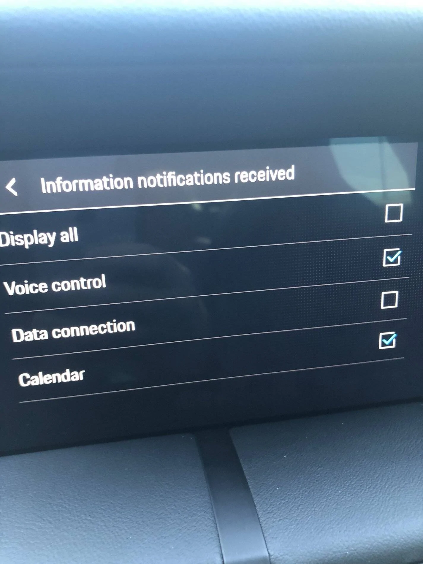

This has happened to me twice so far. Volume gets stuck at -1, and it’s right after or during an update. It goes away with the two finger reset, or simply leaving the car locked for about 15 min. It’s annoying for sure.
Same here, every time I turn the car on, the SIRUS goes to the preview channel, and I get a message saying "your subscription has been changed". I have to press ok and change the channel by Voice Com to the one I want it. Annoying but I gave up after spending at least 2 hours with SIRUS tech folks who have no clue and 2 attempts with the dealer, who also know nothing about fixing this issue. BTW this diamond programing TRICK, won't fix anything and PCM 2 fingers reboot thing won't fix it either. However, I just tried a new trick to disable car notification especially "data connection" which will turn off "display all" , while I kept all other notifications and so far this annoying message from SIRUS subscriptions is gone! I'm not sure if this trick will last and succeed in terminating this message from SIRUS XM or not. Time will tell!

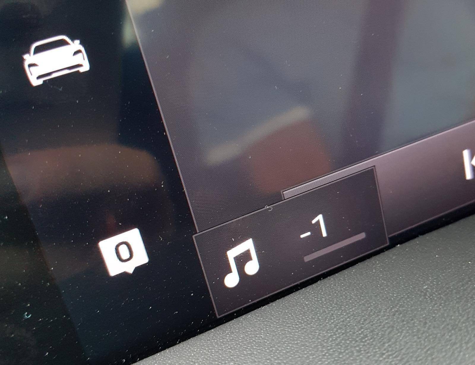

this usually only happens with Apple Music, Volume is fixed or at minus 1 and cannot be adjusted.
Simple fix is going to (DAB) Radio, change volumne and go back to Apple Music.
I get it with Bluetooth radio (since there is no support for Android Auto). If I change the source to radio and then go back to Bluetooth, it resolves but it is a pain to do on a regular basis. Hoping for an OTA fix at some point.
