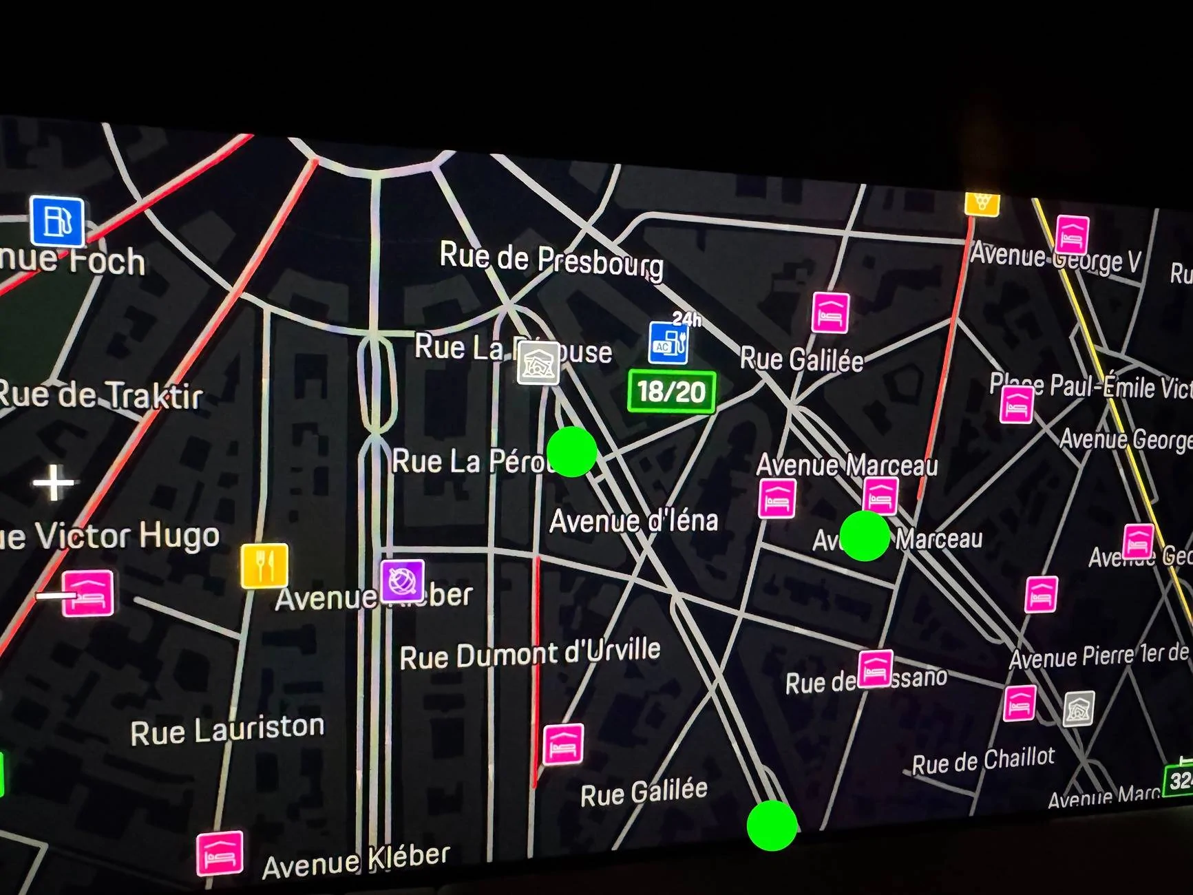

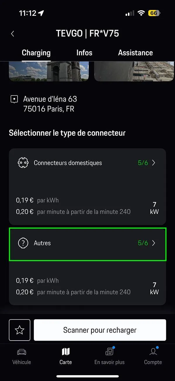

Where it gets interesting is that I noticed that all missing charging stations from PCM are present in MyPorsche app but their connector compatibility is wrongly referenced: MyPorsche app shows “(?) Autres” as a connector which can be translated to “(?) Others” in French instead of “Type 2”)
Porsche Taycan PCM bug (J1.1) - Open case with Porsche IMG_4275
This a screenshot from my PCM showing 3 missing charging stations (green dots)
(You can use the same postal address I provided above to display the same area in the PCM)
Porsche Taycan PCM bug (J1.1) - Open case with Porsche IMG_4272
Do you see the same issue? Or do you see the 3 charging stations instead of the green dots? (one of the dots the charging station missing mentioned above as an example)

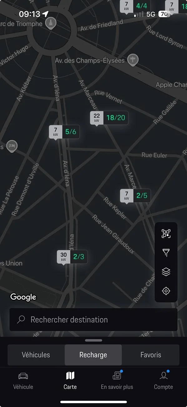

Now this is the same view in MyPorsche app. As you see the 3 charging stations are there (if open one by one, it doesn't say Type 2 compatible but it has the strange "? Others" tag.

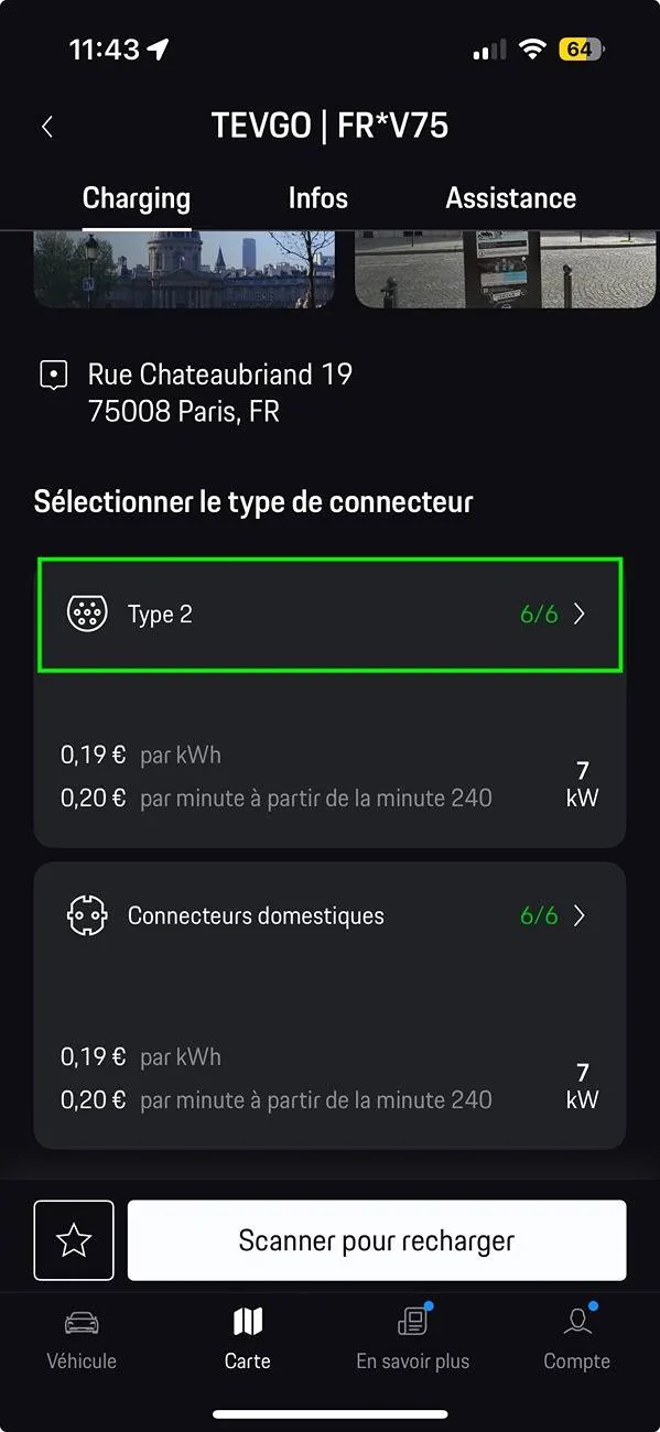

Now the screenshot below is an example of a Charging station that doesn't have the issue and is present in the PCM. I picked one identical: from the same operator, same equipment, same power, same area (only a few hundred meters away from the stations mentioned above). This one is not only present in the PCM but also correctly referenced in MyPorsche app as compatible with Type 2 connector.
So I am seeing a relationship between both problems and I don't see how this issue can only present in my PCM.

Yes it feels like PCM is filtering out those stations even though the filter is cleared (the PCM is set to all charging stations). My theory is that the filter is hard coded to exclude non Type 2 charging stations and since those charging station are not correctly categorized in Porsche DB, they don’t show in the PCM.
However when I asked Porsche support to reproduce the issue they claimed that they are not able to do it which makes my theory invalid. That’s why I am asking for someone to do this simple test and tell me what they see

En effet le lien entre le fait que les stations soient mal catégorisées dans la base de données MyPorsche en tant que « Autre » au lieu de « Type 2 » et le fait que celles-ci n’apparaissent pas dans le PCM est assez flagrant.

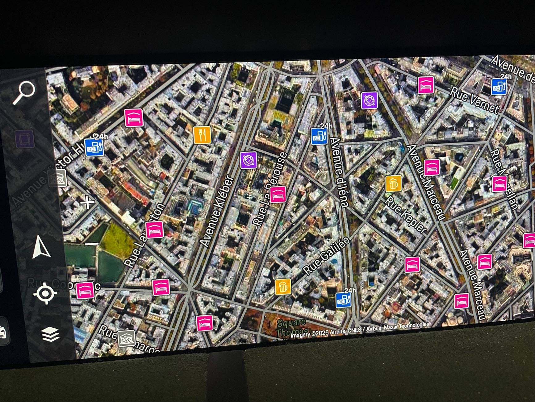

Bonsoir,

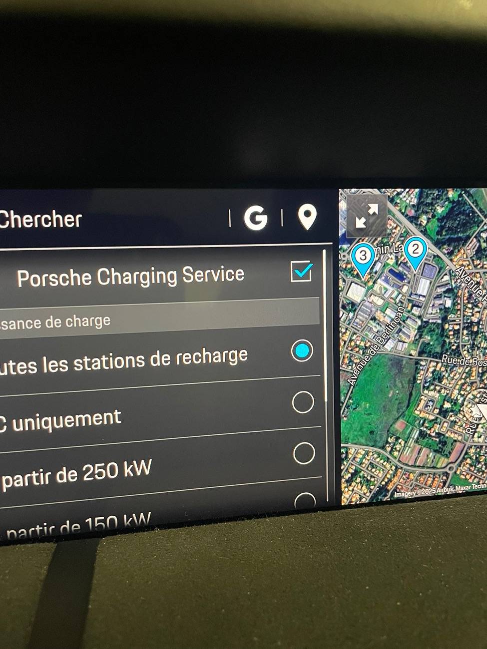

Porsche Taycan PCM bug (J1.1) - Open case with Porsche IMG_4309
Porsche Taycan PCM bug (J1.1) - Open case with Porsche IMG_4310
je suis à bordeaux : je me déplace dans mon PCM sur Paris proche de la place de l’étoile après avoir sélectionné recherche de bornes de charge
J’ai au préalable mis mon filtre sur toutes les stations et je vois bien vos stations à priori recherchées.
Chose bizarre : sur Google Maps elles sont indiquées avec un type de prise inconnu dans au moins un paramètre

Sinon test à faire : sur myPorsche recherchez une des stations et placez la dans favoris
Sur votre PCM vous devriez pouvoir la sélectionner dans vos favoris
Une fois sélectionnée comme destination cherchez la liste des bornes de recharge à proximité de cette destination (via …)
La station devrait apparaître
Filtrage : tous types de Borne
Bonne soirée

Merci d’avoir fait le test.
Intéressant que vous puissiez voir les icônes… mais visiblement vous avez le bug à moitié car vous ne voyez pas la disponibilité des bornes. Dans mon PCM quand les bornes Belib TEVGO 7kw sont affichées, je vois la disponibilité en temps réel.
Sinon j’ai essayé de déconnecter/reconnecter mon compte et rebooter, le problème persiste.
Le filtre est à « toutes le stations de recharge »
J’ai essayé aussi la recherche. J’étais physiquement avec la voiture en train de recharger et j’ai effectué une recherche à proximité. Le PCM n’affiche pas la station dans la liste.
Remarque: pas besoin d’ajouter un emplacement dans les favoris pour une recherche à proximité. Il suffit d’effectuer un appui long directement sur l’emplacement souhaité sur la carte ce qui permet de faire apparaître un menu qui propose la recherche de stations à proximité
Pour info j’ai aussi un MY23. La version du PCM 3882 qui est pour moi la plus récente.
