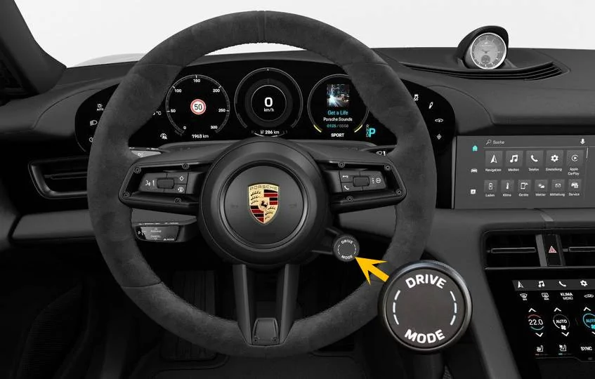

Moving. If you have the Chrono Pack, it's makes it very easy to switch modes.

Correct, can be easily changed on the fly with the Drive Mode knob if you have it optioned.
