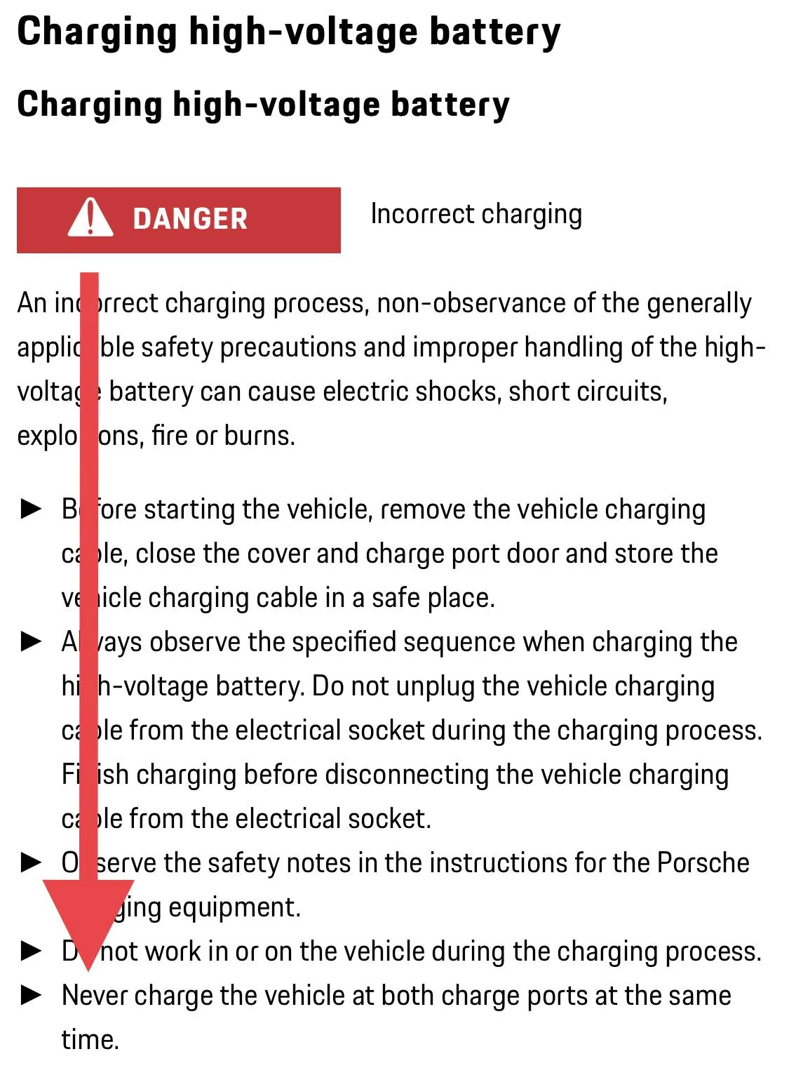

OK. I suspect the answer to this is "of course not, don't be stupid", but what would happen if I plugged J1772 connectors into both side of my Taycan simultaneously:
(1) with both getting just level 1 - i.e. 110v/8amps current level
(2) with both getting level 2 - 240v/30amps current level
Has anyone tried? Does the Taycan just error out?
Thanks, Robert

numerous video reviews have noted that the two doors can’t be simulataneously opened.

no - only one charge port can charge the car at a time - one or the other - not both.

On the non-fancy doors, You’ll hear the other side lock as you open one side. And you’ll hear the other side unlock as you close it again.
