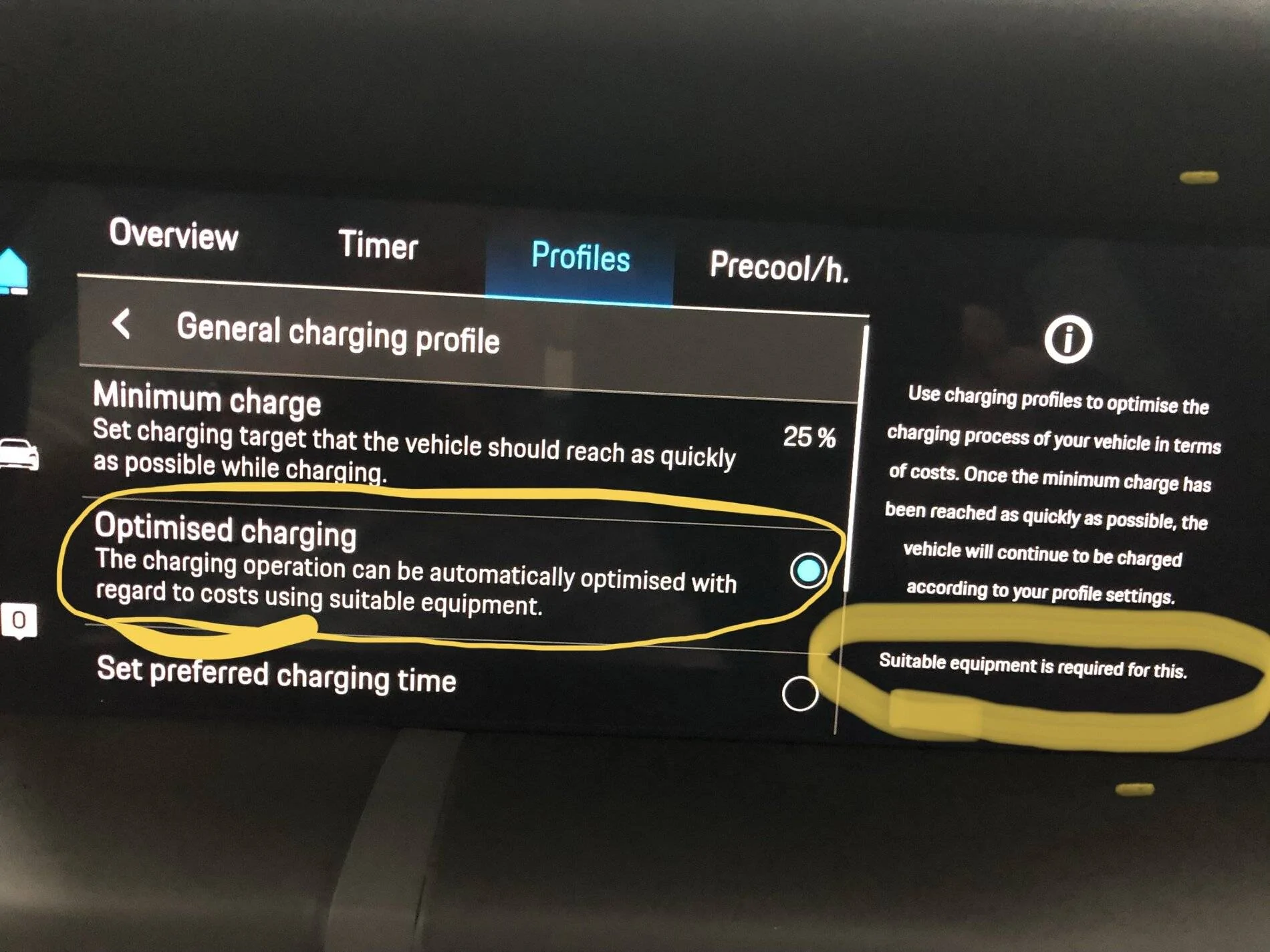

I find it interesting that such basic and important thing like Charge settings for the Taycan, can be so confusing for all. Just look at the number of posts about this! Amazing!
I agree with you and @louv on how Porsche meant this to work. But the instructions are encrypted.
They have made it too complicated in my view and tried to make more of it than needed. If you use the profile charging, see photo, please also note the marked sentence. It will charge to a minimum charge level as set 25% to I think 100%. If you set it to minimum 25% it will charge to that level and stop.
Porsche Taycan My charging not starting at the programmed time 5F59914B-2463-4FC3-AD1B-B8F068BCC7D2
It says it needs to have suitable equipment for optimised charging, which I think is the Porsche Home Energy manager. In the HEM you can programme different costs per day and night time or set limits of what your connection can supply to the house. If you have solar it can also optimise to do charging with solar when sufficient supply is available. But the HEM is an extra equipment.
Now if you do not have this extra equipment installed I do not know what would trigger a charge to start again after the minimum has been reached? Maybe it will just stop there and not charge any more?
so if @Singularity sets it to charge to 85% and there is no extra suitable equipment, it may well stop at 85% and objective achieved. I can not understand what else could trigger a restart.
If on the other hand you have this magical suitable equipment and set it for optimised charging, I can not find to what level it would then be charged? Is optimal 85% as per the Good to Know app? Or will it charge to 100% as some have reported?
