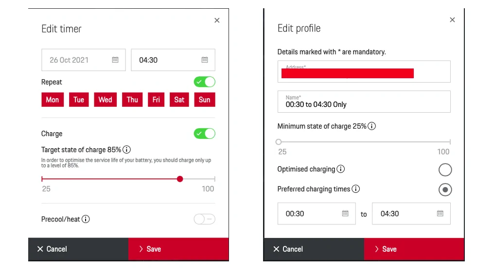

I use a Timer and a Profile to take advantage of the cheaper overnight tariff and it works every time for me.
Porsche Taycan Car starting charging before the preferred charge time 1635149266633
I have noticed that as the nights are getting colder it only manages to reach 84%, but I understand this is caused by the drop in temperature and nothing to do with the software.
If I am planning a trip I also include an additional timer for pre-heating prior to departure.
