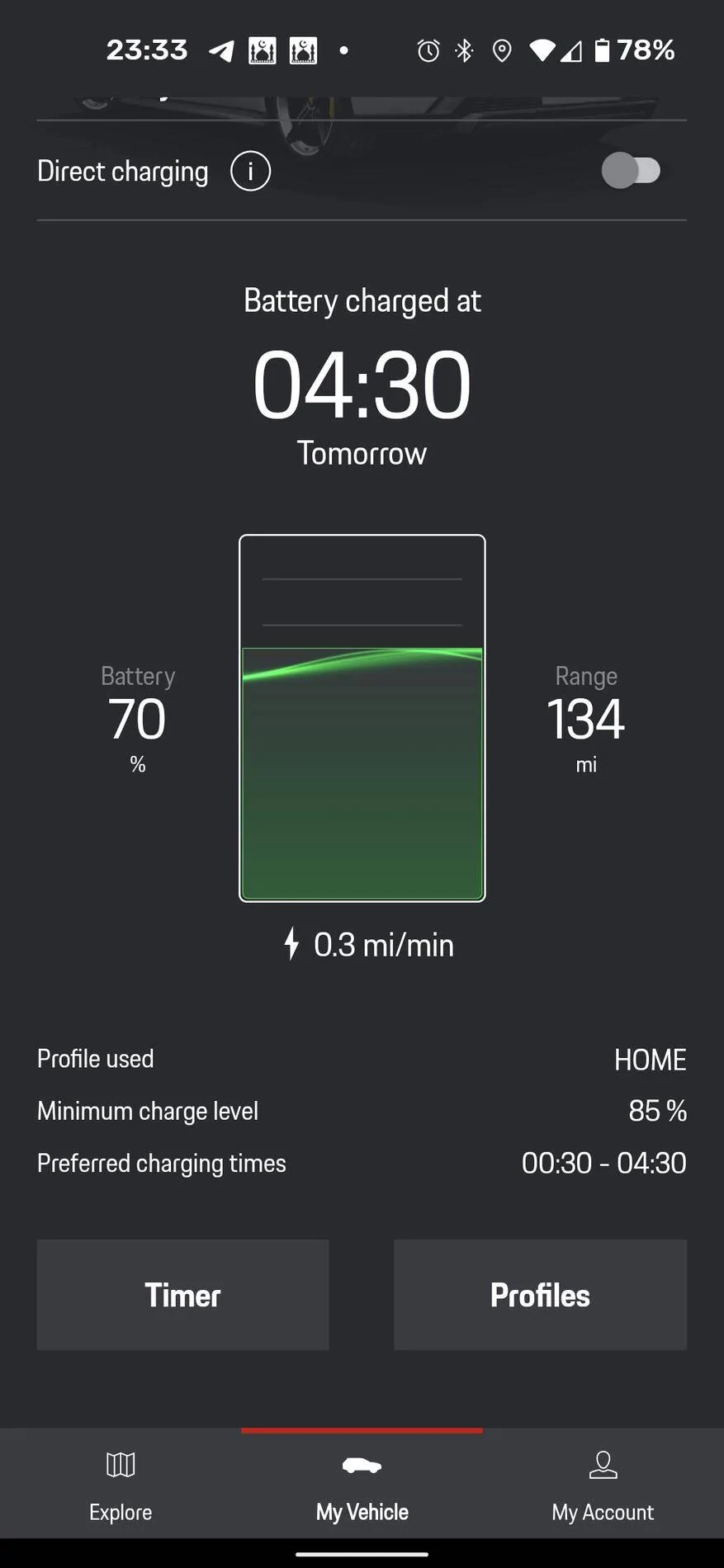

This has probably been asked a few times before. Just wondering why my car is charging outside the selected profile.
I have set a profile up with location settings and preferred charging times between 00.30 and 04.30. However the car is charging even before this.
What am I doing wrong?
Porsche Taycan Preferred charging working outside set hours Screenshot_20210418-233301

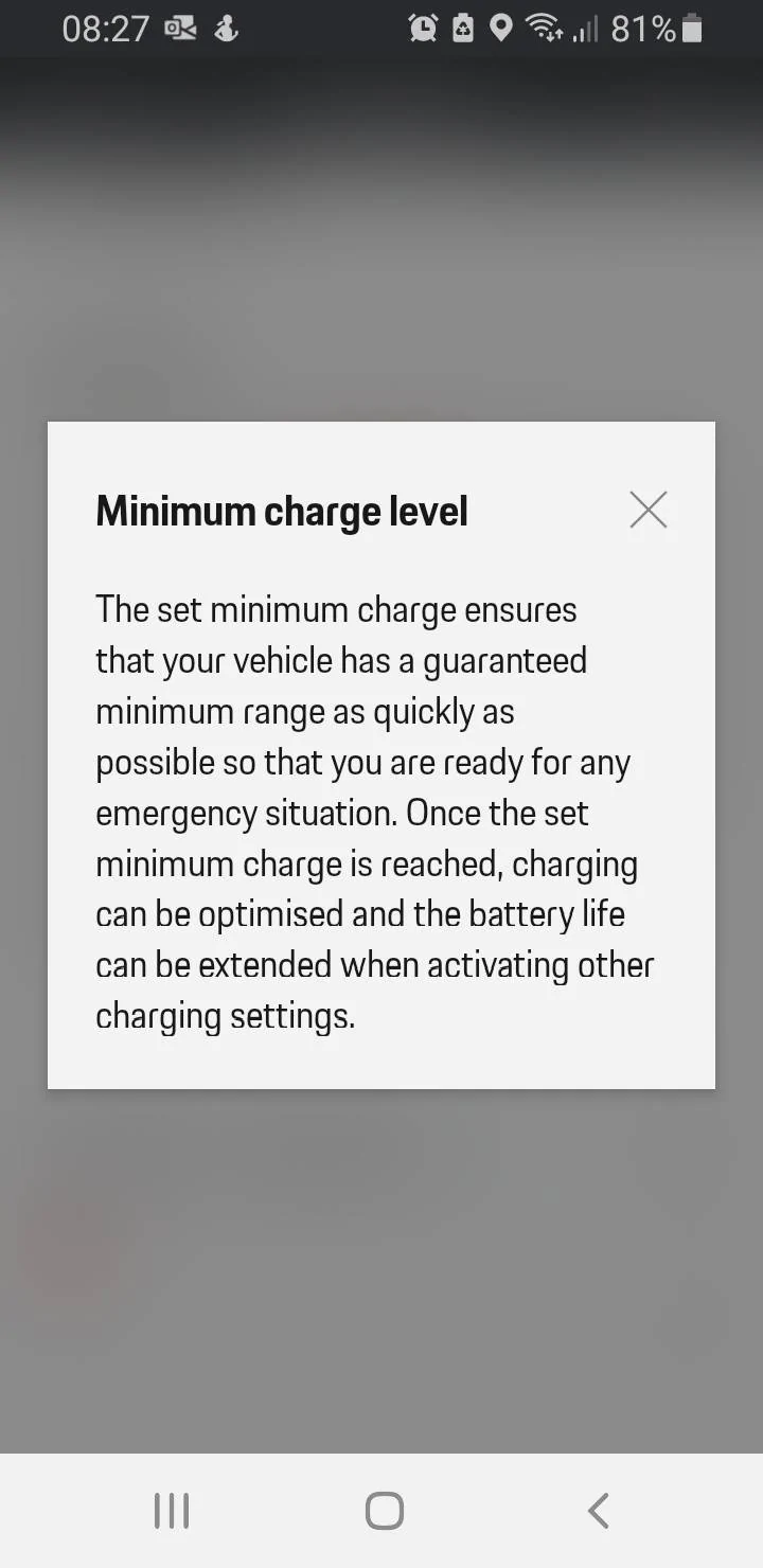

The app itself also explains this (info icon beside minimum charge) shown below:
Porsche Taycan Preferred charging working outside set hours Screenshot_20210419-082744_Connect

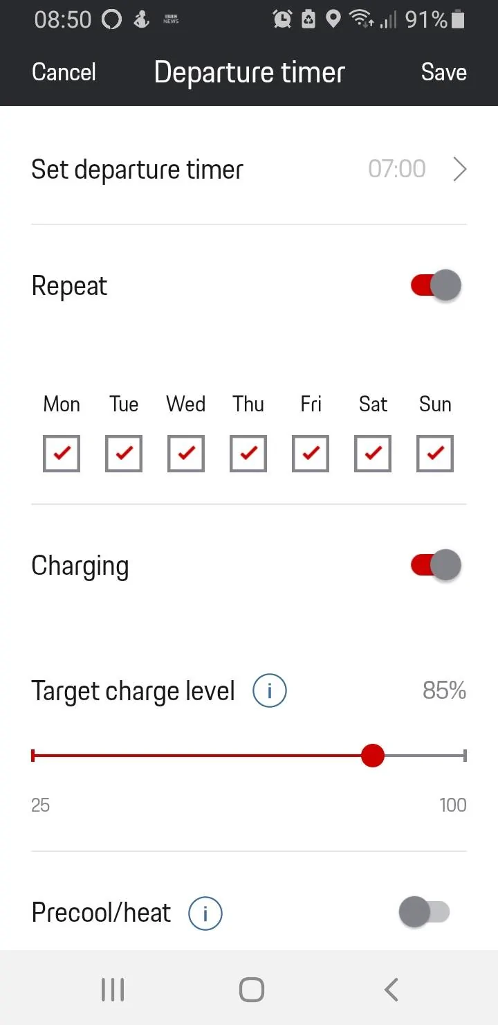

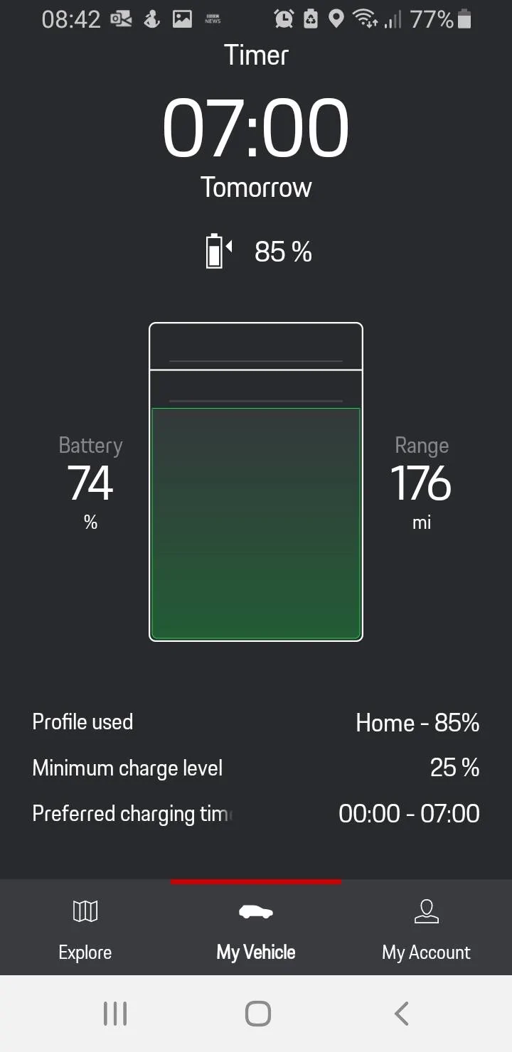

I use these timer settings for a daily 85% charge and a profile which has a minimum charge of 25%. Car will only start charging immediately if it has <25% charge when I plug it in and will pause when it reaches 25% waiting for the timer window (my off peak) to charge to 85%.
Porsche Taycan Preferred charging working outside set hours Screenshot_20210416-085035_Connect
Porsche Taycan Preferred charging working outside set hours Screenshot_20210419-084251_Connect
