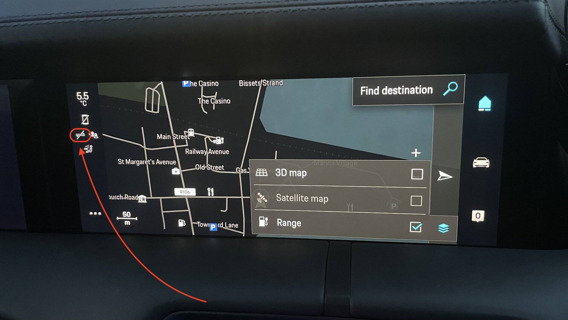

No matter what I do, I can't get my car's data connection to connect. I have tried:
  • Engineering reboot
  • Locking car and walking away (key out of range) for 20 mins, one hour and overnight
I am in an area with a strong cell signal from the network that Porsche use locally. When I open the "Integrated SIM" status screen I see no signal an no network (usually Vodafone) mentioned.
I've ping my Porsche Centre to see if they can investigate but wondering if there is anything I should try in the meantime. I'm not happy because this is impacting the Porsche Vehicle Tracking Service (PVTS+) which is a condition of my insurance.
Is this potentially a OTA module that has gone bad? This has happened previously to me, but usually it "fixed itself" overnight. Not this time though.
Porsche Taycan Can't get data connection to work IMG_0043

I had the same, no LTE in front of the house despite the cell tower close to home. So called PC and made an appointment. A few days later I took it for a short drive and the LTE was back.

Same with me. Couple of days no connection( no LTE.) Tried to delete my mobile phone and to reconnect.. I could not reconnect the phone as PCM did not respond.
I was already planning to visit Porsche again as suddenly everything was back and worked again. Sometging locked and released itself a couple of days later I think.

And its back. FFS.
Will be impossible to get this fixed if its not happening when I am at Porsche Centre.

I tried everything under the sun including subscribing to the the Verizon WiFi as some have suggested. Nothing worked. I took it in and they opened a ticket and worked with Porsche NA. They apparently did some thing on the back end and it now works. What an ordeal. To finish on a positive, I am otherwise loving my MY 2022 CT.

I just called, they are going to change my OTA
