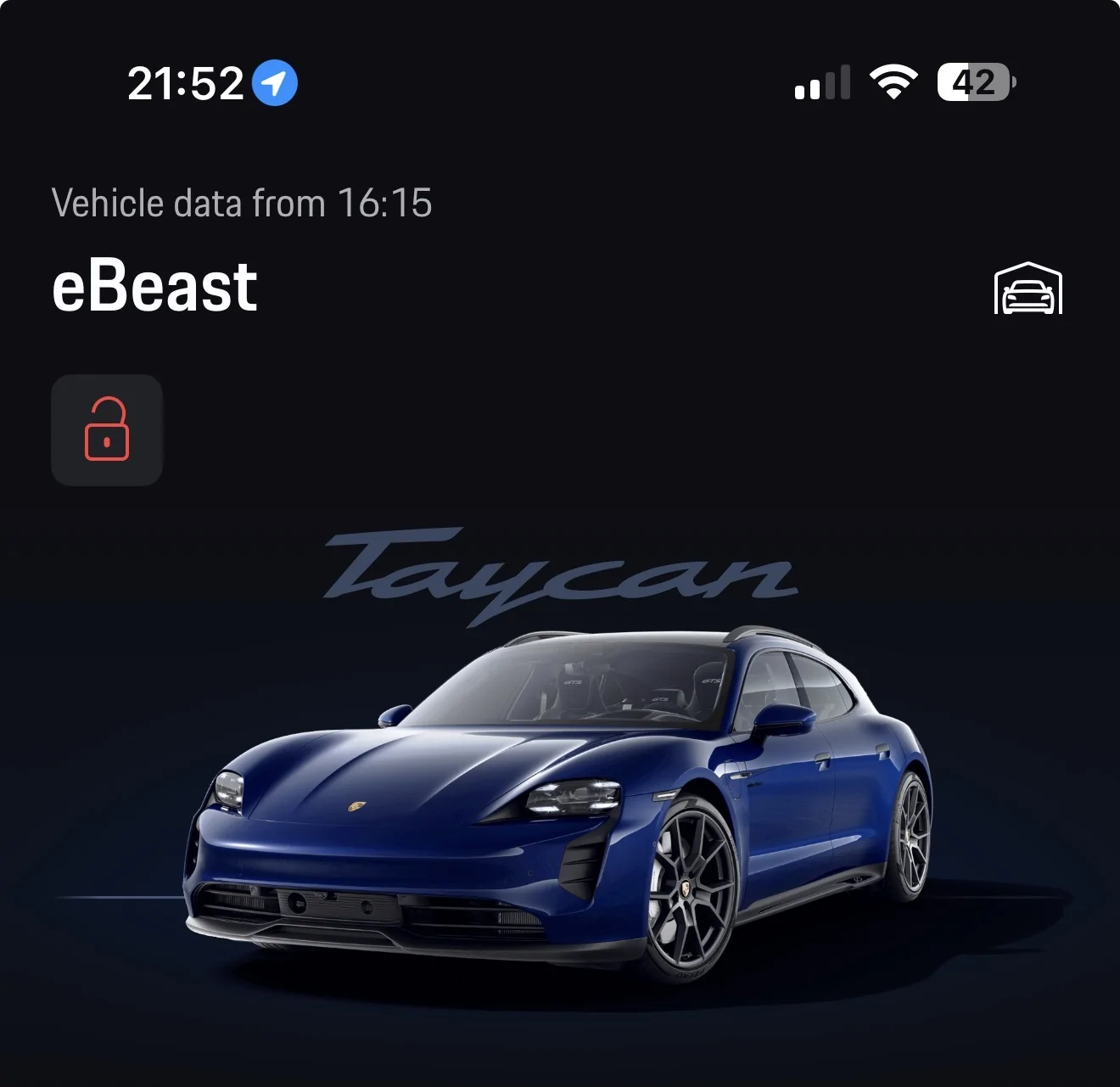

Mine is in the dealer for a major leak issue (boot half full of water and a soaked wiring loom). I had a load of faults while driving (presumably related to this water) and I’d lost data connection since then. I’ve noticed that while it’s been in the dealer the Porsche app is updating really infequently:
Porsche Taycan Data Connection lost IMG_4264
maybe this is not the car but a wider issue?
