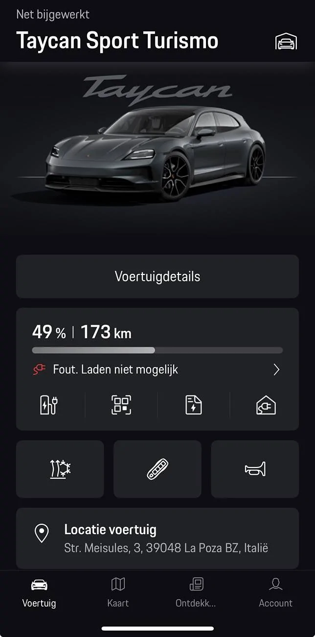

After experiencing this issue last month and having it resolved a week later, the problem has reappeared this week. The app can no longer access the car. It seems that the connection from the Taycan to the central Porsche servers is offline again, as I don’t have any data connection (in the car) or whatsoever.
I am still logged in and do not plan to log out to avoid having to drive in guest mode for a week. Think its just a matter of waiting to see when Porsche fixes the issue again.

In the car’s PCM, does it have LTE showing, or a symbol with 2 opposing arrows (looks like a struck-through = sign). ?
Indeed the car has full LTE and also wifi connectivity (at home). As PCM apps like spotify and internet radio run via the Porsche central services, these are also not working.

I have had the same connectivity issue twice this week. I was monitoring charging at home and twice the app shows no progress on charging despite saying the data was just updated. When I go to the car the charging is active or has been completed. I deleted the app and logged back in and that seemed to resolve the problem, but it later recurred. I suspect this is related to app updates and bugs in the software.
Don’t think it’s an app issue. Did a reinstall twice, but didn’t solve the problem. App doesn’t get update, it still thinks that I’m enjoying my skiing trip in Italy ?
