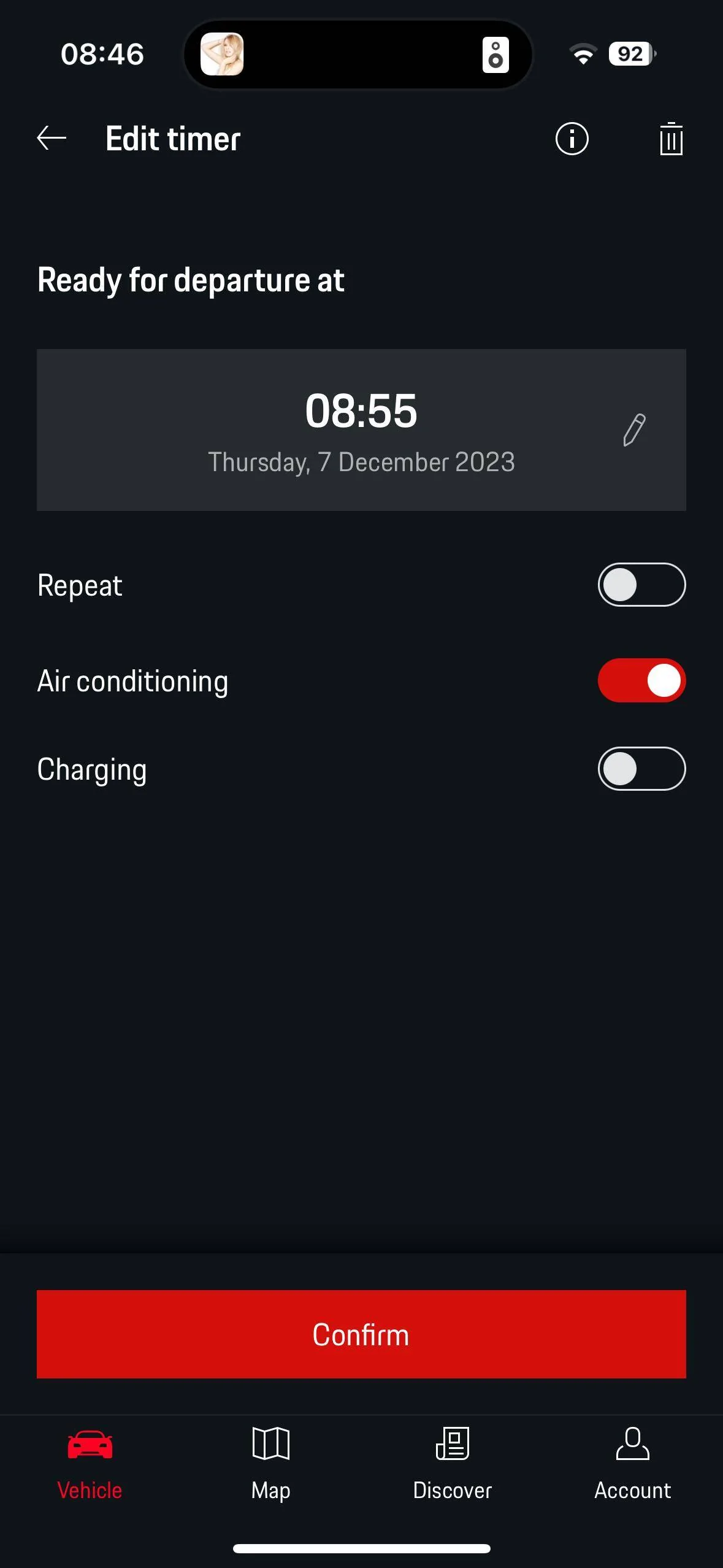

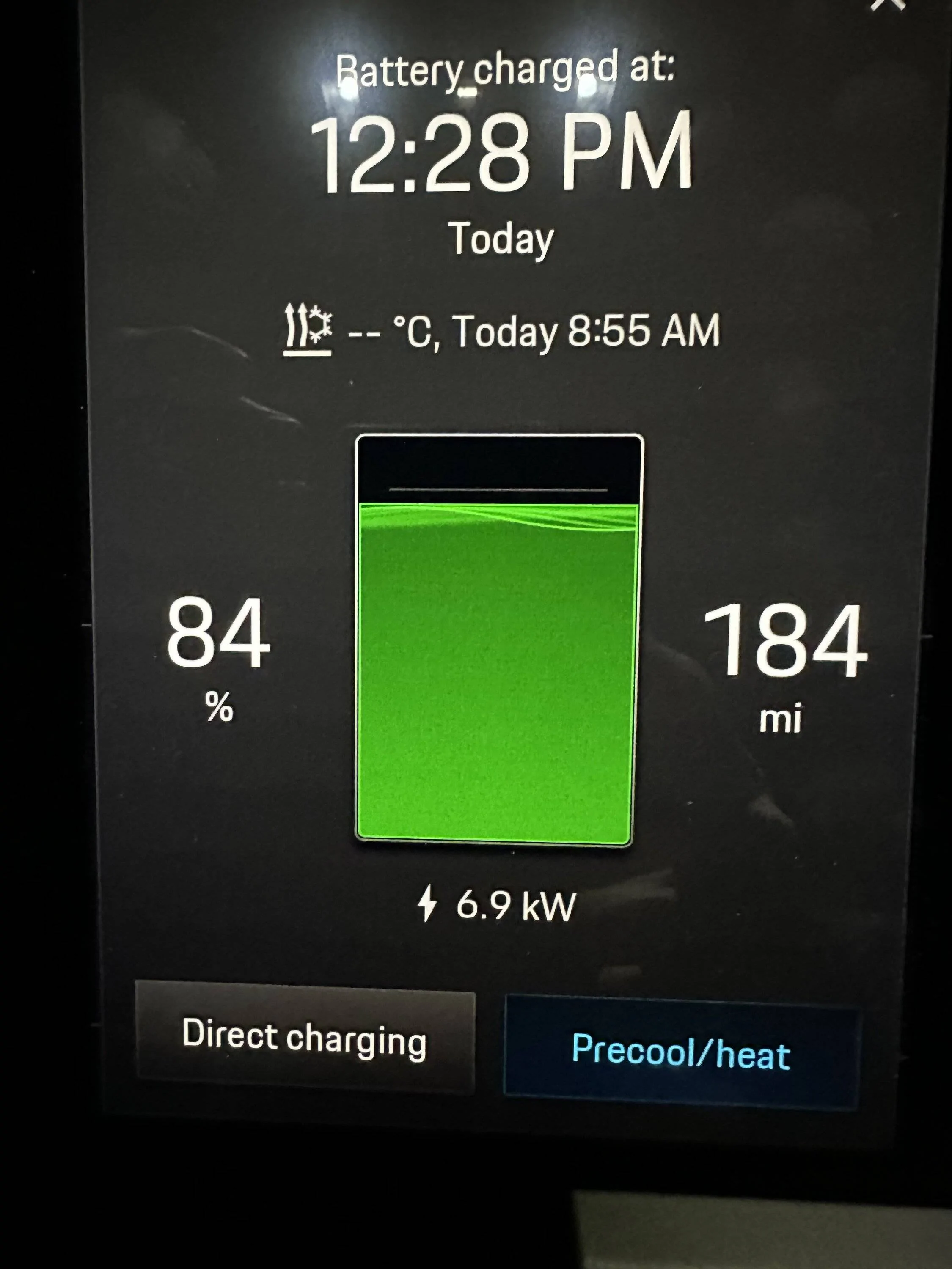

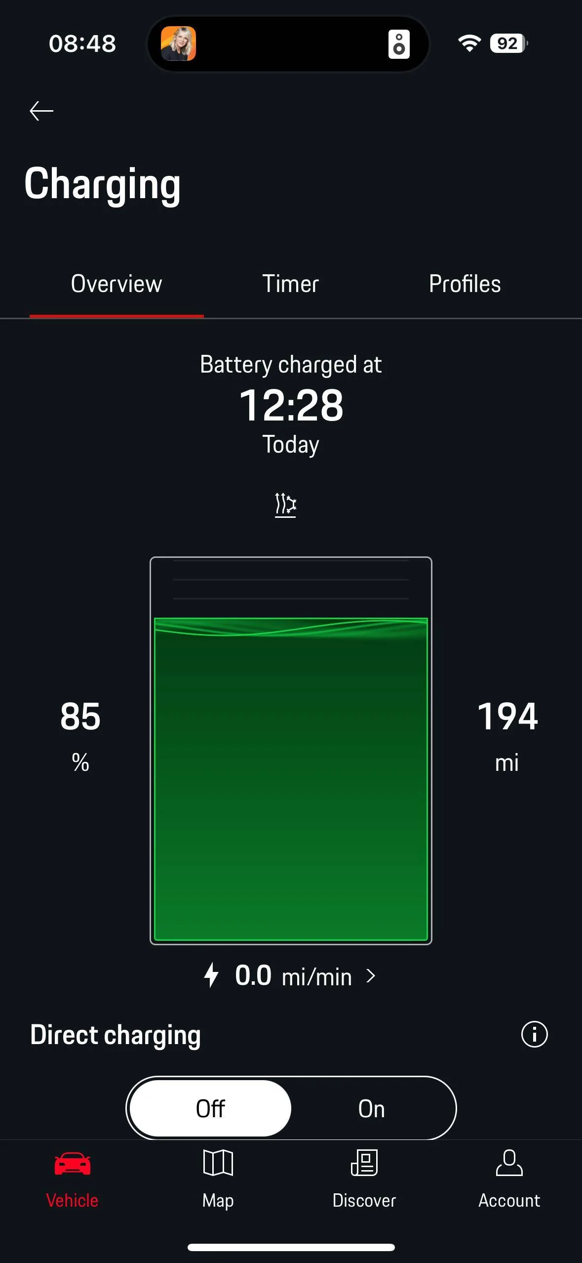

There seems to be a consistent bug when setting timers to heat the car with the charging option disabled - it still charges. This has happened a few times and thinking it was user error I took screenshots to confirm. The first image shows what I configured in the app, the second shows what the app thought was happening (curiously showing it was adding 0 miles per minute to reach full charge at 12:28!) and the last image shows the display in the car (charging at 6.9kW to reach full charge at 12:28). The last image was taken just after the screenshot on my mobile, so it’s strange that the SoC went from 85% to 84%.
Starting the heating directly from the app rather than using a timer doesn’t initiate charging.
Anyone else experienced this?

You might need an active Profile (set to 'Optimised charging' - not 'prefered charging window') with a minimum SoC below your current SoC - without an active profile I believe it will charge to 100%.

Ah thanks, checking that I see that the general profile is disabled - I think that may have happened in messing about (unsuccessfully) trying to get Intelligent Octopus to work properly …
My general profile has a minimum charge of 25%, but I do have a preferred charging period which I think I need to keep for the cheap overnight electricity. Anyway, I’ll enable this profile and let you know ?

… and that seems to have fixed it, thanks again!
I don’t really follow why it was charging the car when the charging option on the timer was disabled, but hey - it works ?
