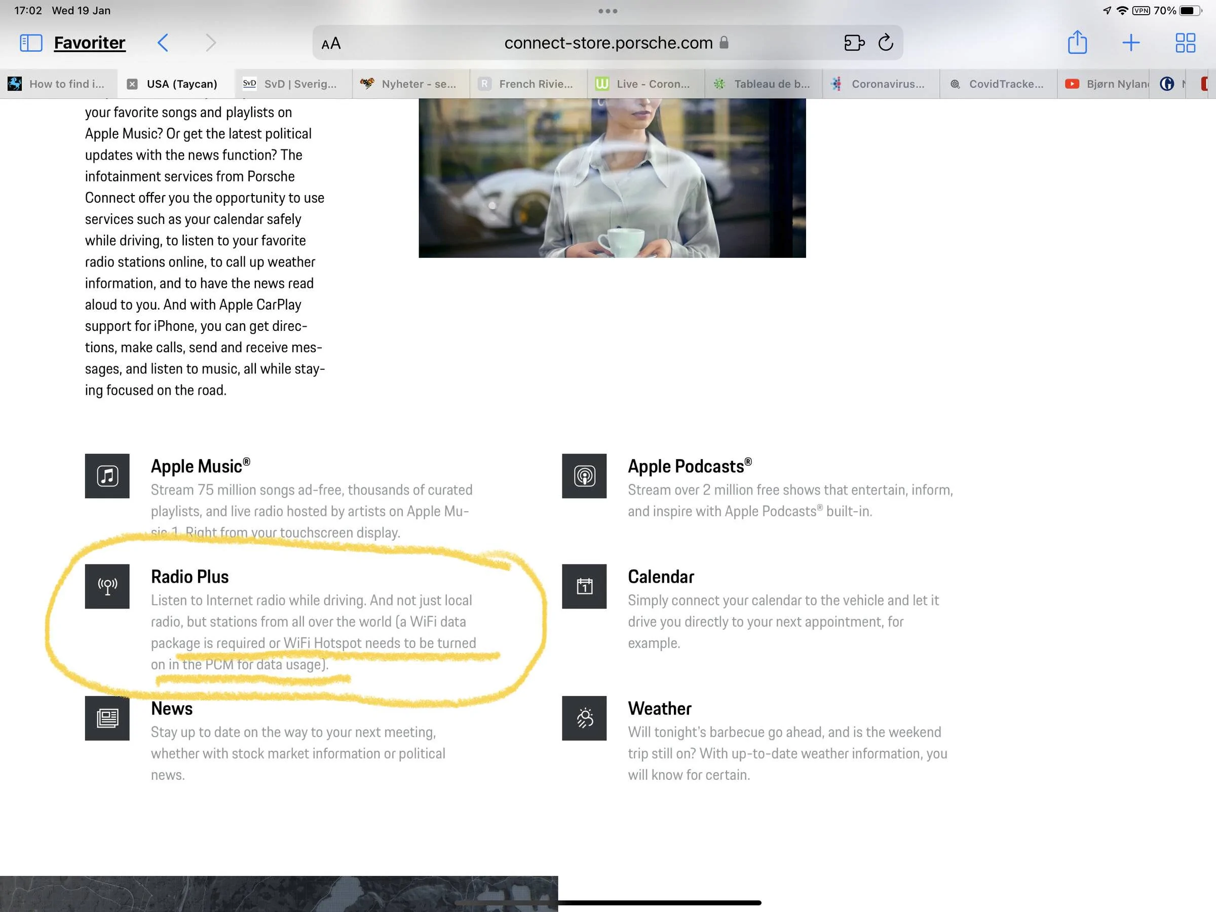

Verizon is becoming a common thread for some of these spurious issues.
Yesterday there was a query from a US based forum member on Apple Music login not being available (for quite a while along with internet radio etc) and a little confusion on whether the optional Porsche Connect Service - Verizon Data Package was needed for this purpose.
The general answer is 'no', you don't need this as a pre-requisite for any region.
However, the forum member decided to subscribe to the data package (monthly renewable) and literally within minutes of activation all of his woes went away - Apple Music worked fine as did other data dependent features.
Another member decided to do same and has cancelled their subscription to see what happens at renewal and whether they loose the Apple (and other) services - our guess is that they won't.
Bit of a stretch but whilst there is no pre-requisite (or has not been to this point) to have the Verizon package it could be that there is a blocker somewhere on the LTE standard service which Verizon (if that's the carrier) doesn't support. Essentially 'fooling' the PCM / LTE into activating the service.
The other oddity that surfaced is that on the US Porsche Connect Services page the Verizon package is listed a necessary for the Internet Radio service (previously it wasn't).
Could be adding two + two and getting four here but potentially worth a shot to activate and then immediately cancel.
I should add that all of these services work fine in UK (we don't have Verizon) via Vodafone (I think) and no subscription required.

… the Verizon package is listed a necessary for the Internet Radio service (previously it wasn't)
What is the Taycan internet radio service? Does this refer to Apple Music?
11,022
6,808
Separate to Apple Music. Go to your Connect Store and see what you already have and what you could add - explore the website as there is some useful info (like this) posted there.
Radio Plus (I referred to as internet radio).
