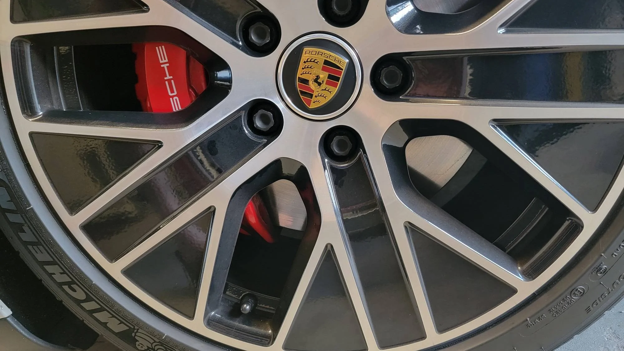

Pretty mild, as far as a mod or customization but I figured I'd post this all the same. Santa read my letter and decided I was pretty good this year, so he brought me some new wheel caps with the full color Porsche crest. I put them on tonight with minimal effort (gotta love assorted plastic trim tools) and am loving the new look, as it adds some extra color to the otherwise fairly monochrome side profile.
Yes, I aligned them, I'm not an animal after all ?

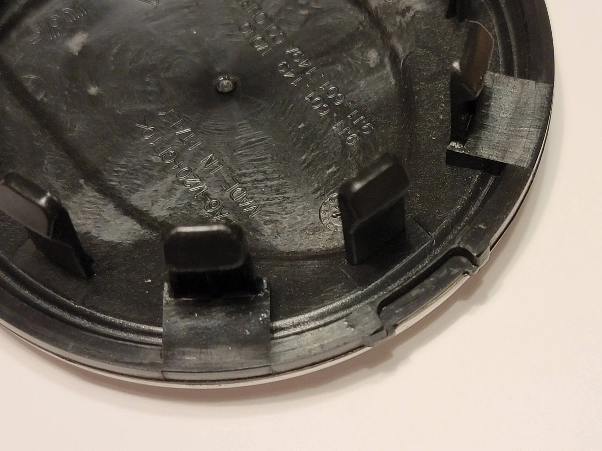

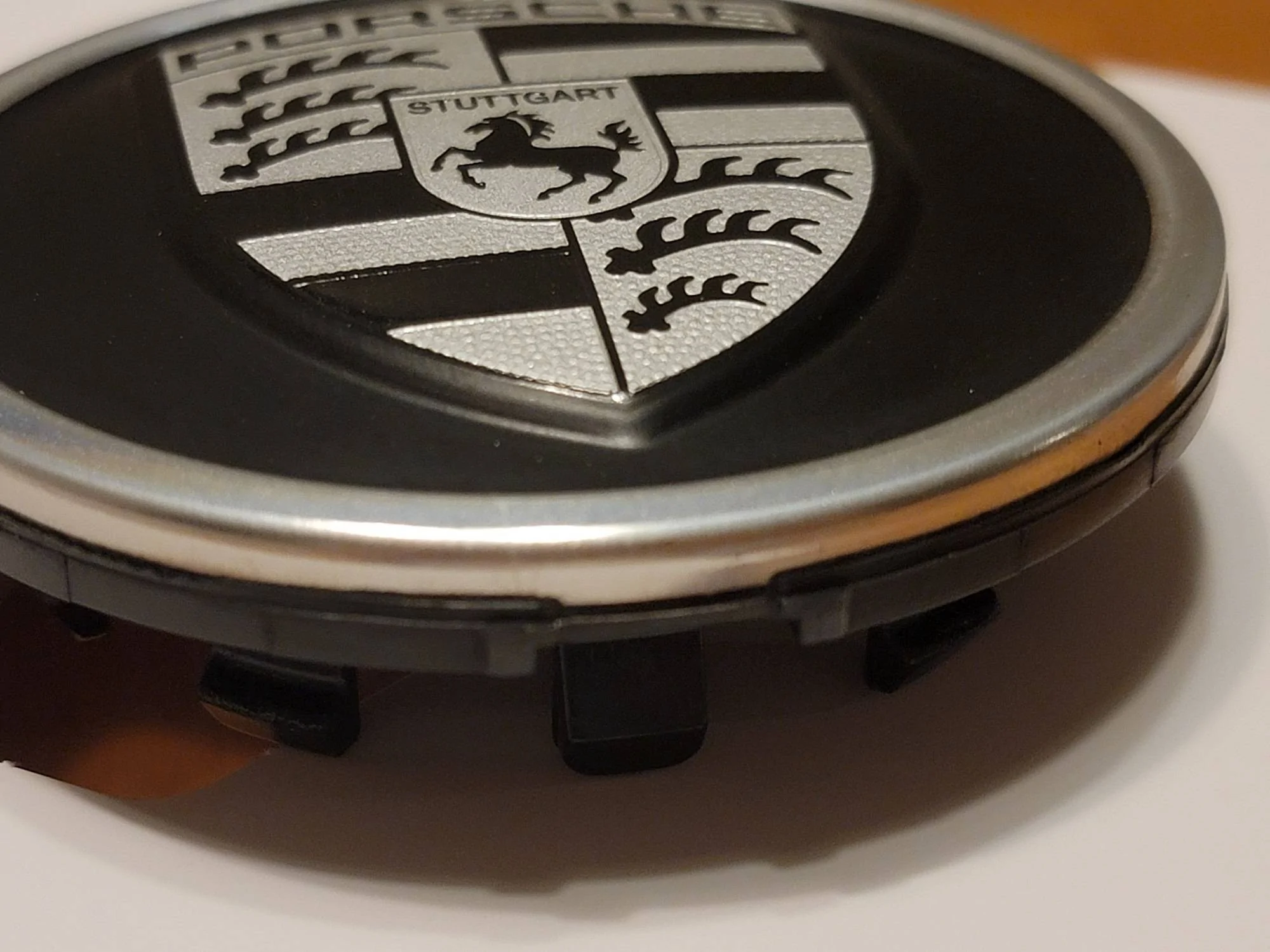

There is a slight indentation along the edge below the crest point and that's where I pried. Plastic trim removal tools and patience got all four originals off from the front without any issues or damage.
Pics of the originals
Porsche Taycan Changed out my wheel caps Center cap to
Porsche Taycan Changed out my wheel caps Center cap bottom
Looks great - it’s strong that the emblems on the car match. I thought about doing the same with mine but thought the wheels needed to be pulled. What tools did you use to remove the caps ?
Just simple plastic trim removal tools I bought off Amazon a few years back plus a towel on the ground just in case. It took me about 20 minutes at most.

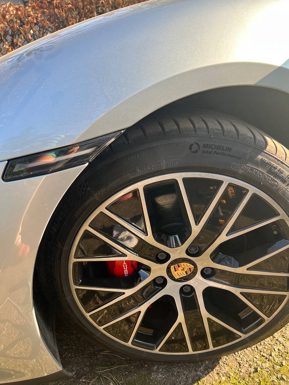

Did the same the other day on mine. Removal is easy. There should be a couple of small holes in the black part of the crest. Just pop the end of an allen key through and pull it out. Mine were missing the holes so I just drilled a small one in the place they should be and popped them off.
Porsche Taycan Changed out my wheel caps IMG_2357
