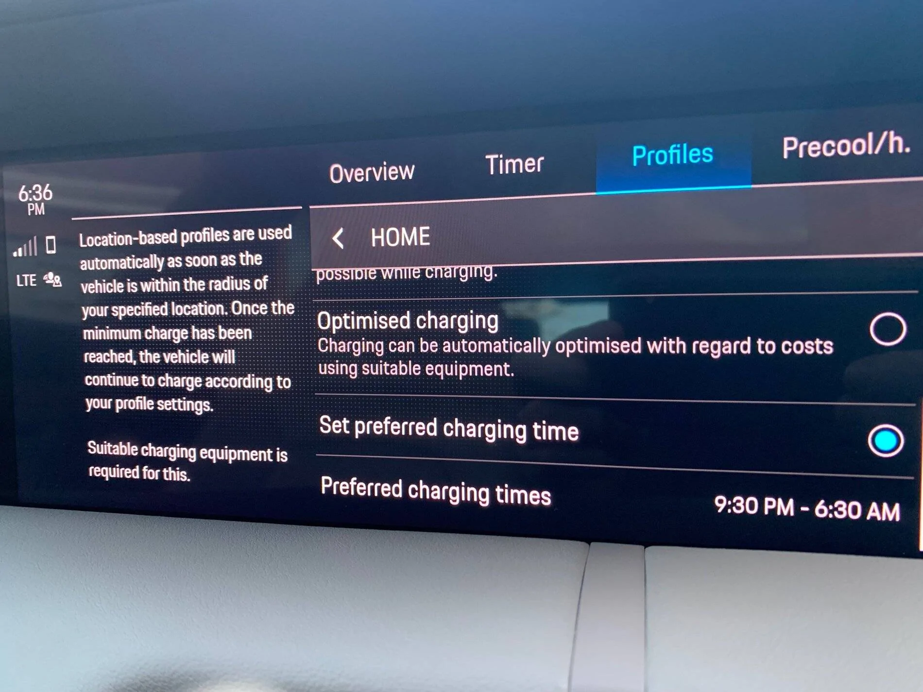

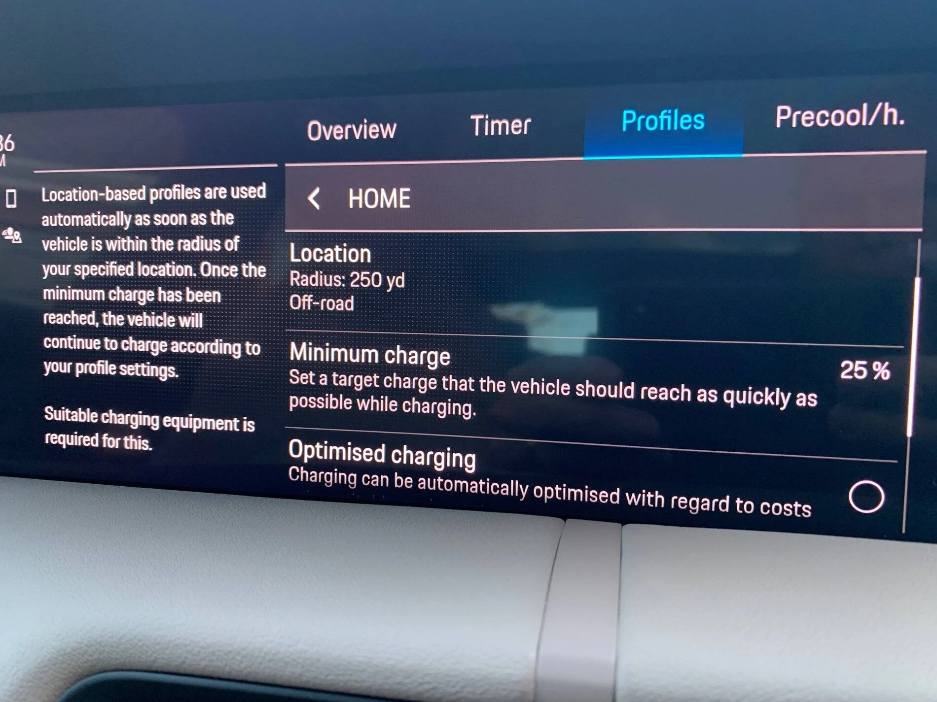

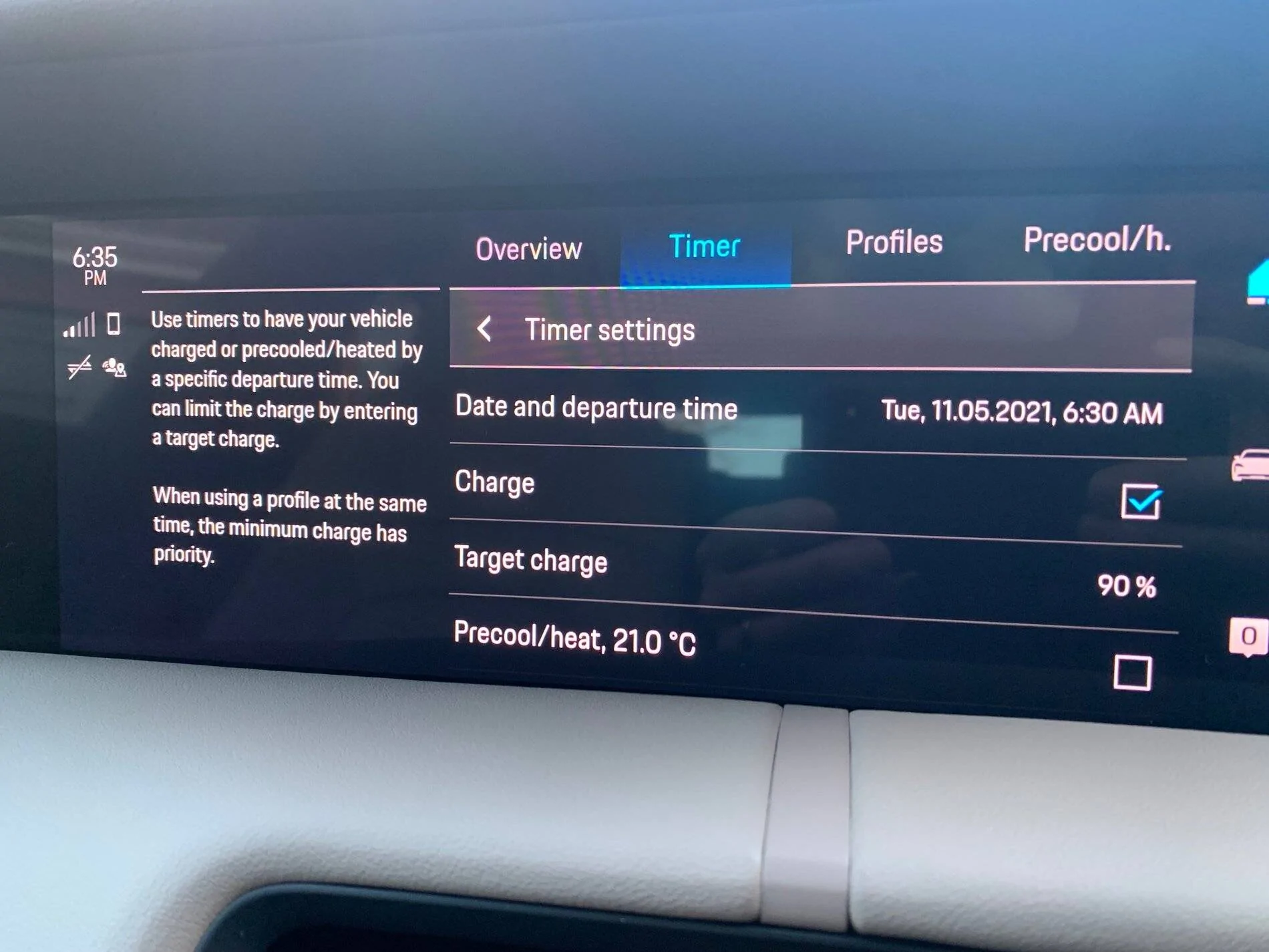

Here is what I have setup if it helps.
I don't use any of the PodPoint scheduling - nothing is setup on the charger/podpoint app.
I have a HOME location based profile minimum charge set to 50% i.e. I always want to have some decent immediate charge in the bank if I do come home with less than 50% but that is configurable down to 25%. I have set preferred charging times as 12:30AM - 4:30AM.
I then have a Timer set daily with departure time set for 4:30AM and Target Charge of 85% - I currently don't use any pre-heat settings.
That's it, works fine and gets me my Octopus Go cheap 12:30 - 04:30 rate and starts and finishes exactly on time with a 85% charge.

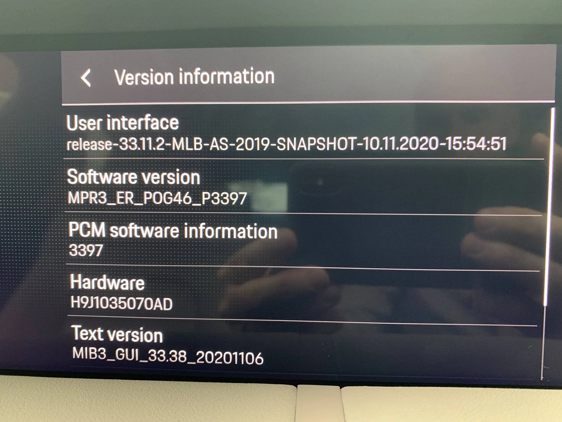

In regard to software version have attached a screenshot with what is shown. Would appreciate your comments as it doesn’t seem to show the version you referred to.
Sorry crossed wires.
Have you had you car in for the major software upgrade (you would have received a letter from Porsche)? If you have then don't worry about it.
Good that you have your Podpoint sorted.
PMCC software version number is also something to check.
You need to login to you PMCC charger - it needs to be connected to your WiFi or if you enable the hotspot you can connect directly to it.
You would have received a white envelope with password details.
The PMCC has its own web interface - Porsche Mobile Charger Web Connect - which has various features etc. and auto updates it's software when online.
Once you have it installed and connected you can also view the charging data that it collects via My Porsche - Charging at Home Service.
Access is also available using the PMCC screen. Interim you can power up via the 3 pin plug and run through the network setup etc.

My summary of tests so far:
* DC charging disables all profiles
* Location based profile overrides General Profile (i.e., will charge beyond 85%)
* Location based profile: charging will happen during those times, but "backwards", so not starting immediately but filling the charge time from the end time
* timers also charge backwards, but seem to consider preferred charging time of location based profile, i.e, use that first and that back loaded charging
So, I now get what I want with 3 profiles and 2 timers. More complicated than it needs to be but ok.
