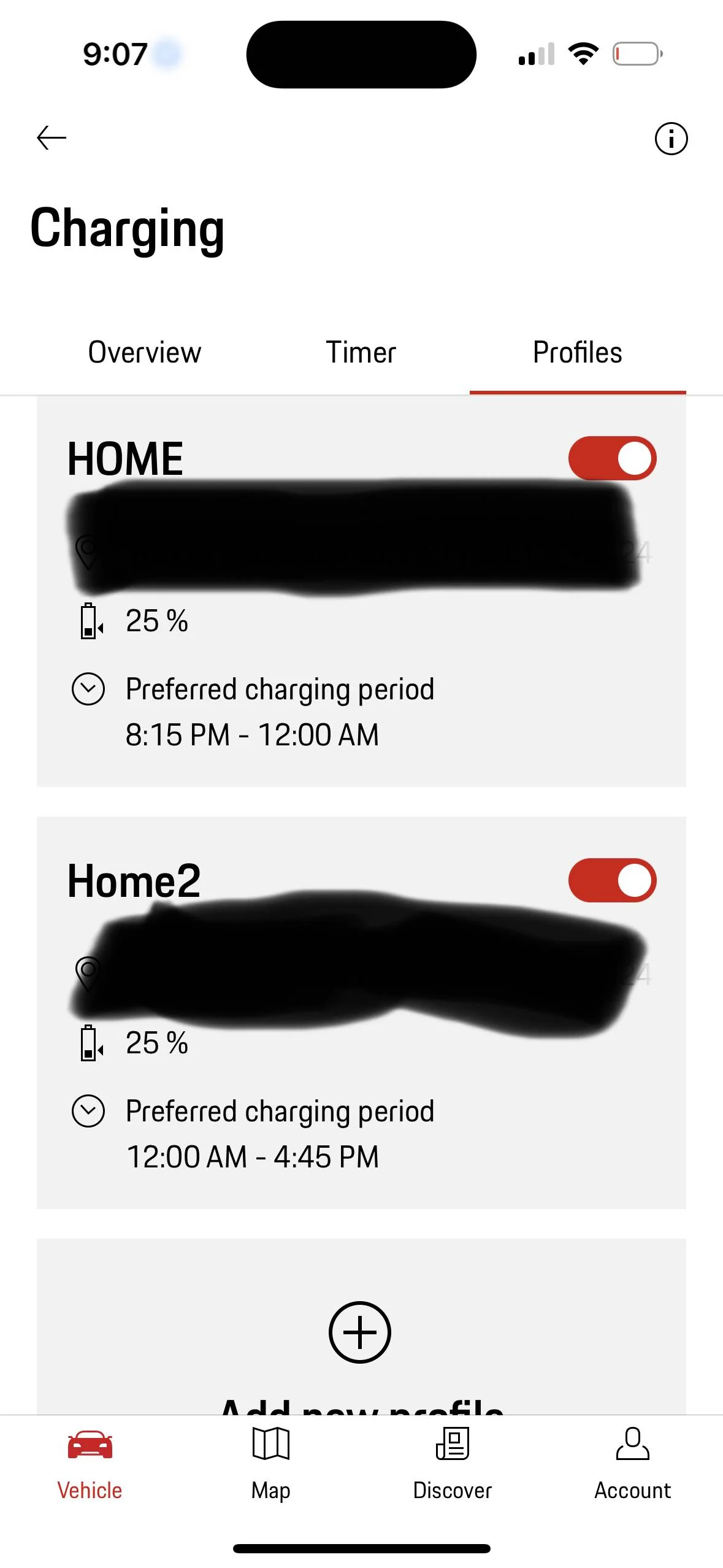

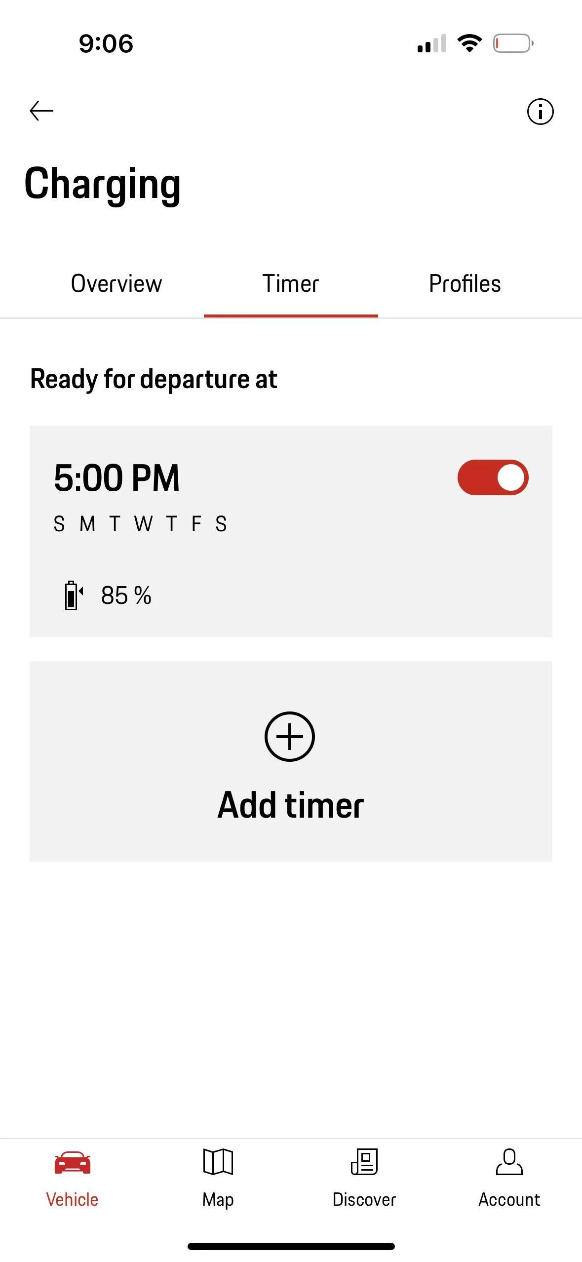

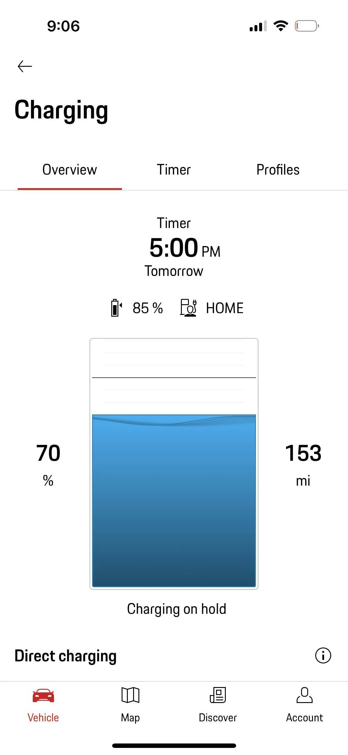

Still isn’t working as intended. Can you confirm that my settings are as suggested? If so, why isn’t it charging as soon as I’m plugged in?
Porsche Taycan General profile v timer 2E959E8B-3480-412C-B4E7-F6EE909E4B0A
Porsche Taycan General profile v timer 15C8AC02-07C6-487D-B124-6C7076D895A7
Plugged in at 8pm and was hoping it would start charging right at 815pm. Based on the details below it looks like the car won’t charge until around 3pm to get 85% at 5pm

It seems to be working correctly? You’re at 70% currently (over the profile’s min of 25), and there’s loads of time to reach 85 by your designated -departure- time.
A timer is a countdown clock (“ready by this time”). Also, try searching - lots of threads on this topic.
1. Assuming your battery SOC at the start of the charging session was as indicated (70%) then you should not expect charging to occur straight-away as you already have 45% more charge than the minimum you have selected.
2. Charging should start some time prior to 5:00pm - only 15% charge to add to the battery and so the car calculates backwards from your target departure time.
3. Not clear if your car charged to 85% by 5:00pm - did it?

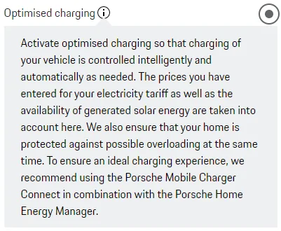

I've been using Timers and Profiles for 2.5 yrs on 2 separate Taycans and understand 100% how this works.
There is a clear explanation of what Optimised Charging means (your SA could benefit from reading it). It is intended to be used with mixed power sources and ideally linked to a HEM.

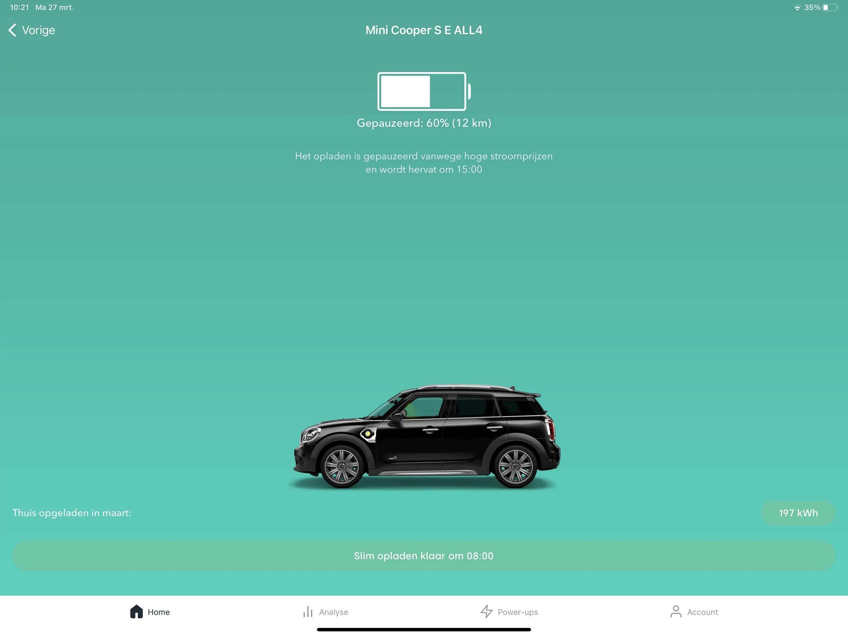

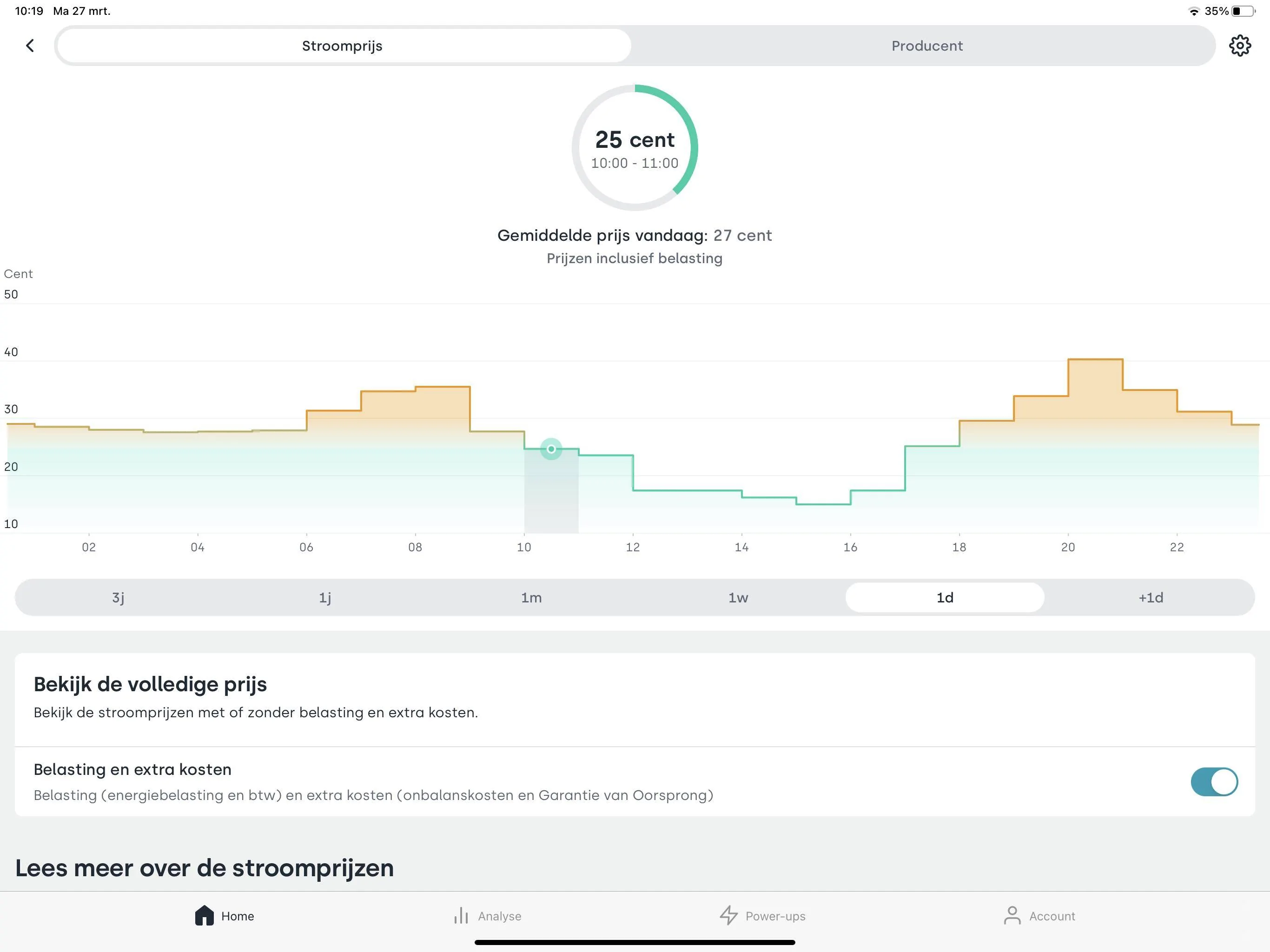

When on variable rate the timer is set by the energy manager via the API, the app timer then conflicts and nothing happens.
example: today I want to charge between 12:00 and 14:00, the timers would need to be set manually on the app, without the app, the energy manager sets the time via the API (note how it sets 15:00 for the Mini? As this is a hybrid and will be full within the hour. It’s that smart!)
screenshot is from Countryman, as currently my wife is charging, but Taycan works exactly the same. The only thing that Porsche should do is to seperate the charge cap from the timers.
so you can just set a max SoC of 85% which then always is a hard stop, unless overridden by direct charging.
