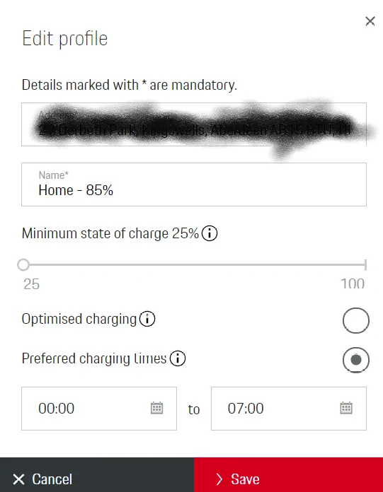

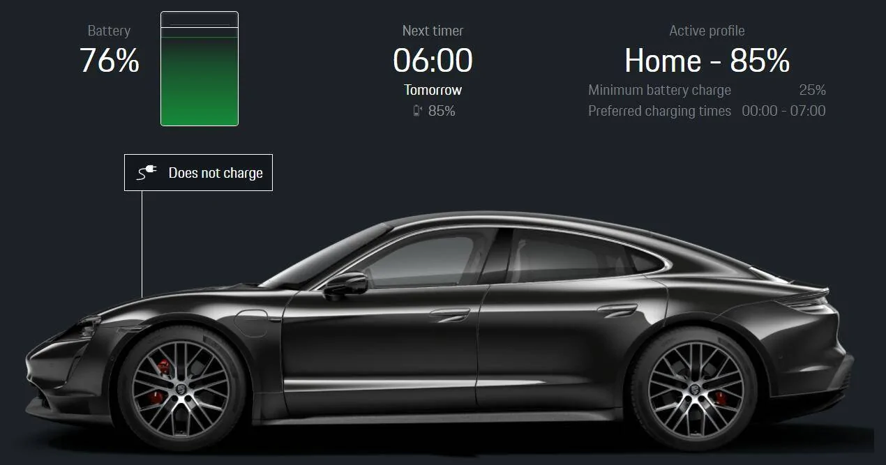

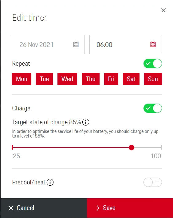

Daily timer I've used for past 12 months
Porsche Taycan Profile/Timer Interaction 1637844276554
Profile
Porsche Taycan Profile/Timer Interaction 1637844480427
Porsche Taycan Profile/Timer Interaction 1637844999946
End result (when EVSE is connected) is a car charged to 85% and ready for use by 07:00 (not 06:00 as per the Timer) and takes into account my low cost electric between 00:00 and 07:00.
The one thing I can't demonstrate to prove the point further is the data from my PMCC as the time-offset is 6 - 7 hours adrift (a software bug) regardless that it is set to the correct time zone and takes the time from the car as it's time sync source. The period of charge is however within the above preferred charging time window.
