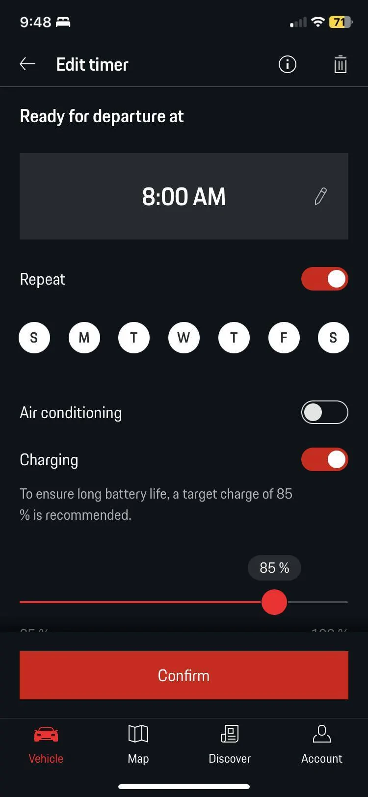

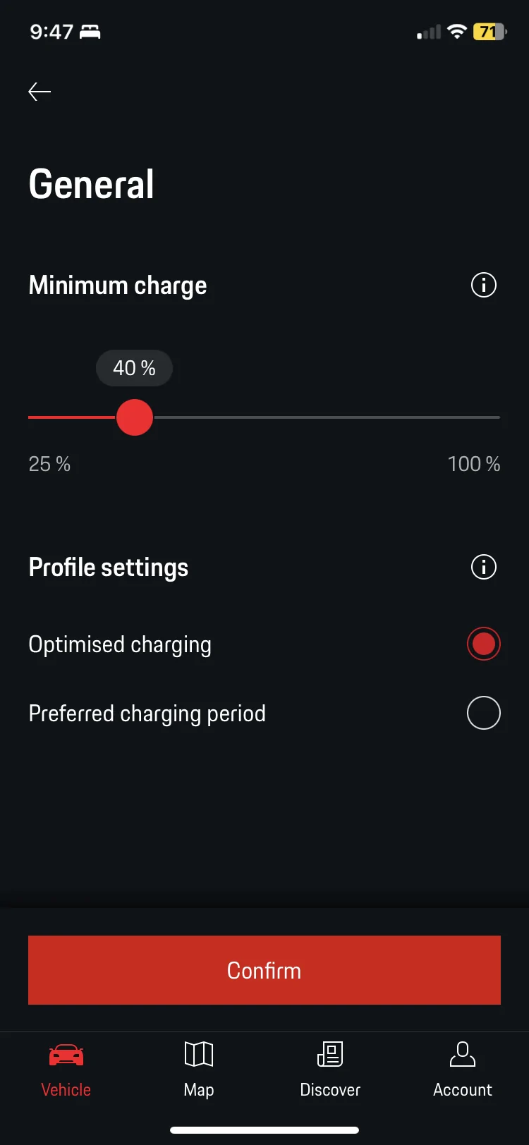

I have no idea what the issue is with your setup. My profile is set to 40% and my timer is set to hit 85% at 8AM daily. My charge rate is about 9kW (no idea what that translates to in miles per minute). I wish I could provide better info than letting you know that it works fine for me.
Tap the charge rate on the display and it will switch to miles / kWh.

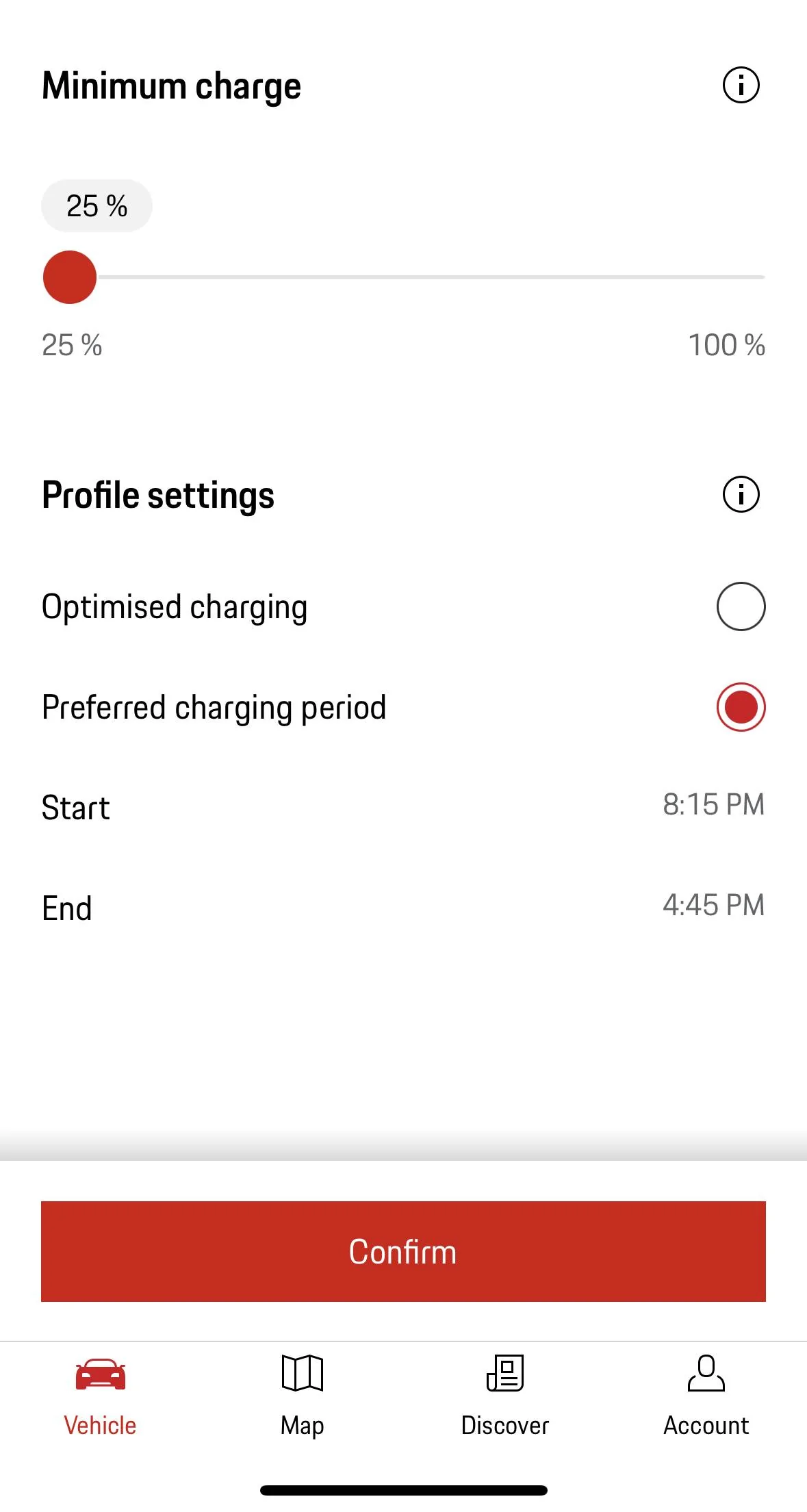

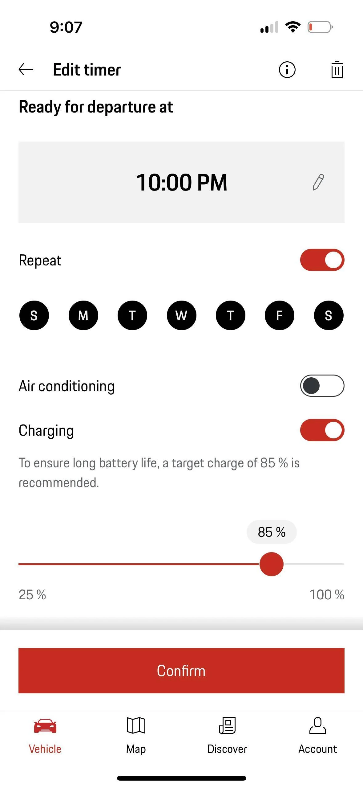

Can anyone confirm if I’m doing this right.
I want the car to start charging anytime after 8pm and to stop prior to 5pm. (Peak is 5-8pm).
I set my profile to preferred with start time of 815pm and end time of 445pm, but it doesn’t start charging at 815pm.
Therefore I Also set a timer for everyday at 7am but noticed it wasn’t charging at 815. Assuming it won’t start charging until it needed to to complete the 85% goal at 7am (around 5am since I’m 76% SOC now).
SO I changed the departure time to 10pm and it started right away as intended. Prefer to have a full charge asap Vs waiting until 7am but want to confirm this will work.
With my Tesla I just need to tell it when I can start charging (8pm) and the car starts exactly at 8pm
This sounds a little muddled if I'm following correctly.
You appear to have a pm / am mix up.
Start and end times chosen are within the same day - between 5pm and 10pm (not the other way round).
The timer is a departure timer which means I want my car to be charged by 7am (10 hours before your profile window).
If your off peak / low tariff period is between 5pm and 10pm then change your profile to reflect this.
If you want the charging session to end by 10pm then set the Timer to 10pm which will end the charging session for that day.
The car will then start to charge no earlier than 5pm and reach your target charge by 10pm and then stop.
The only caveat here is that your battery SOC can't be too low at the start of the charging session as there may not be enough time within your window to reach your target charge of 85%.

Thanks for the quick response. My SMUD peak during the winter is between 5-8PM, so I only want to charge between 801pm and 459pm. How would you enter that into the profile?
