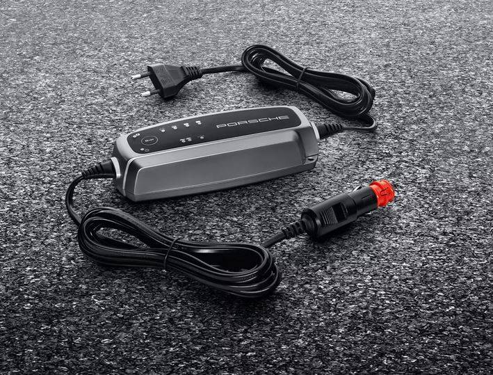

Thanks, I did wonder if it was just a 'dumb' outlet.
The Porsche trickle charge does use a cigarette lighter connector though:
