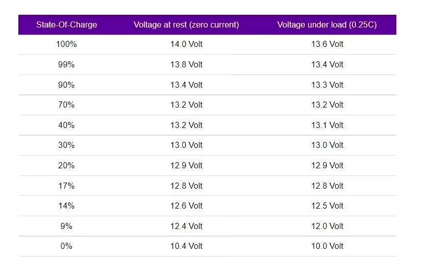

Sounds fine. Lithium has a very flat discharge profile compared to lead:
Porsche Taycan 12v battery level B4D1B7CD-86A2-4C65-873F-86EC498771F0
