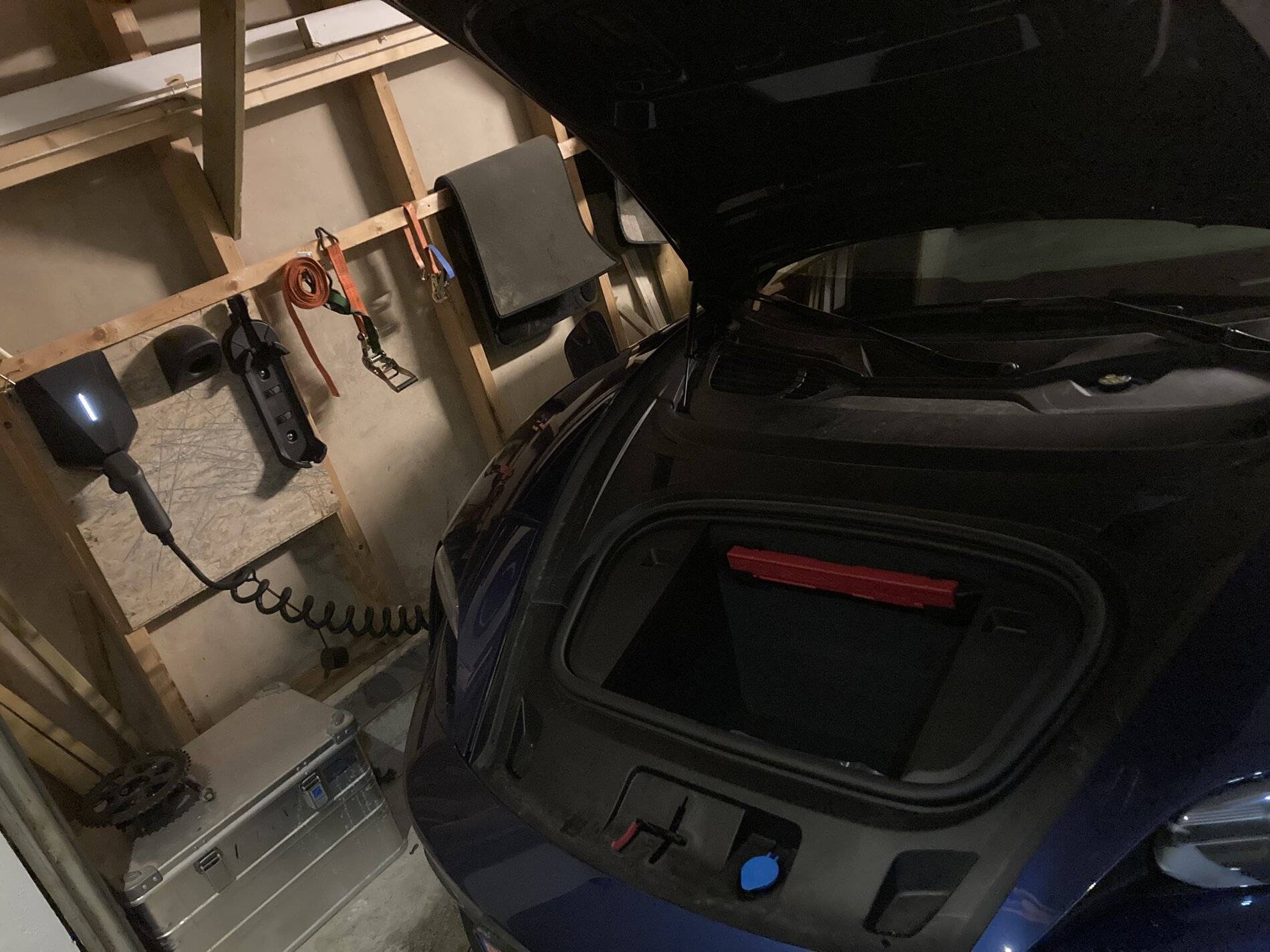

I have left my car in the garage with the trunk open since my experience of the 12 volt problem. I have a lithium charger but do no always connect it. I am trying to find a way of routing the cable so you just can plug it into the car.
The trunk light is on for a while but it shuts down after a few minutes so no drain there if you do not connect a charger.

Yes and No! We found a way to install a small connector under the windscreen with a watertight unit.
However Porsche did not want to install it for me. So I decided not to do it myself until Porsche has solved the issue completely. I did not want to risk them saying I had done some modification which would invalidate the warranty or contributed to the problem etc. etc.
Now it is up to them completely and I will not interfere with anything in the car at this stage.
I have left the cover panel off so it is quite easy to open the frunk and connect if needed. Since I park in my own garage now and do not go on any longer road trip due to the virus, I just leave the frunk open!

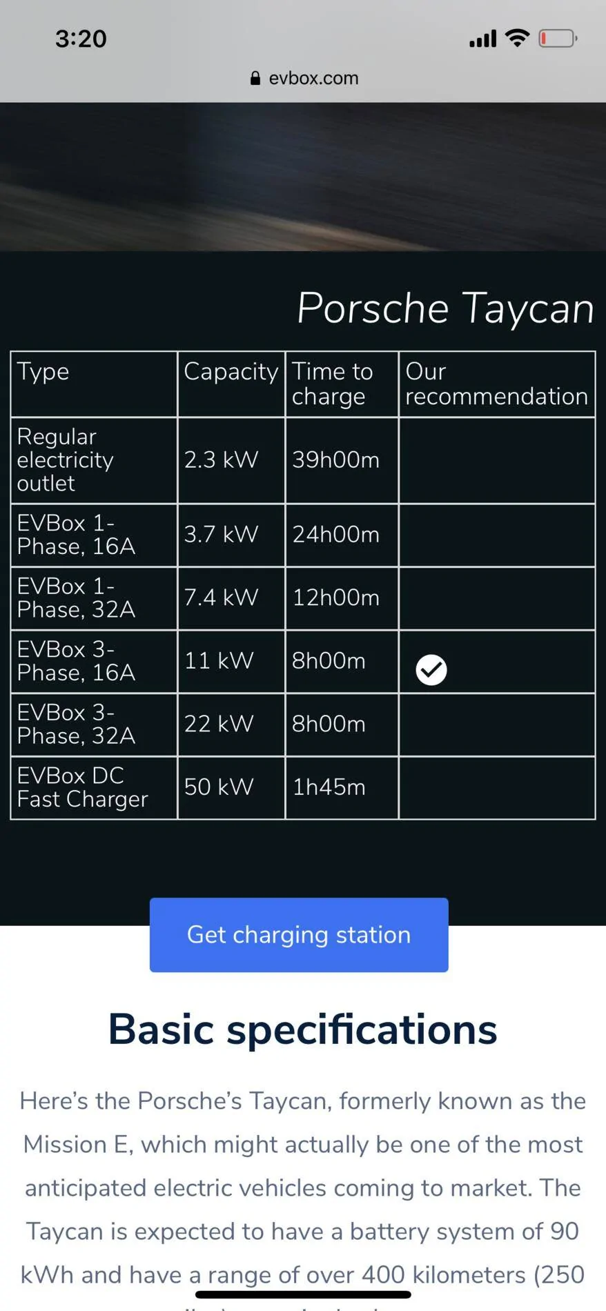

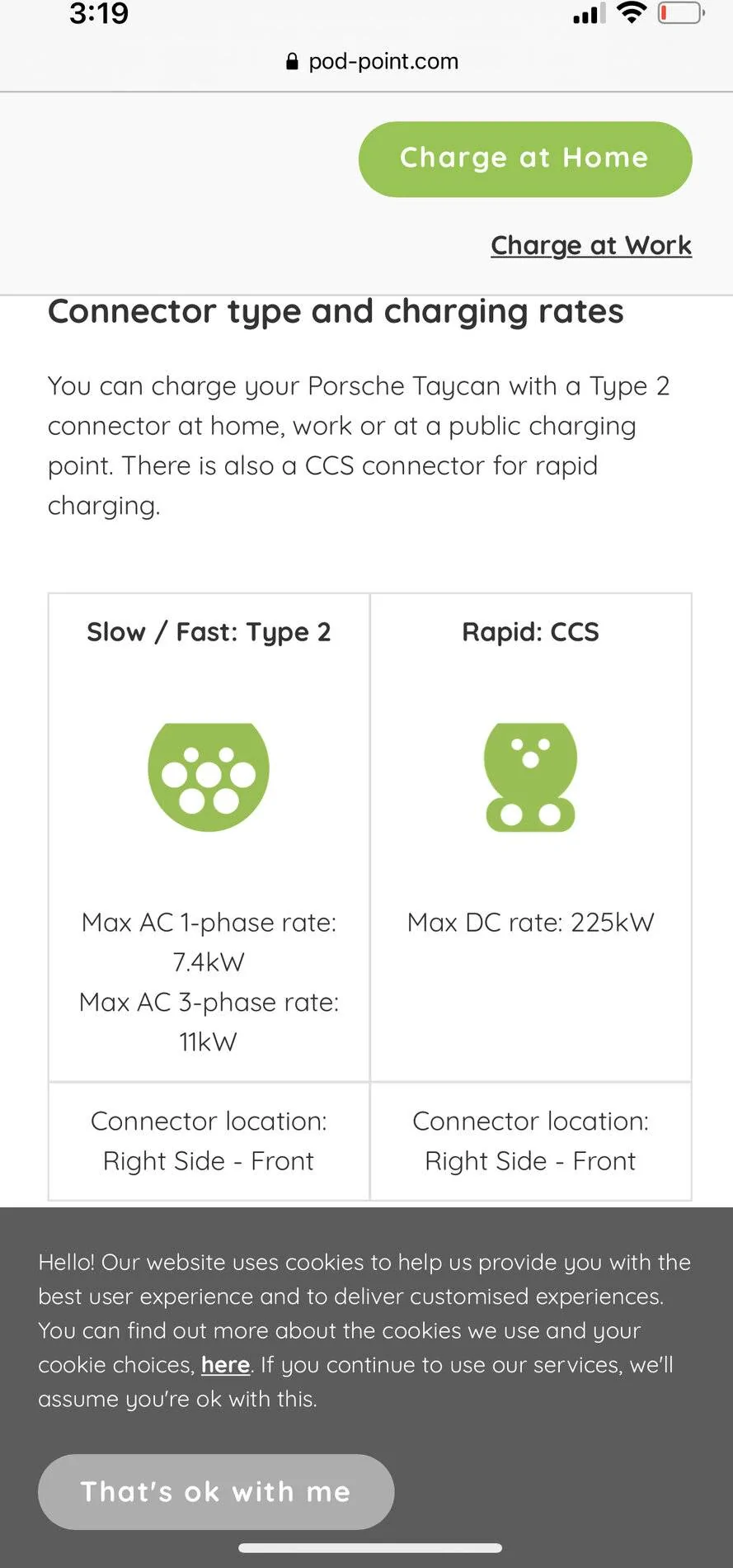

type on google 3phase 240 v chargingfor Porsche Taycan and you’ll see many chargers being sold .Ev box pod point . And trust me I have 3 phase 240 v supported by my Porsche mobile charger connect
