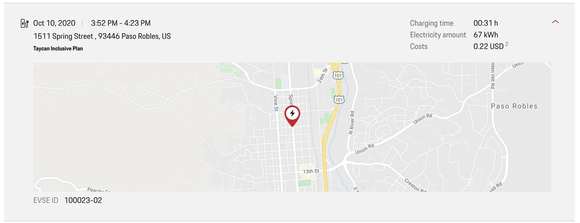

here is that charging session…
Porsche Taycan Charging a Porsche Taycan @ 350 kw 8B28610F-0BCC-403C-B7EB-A5E473E52D85
the session was 67 kWh in 31 minutes - if you break that down…and I left with 88% battery - and my wife and I felt a bit rushed to get back to the vehicle to avoid idle fees…
67 / 31 = 2.16 kWh per min of charge
2.16 * 60 minutes = 129.6 kWh per hour of charge
for an average charge rate of 129.6 kW - rounded to 130 - now this rate was not continuous because the car started at charging at 254 kW, but ended up somewhere around 90 kW at the end of the session
however at the 31 minute mark I was at 88% battery and had more than enough charge to finish my trip home for the that day.
the simple fact of the matter is that at a 350 kW charger you can’t spend much more than 45 minutes because frankly the battery isn’t big enough to hold enough kWh for 350/250 kW charge rate for 45 minutes, and once the battery hits about 92-93% SOC the charge rate drops off to be very very slow to keep from damanging the LiON battery - so the time you spend to get that last 6-8% battery simply isn’t worth your time or cost…
a sustained 120-150 kW charge rate will get you to 90% SOC is about 30 minutes - and given that the last 10 % is sooo slow you’re better off to unplug and move along to the next charger rather than wait for that last 10%…
in the real world I don’t see much difference between 22 minutes and 30 minutes and both feel a bit rushed if you take a break, go to the rest room, and grab a snack or beverage while you’re charging....
