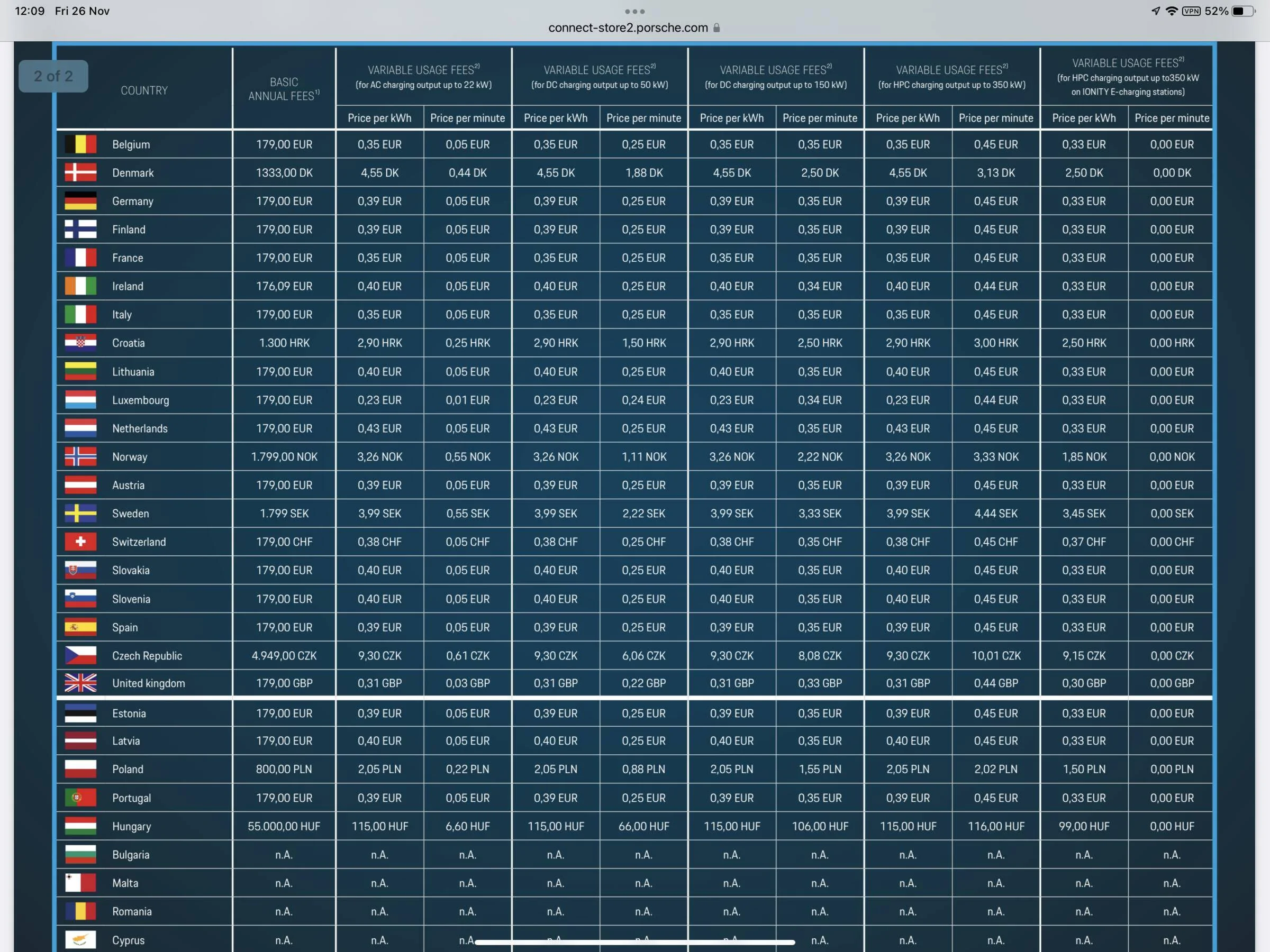

Ionity 350kw/h are the end right column in the table posted above.
Porsche dealers (350kw/h)are the one to the left, if I am reading it correctly.

I can’t see why they charge a time cost as well as a kWh cost. It does seem a bit excessive. Useful to know it’s there if needed, but best avoided if there are other options I think

Yes I totally agree with you. The breakdown is 0.2584 energy fee + 0.3667 waiting fee, so 0.625 in total.
3,907
3,552
I guess that is for a 350 kW rated charger and there is VAT on top of that.

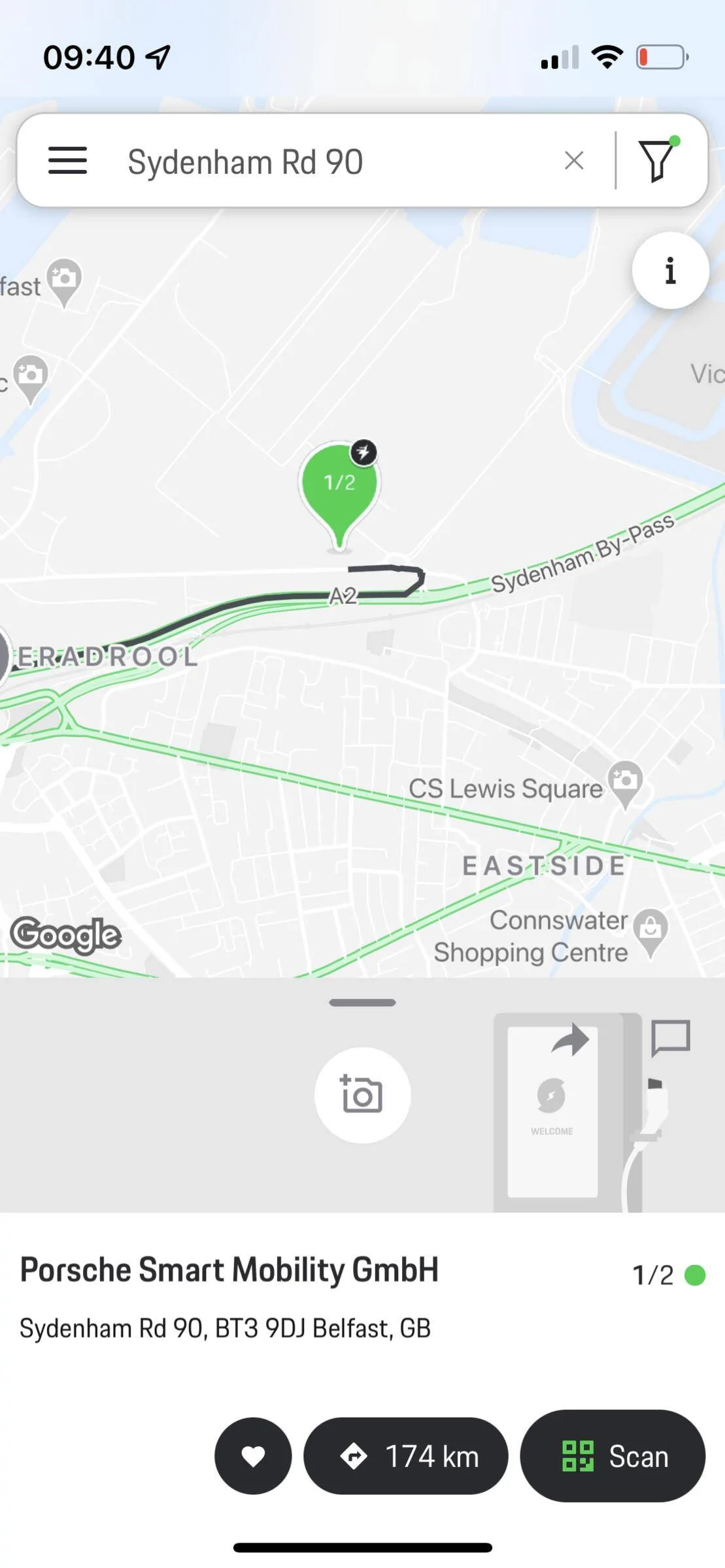

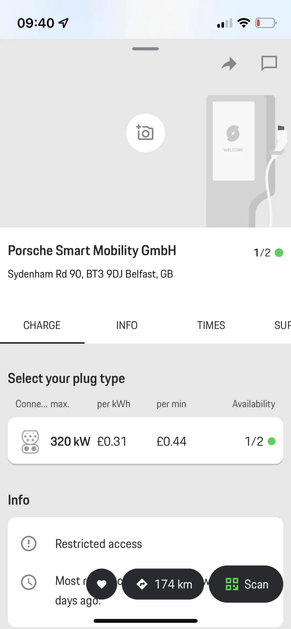

Here for example is the entry in the Charging app for the Belfast Porsche Centre (Dublin's charger isn't yet an official Porsche charger yet – more like a dealer high speed charger).
Porsche Taycan Charging at UK Dealers IMG_5626
Porsche Taycan Charging at UK Dealers IMG_5627
3,907
3,552
Yes I can see that one as well!, So it is being rolled out but at different speeds?

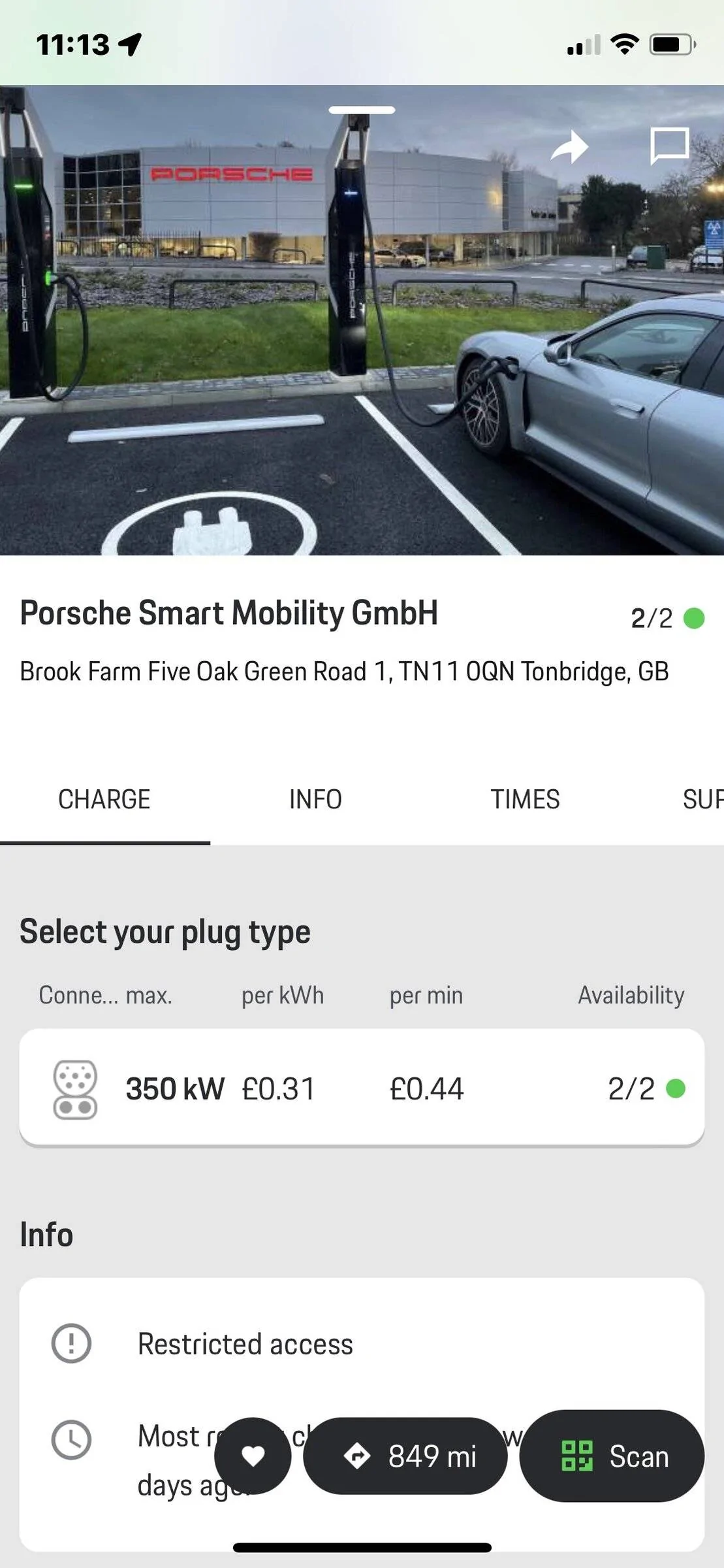

I could also find one at Tonbridge dealer U.K. that can come in handy for me some time!
Porsche Taycan Charging at UK Dealers F57AECE3-A60A-473D-BBF1-28B2FD7AFFA4
