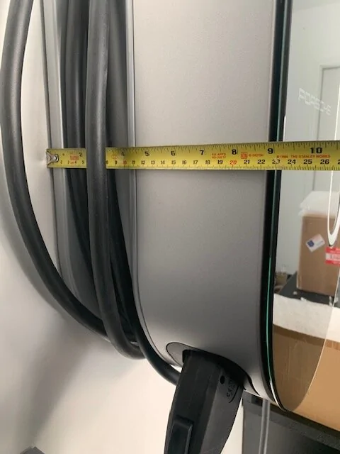

The depth is just over 9 inches. Manual says 9.1 inches or 231 mm. It is quite large but it is a very nice product that looks great on the wall and hides the 25 ft cord very nicely.

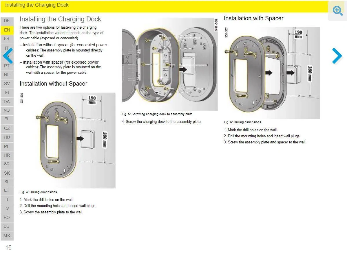

Yes I can see the dimensions state 232mm depth, but is that:
  • the depth of the unit itself, or
  • the depth including mounting plate, or
  • the depth including mounting plate + spacer?

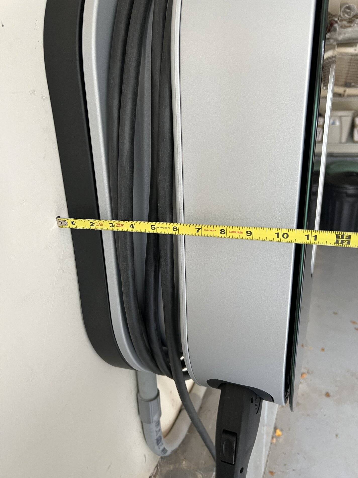

Porsche Taycan Charging Dock Installation Details F16AD494-D042-4E39-BD30-ECDDE1FC617C
Here you go. It’s just under 11 inches from the wall to the front, including the mounting plate and the spacer.

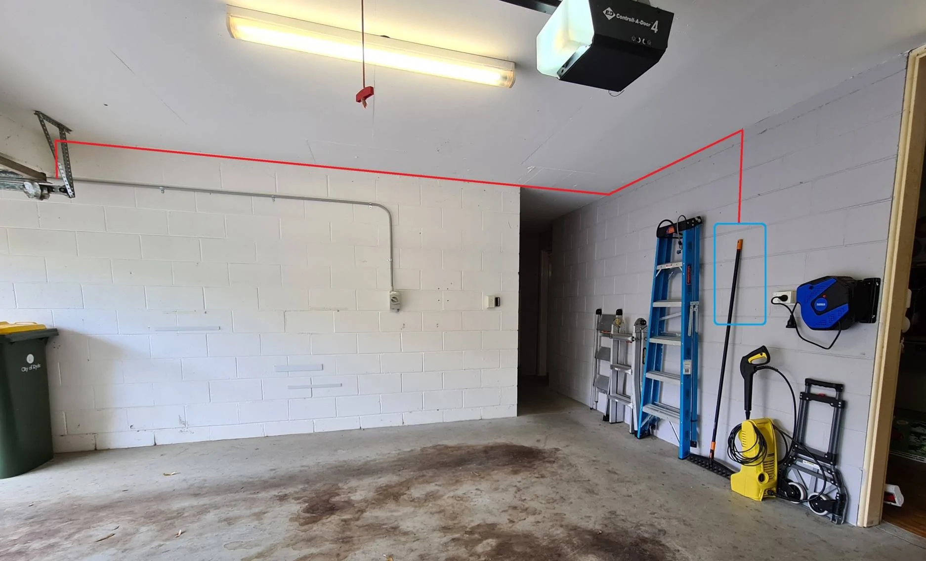

I think the best place to install my charging dock will be on the right wall amongst ladders, power cord reel etc. My Tesla wall charger was installed on the side of the garage (middle of the photo) which is best kept clear for foot traffic.
Porsche Taycan Charging Dock Installation Details ss (2021-12-02 at 02.39.34)
