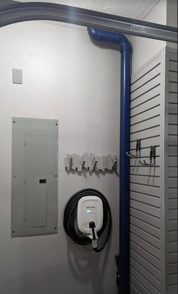

Do what everyone else just said and I just did. Direct wire into 60Amp breaker.
Too many options, I settled on the best rated by the State of Charge fellow: Emporia.
Porsche Taycan Taycan Charging Installation Question 1682795607723
I also just had 2 Emporia's installed - we also just picked up a MB EQE SUV for my wife. 2 50A breakers and hard wired. $450 each for the unit and it works very well. I originally wanted something a little more "flashy" but this unit is just as good as any other - unless it's installed in a cold weather region.

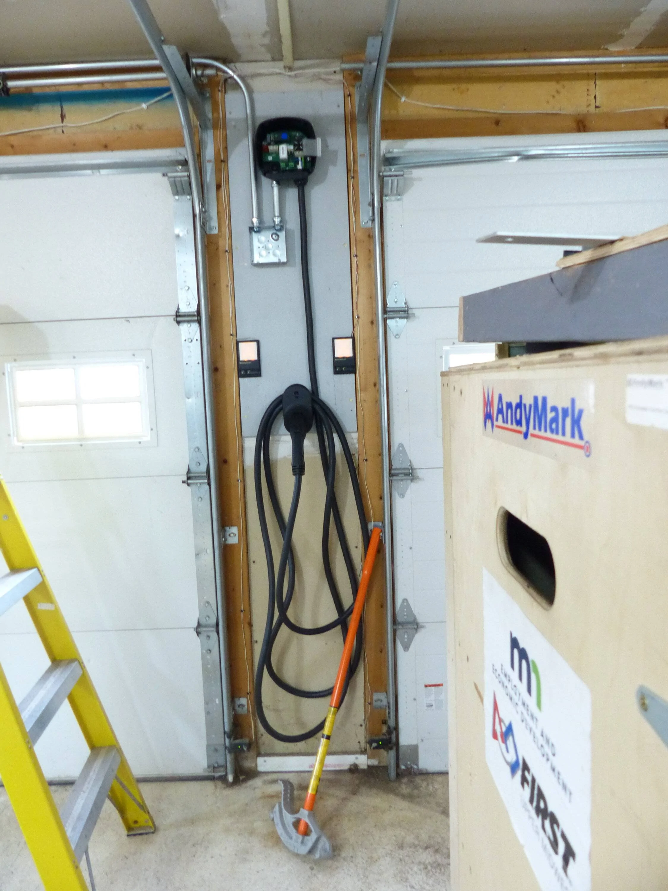

Ahh, well if we're sharing, here's my in progress installation. Once everything is positioned I'll get the inspector to come out and approve the rough in, then wire it.
looks good - pull some extra gauge wire - also if you hard wire you only need 3 wires not 4 like NEMA 14-50 - neutral is unused in 99% of EVSE's - two hots/ground is all that is required to hardwire ClipperCreek/Tesla/WallBox/ChargePoint/others…(Even Porsche's Wall Charger only requires 3 wires since it's hardwired only).
if you pull 6 gauge or 4 gauge wire I think that will pass code for a 60 amp circuit (check with an actual electrician not some random guy on the internet) - allowing a 48 amp charge rate for a standard taycan…6 gauge will 100% pass code for a hardwired 50 amp (or NEMA 14-50/6-50 install) - install a 6-50 and all you need is 3 wires also - and you can then get a $20 adapter on amazon for 6-50 to 14-50…and saves the cost of the unused 4th neutral wire (which is expensive these days).
I'm kinda "over" mobile EVSE's and the whole NEMA 14-50/6-50 drama…hardwire it and forget about it.

Yep, #6 THHN in .75" conduit on a 60 amp circuit. Everything up to code and the rebate will cover the entire cost.
I'm also really happy with where I ended up putting it, it works for cars on either side of the garage and reaches out into the drive if someone with an EV visits and needs to top up.
