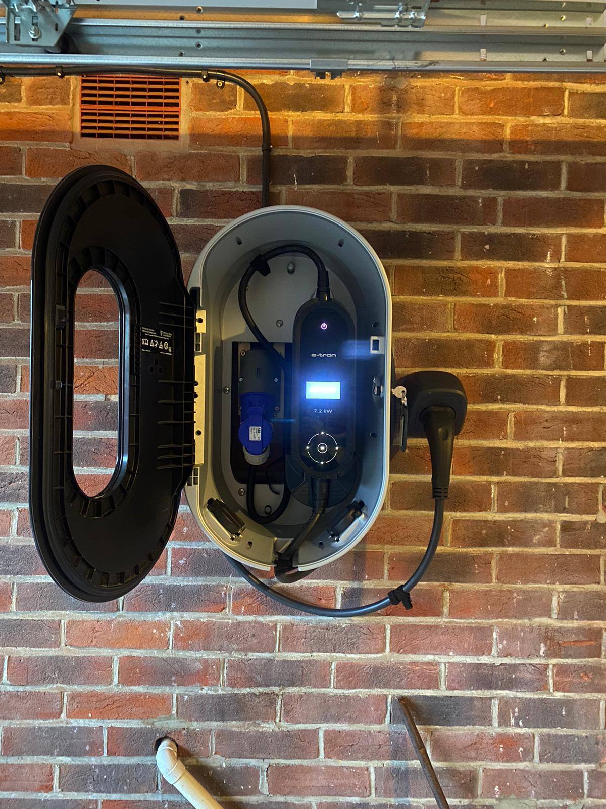

Managed to source a box off e-bay for £95. Friend installed a 40a radial in the garage to give the necessary 32a. Those eagle eyed members will see that the charger is in fact an e-tron charger. It is the same as a Porsche Universal Charger but with different branding. When my Mobile Charger Connect arrives I will fit that so the e-tron version will be the one I take when I am out and about. That plus cables and bag again e-bay for £128.

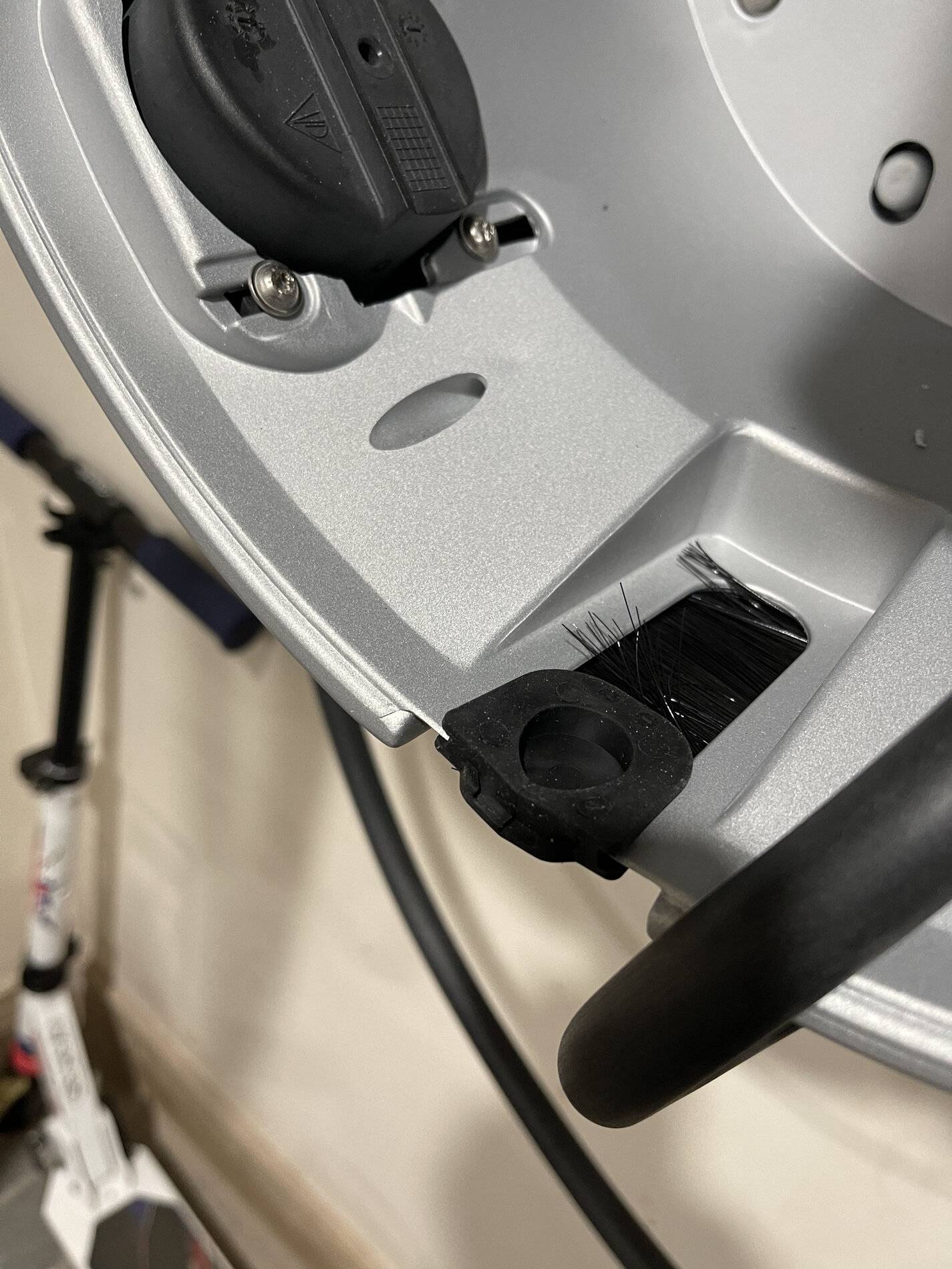

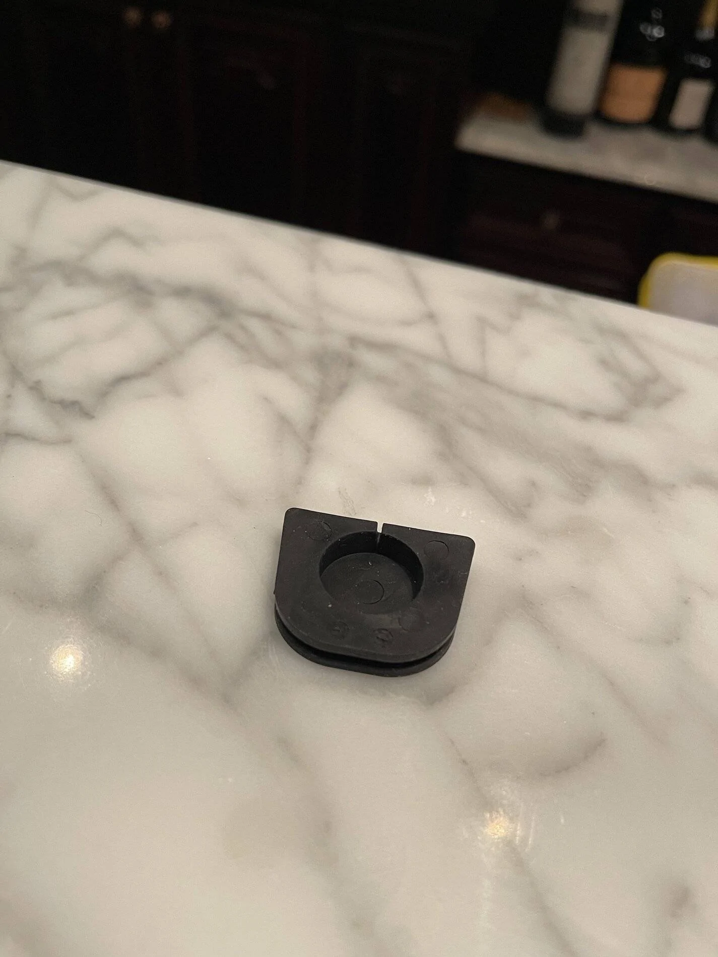

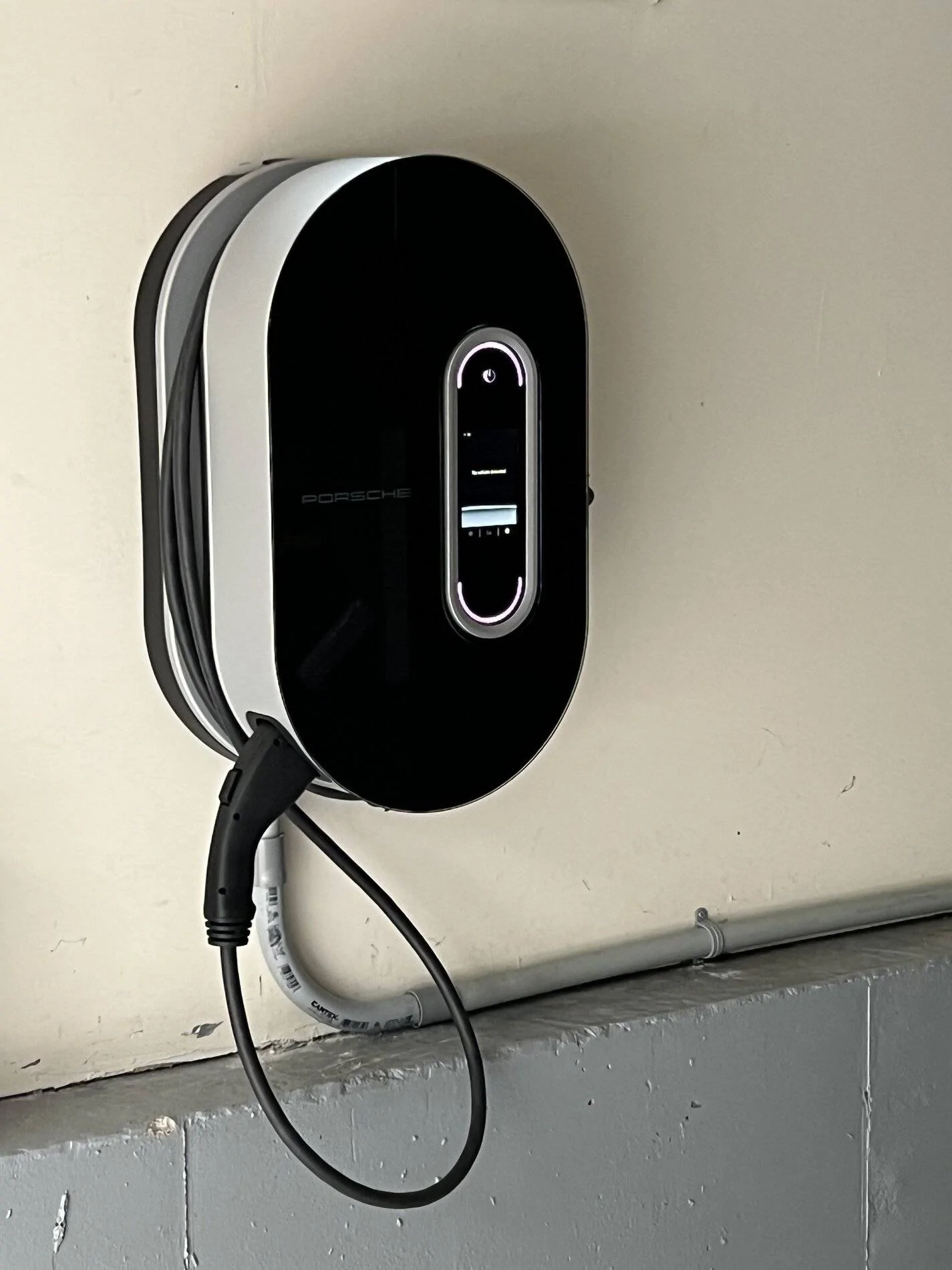

The charging dock was installed a few days ago. There were two rubber seals or bushings not used. Looks like maybe for the cable slot on the bottom. What is correct?

Those plugs are for the wall side of the unit, top and bottom where conduit runs into the housing. You could replace it on the bottom of yours, given your conduit runs down into the top of the unit.

Looks just like mine. I didn't end up using the extra bushings for anything. They're just sitting inside the case.

Thanks to both of you. i'll just leave them inside in case i every need to change the setup

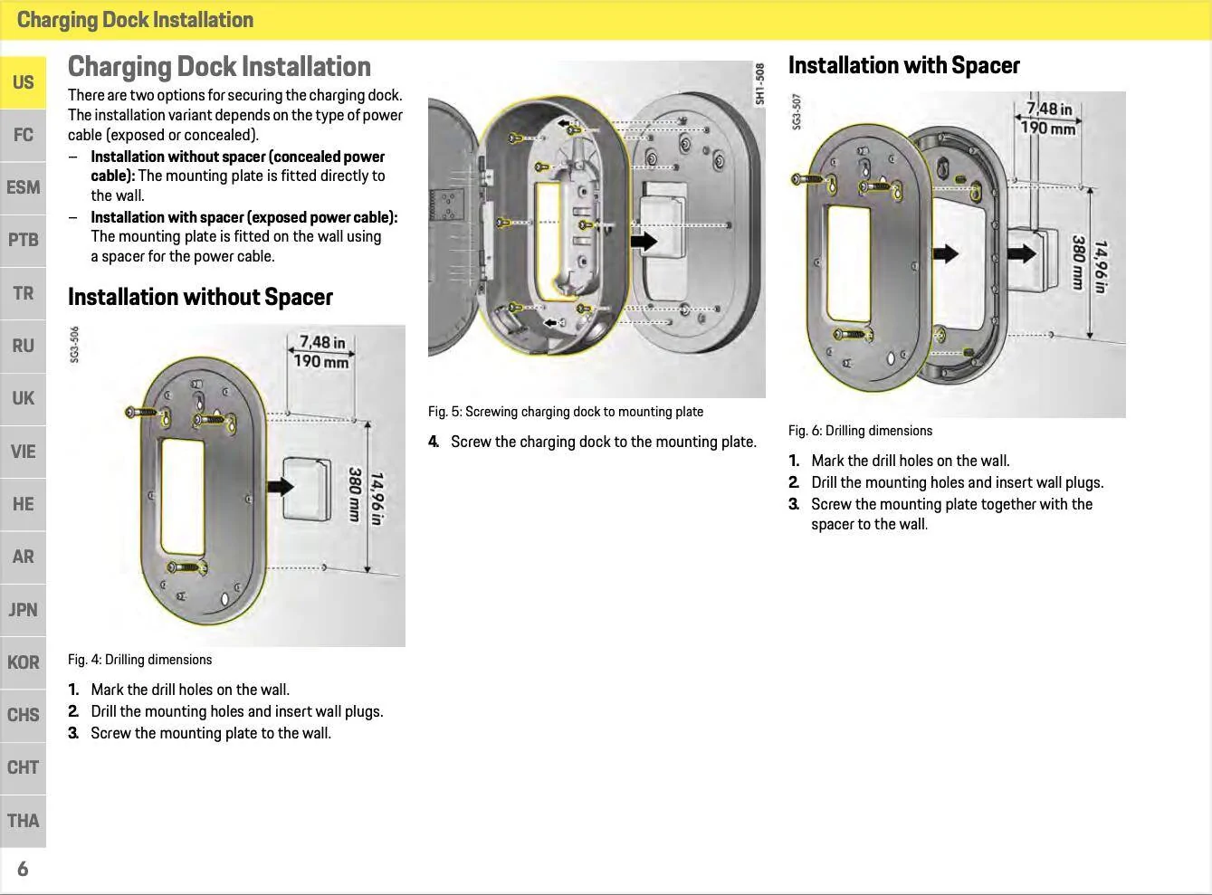

For some reason my dock didn’t come with screws long enough for the spacer.
Anyone else have the same thing? Which screws did you guys get?

I had to go buy lag bolts at the hardware store so I could be sure that they were going into the wall studs far enough. I think the ones I got were 3/8" diameter and either 3" or 3.5" long.

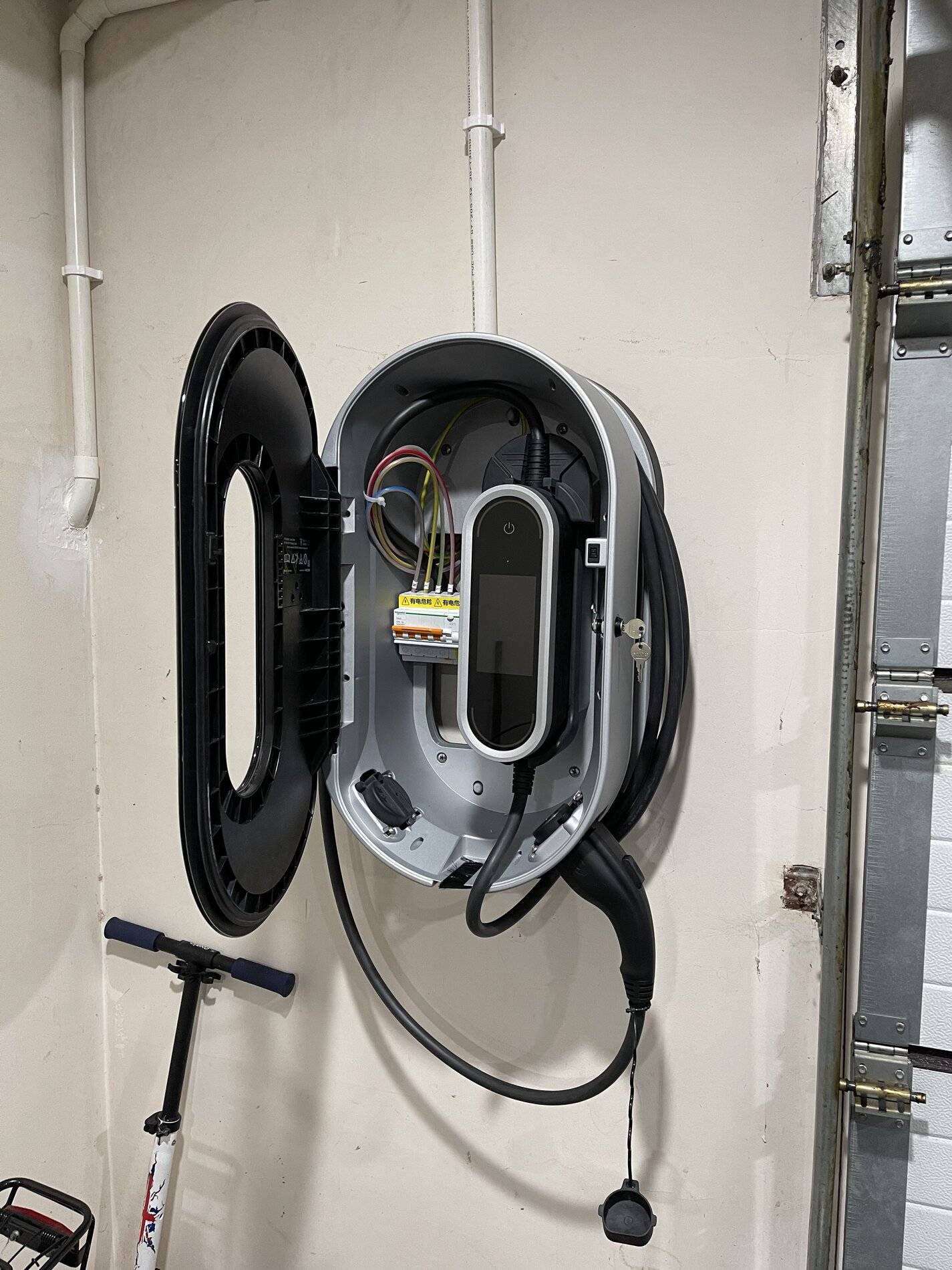

Same issue here. The included screws would have been OK had I not needed the spacer but it wasn’t even close with the spacer (which was necessary because of the conduit). Thankfully my electrician installing the NEMA 14-50 outlet had longer lag bolts in his truck.

thanks all - I ended up getting 5/16 3.5" lag bolt - it worked well.

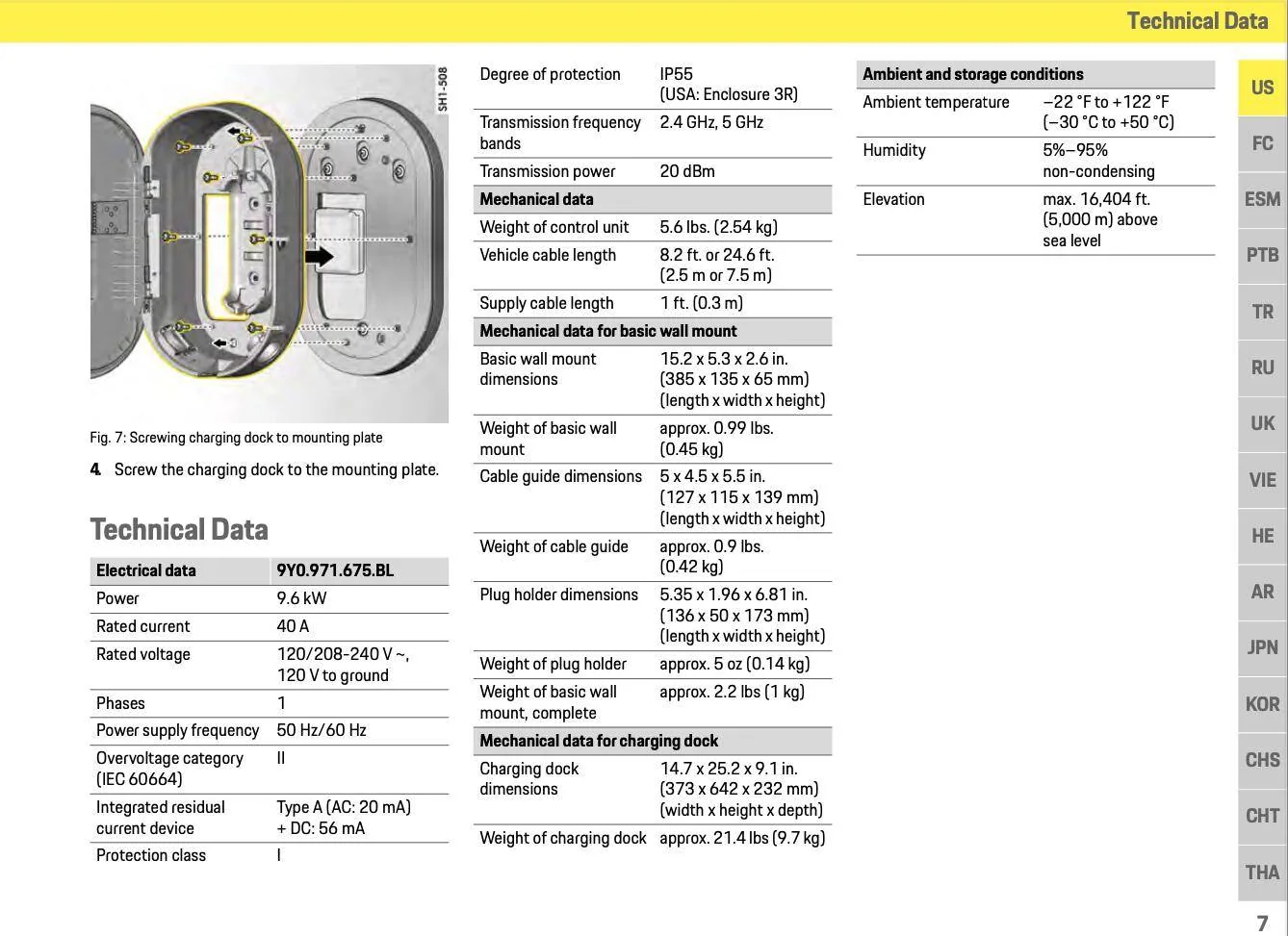

The charging dock is so much larger than I thought (coming from a Tesla.) How far does it stick out from the wall with the spacer?

The depth is just over 9 inches. Manual says 9.1 inches or 231 mm. It is quite large but it is a very nice product that looks great on the wall and hides the 25 ft cord very nicely.
