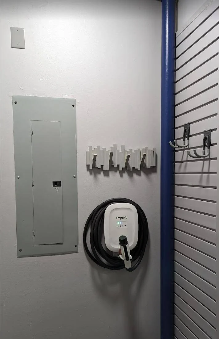

Direct answer from me is the following:
1) Get a real EVSE and hardwire it by the electrician for clean install. I got Emporia and love it.

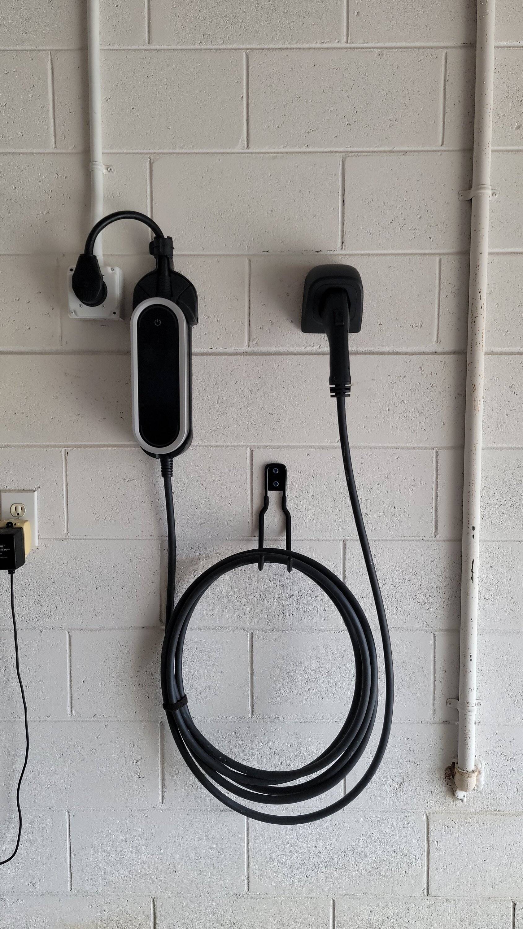

Nothing wrong with what came with the car. Why pay more?
Completely agree if OP already has the charger. My Porsche charger setup is as shown and works for me, although notice how short the cable is from the receptacle to the charger itself.
I originally went this route but the PMC+ and PMCC have an overheating issue in the US and mine started having issues within about 6 months of installation. I swapped out to a relatively cheap Lectron EVSE and have never had another problem charging at home. There are many threads on this forum describing this issue.
... There are many threads on this forum describing this issue.
Yeah, I read those as well and had some concerns but went with the Hubbel receptacle and fully rated wire, plus my car included that charger from the prior owner. I figure I'll use it for now and buy something else if the OEM starts to have problems.

Yeah, I read those as well and had some concerns but went with the Hubbel receptacle and fully rated wire, plus my car came with that charger from the prior owner. I figure I'll use it for now and buy something else if the OEM starts to have problems.
Hopefully you won’t. I have the industrial outlet and proper wiring too. I do however live in Texas and it stays HOT in garages here in the summer. I see you’re in Florida so I would expect your garage temps to be pretty high during summer too. My garage even has an active ventilation system.
