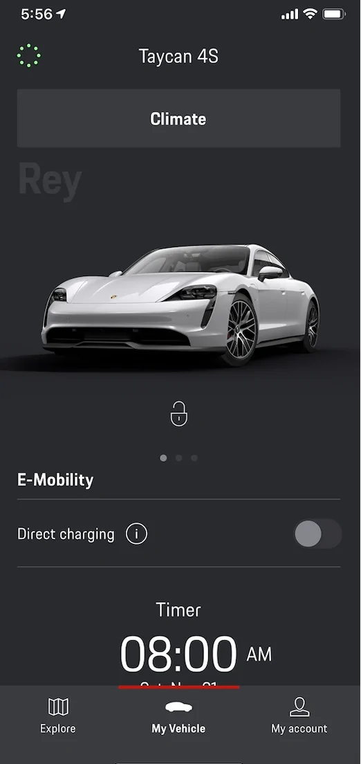

Here's are two screenshots of the app. Just click on the "Climate" button anytime to randomly cool down or warm up the Taycan. After clicking on "Climate", you can click on "Edit" in to top right of the next page to configure the temp and zones you want to cool/heat.

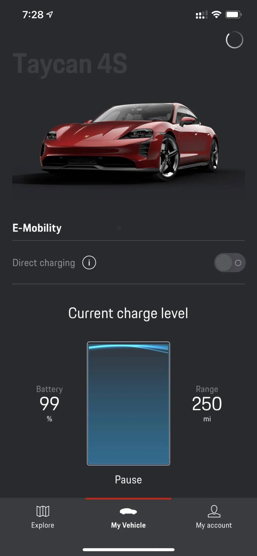

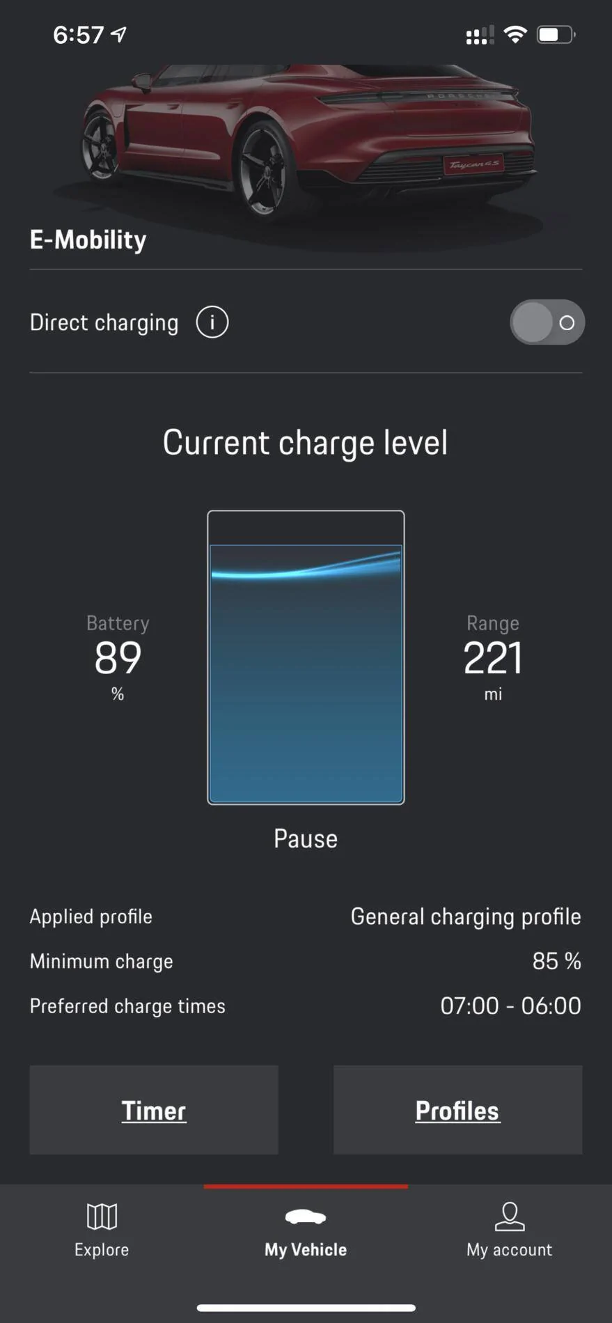

I watched the Video and talked to the service department and I am totally confused.
I have no timers and only have the general profile active which is set to 85% charge.
So i plug it in at 8 PM and the car charge is over 85% and I think thats great that its not charging as per the profile. But then this morning is shows a charge of 99%.
The service department tells me that 100% means that its charged to 85% as per the profile. If this is true its crazy logic. And when I asked how do I know how much my battery has they gave me a strange answer because using their logic if i set the max charge to 25% it would show 100% but only really have a 25% charge.
What am I doing wrong or is what the service guy saying correct...I was expecting to get in the car in the morning with an 89% charge....Since it's over the maximum charge in my general profile of 85%....And direct charging was not active....

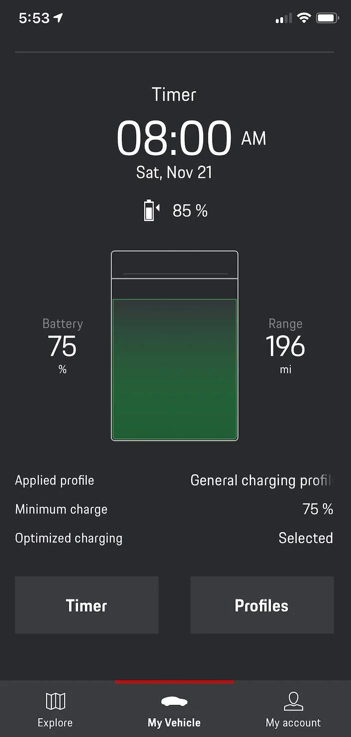

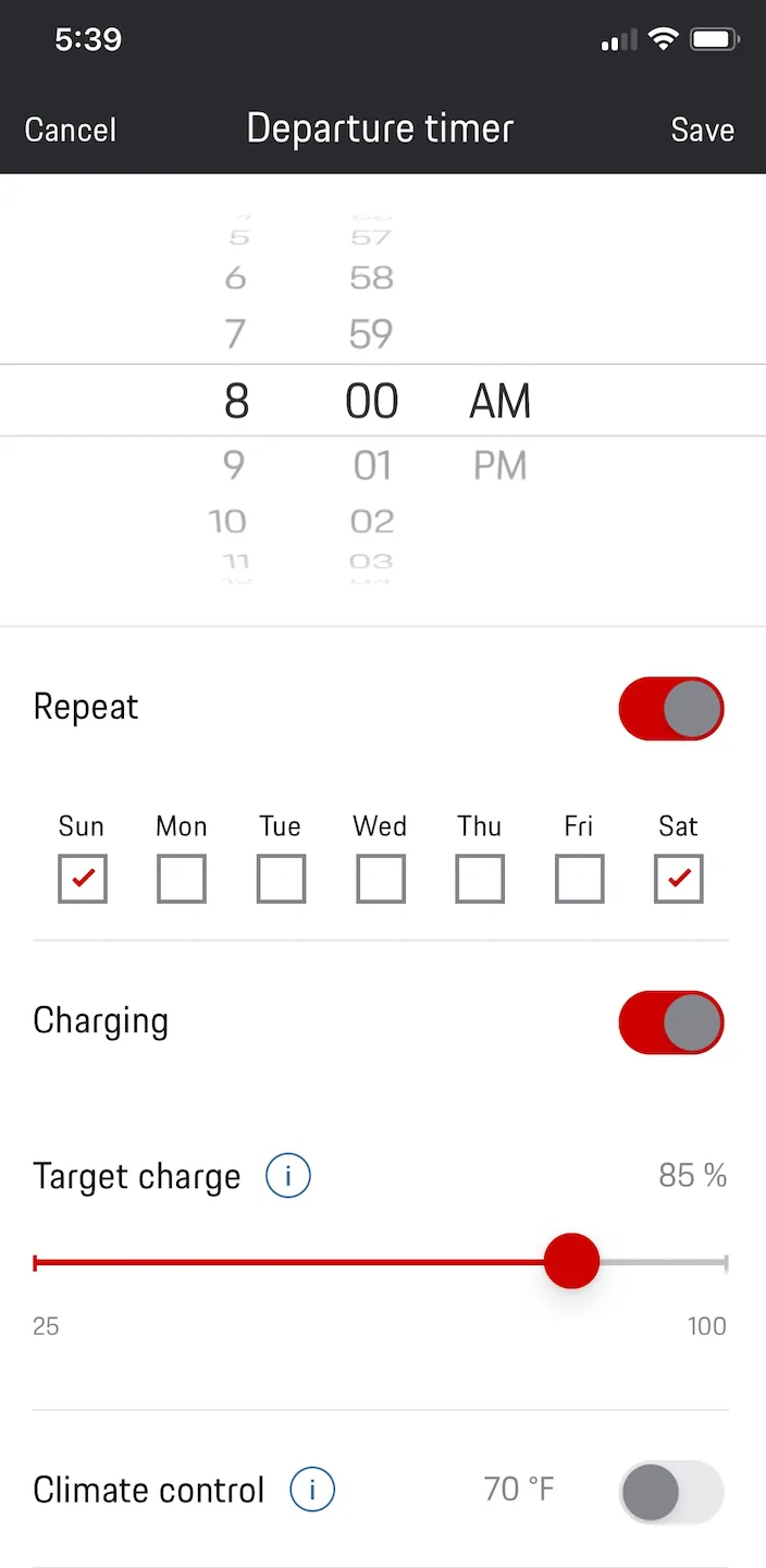

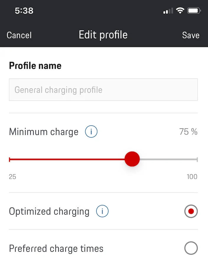

I think your service guy is wrong. All charging percentage values you see are the percentage of the battery YOU can charge. 100% for you might indeed mean 85% - 90% for the battery. 0% for you does seem to mean 0% for the battery. If you have direct charge turned on, that's a definite cause. Assuming that's not the case, the other cause is that you have preferred charging times set in the profile but no departure timer. If you want to use only the profile to set the charge target, you have to set the profile for optimized charging, not for preferred charging times. If you want to use preferred charging times, you have to also use a timer to set your target charge level and departure time.
Thanks. Will turn on "optimized charging" and sees if it stays at 85%
