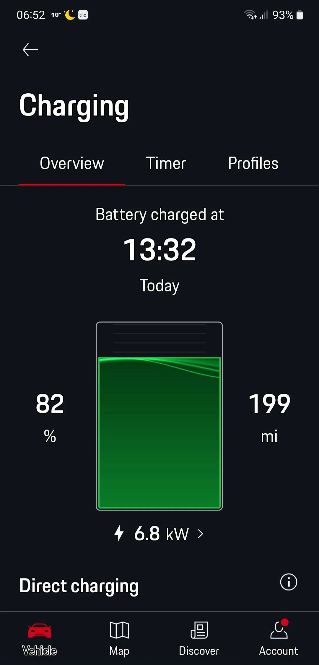

Various pics relating to the issue.

I deleted all timers and created them again yesterday. This morning the MyPorsche app started displaying an
interesting information. It is saying that my car is in UTC timezone (which is not true, the car is just next to me in Paris UTC +2).
Porsche Taycan Charging Timer intermittent faults IMG_5845
So this has definitely something with the car’s time getting buggy.
Then I set a timer for 8:40 AM (5min later as a test). While refresrshing and sending the timers to the car the app displayed different times. It displayed 5AM instead of 7 AM for my existing timer. Also 6:40 AM instead of 8:40. This was brief and then it put back the right times. It is also no longer displaying that the car is in UTC timezone.
Probably the app displays the car’s timezone in the app when it thinks that it is different from the phone’s timezone. (Which was not true)
Now with that mention disappeared maybe the bug disappears for the time being.
I will monitor and share in case it helps someone one day
