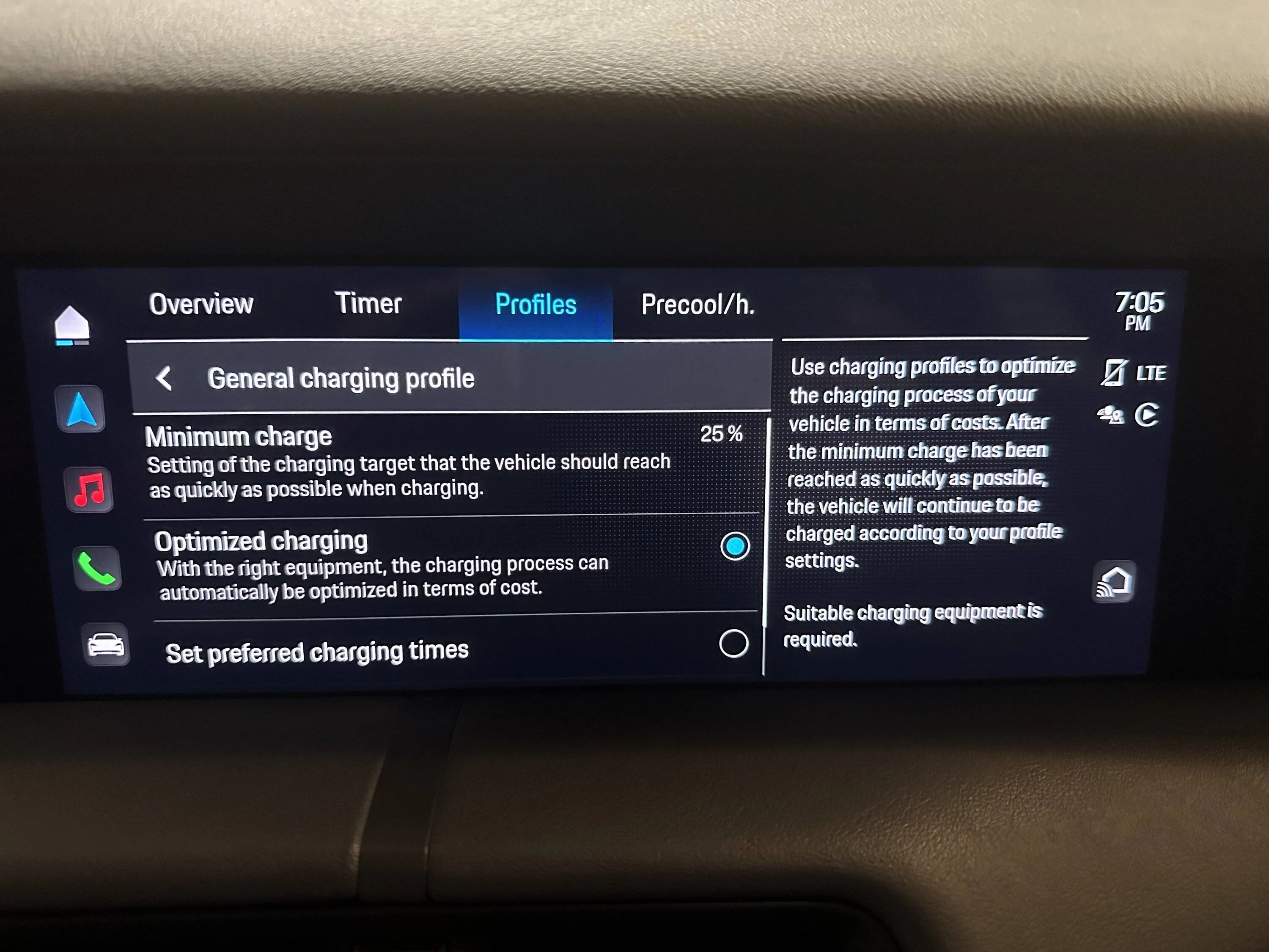

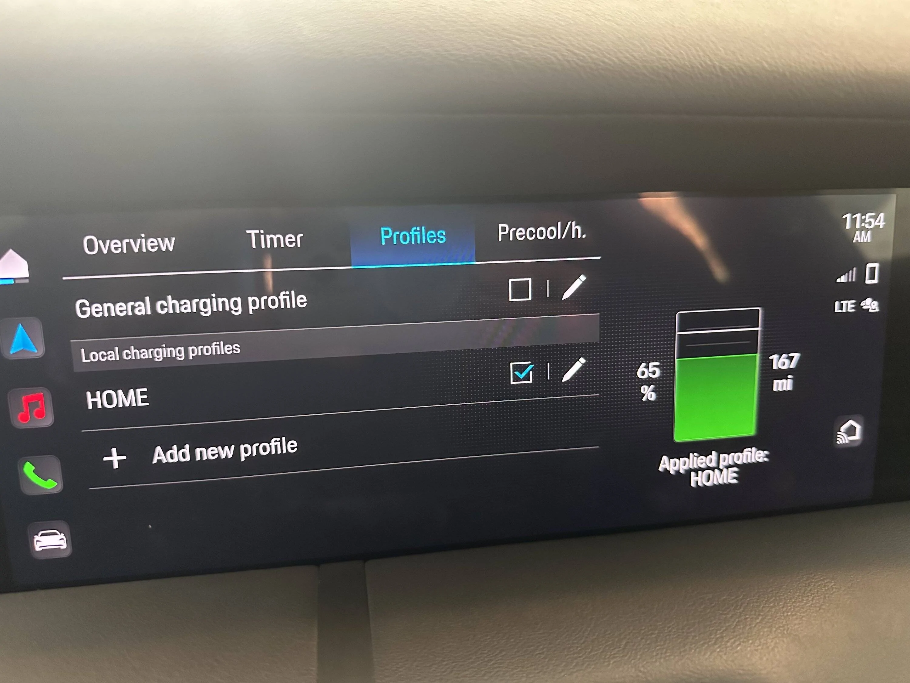

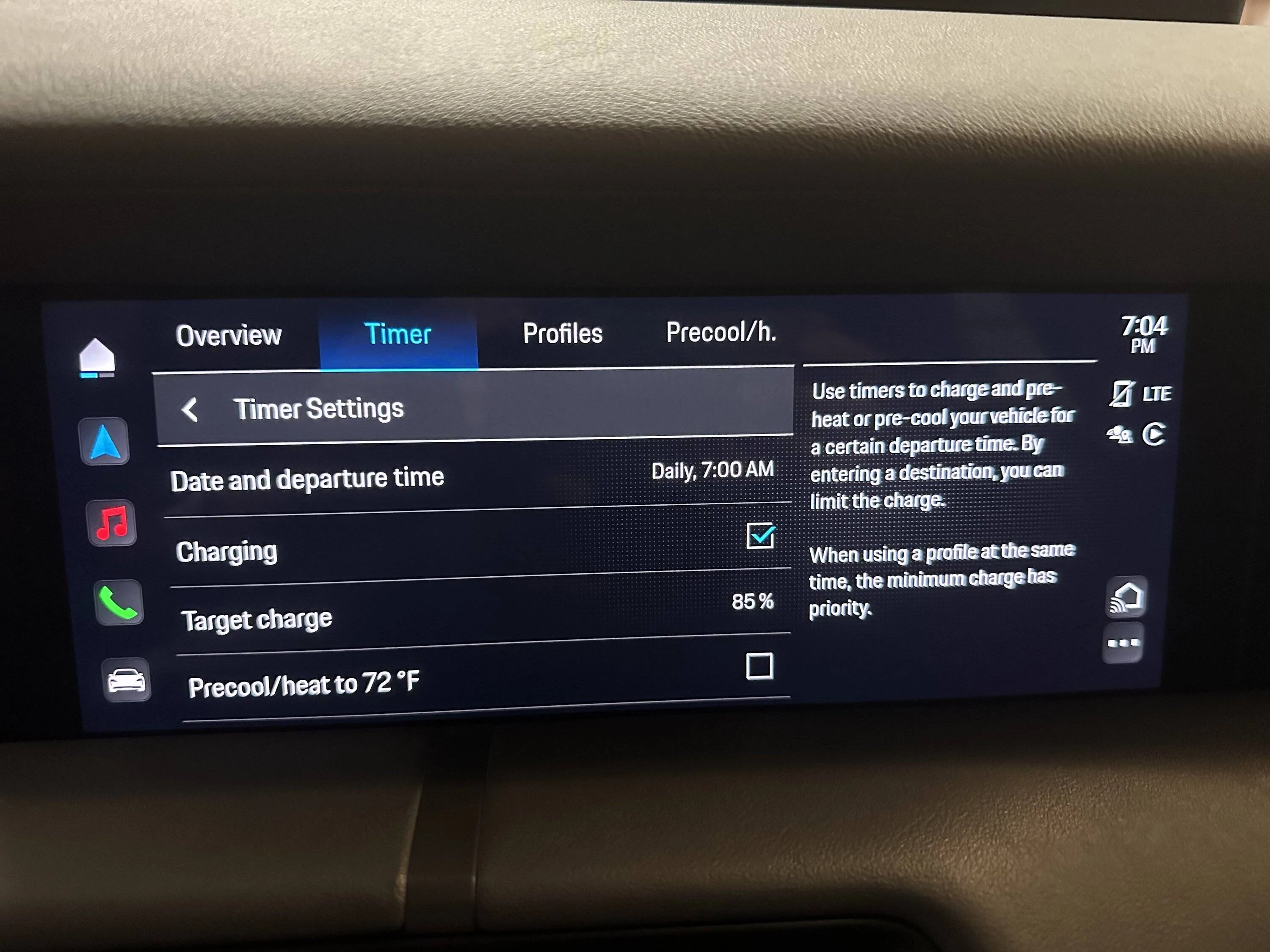

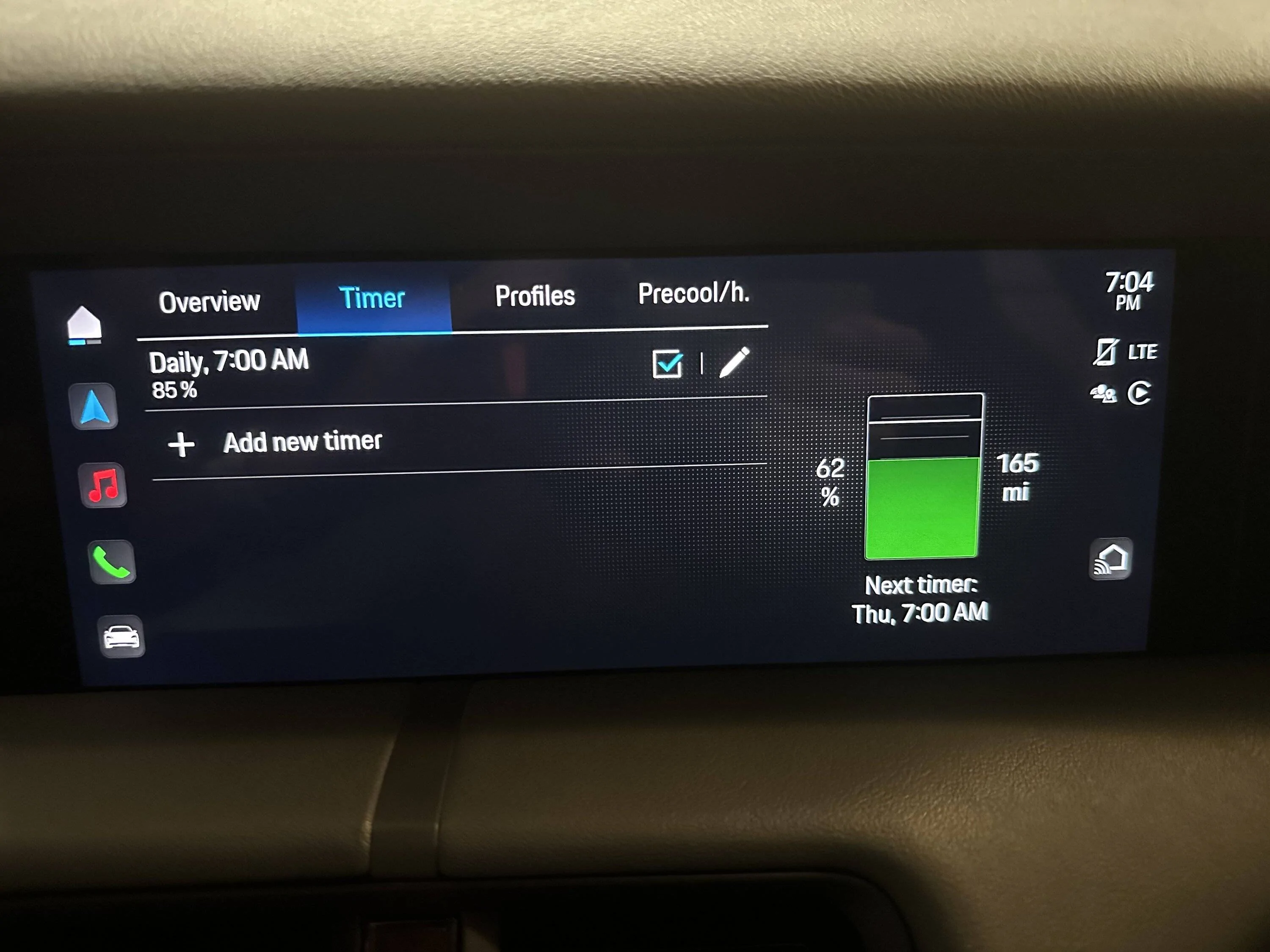

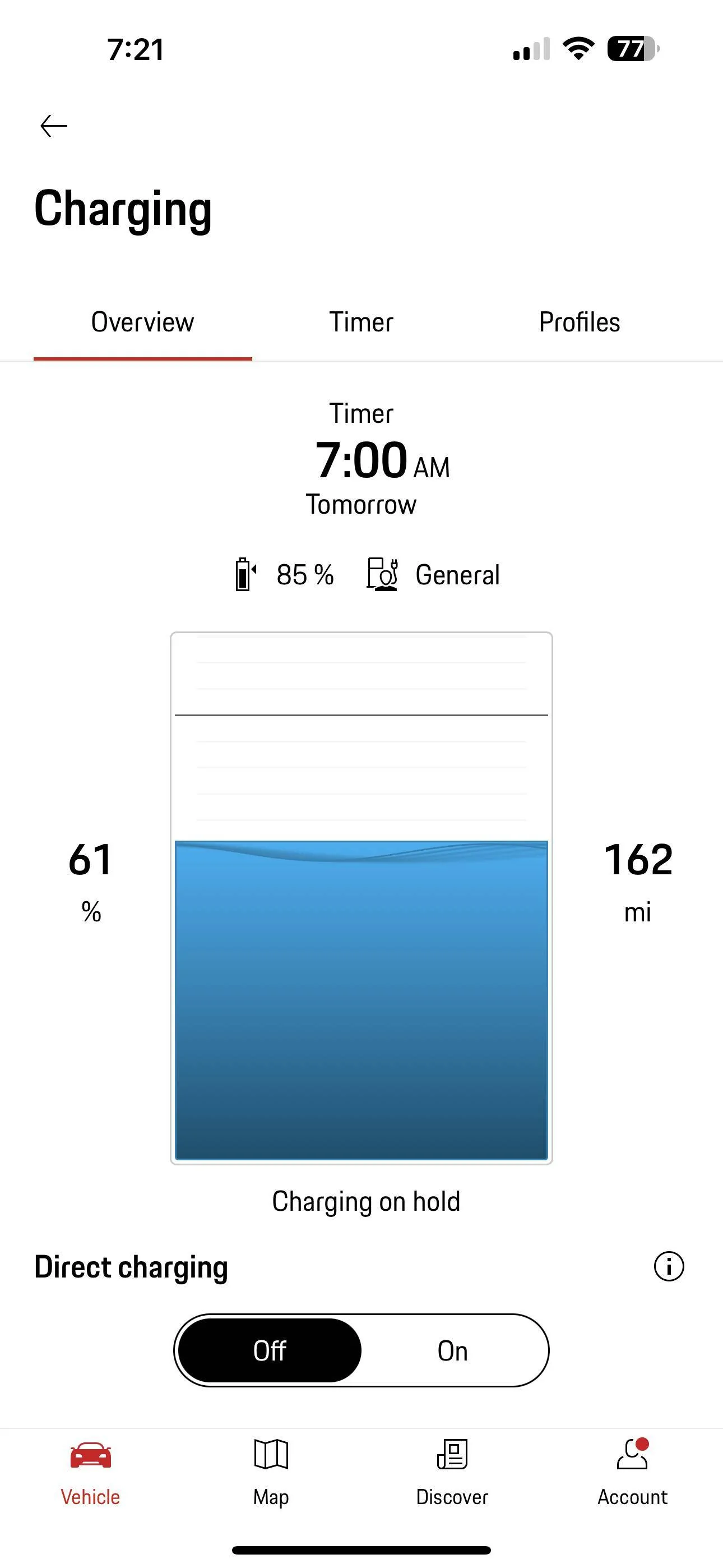

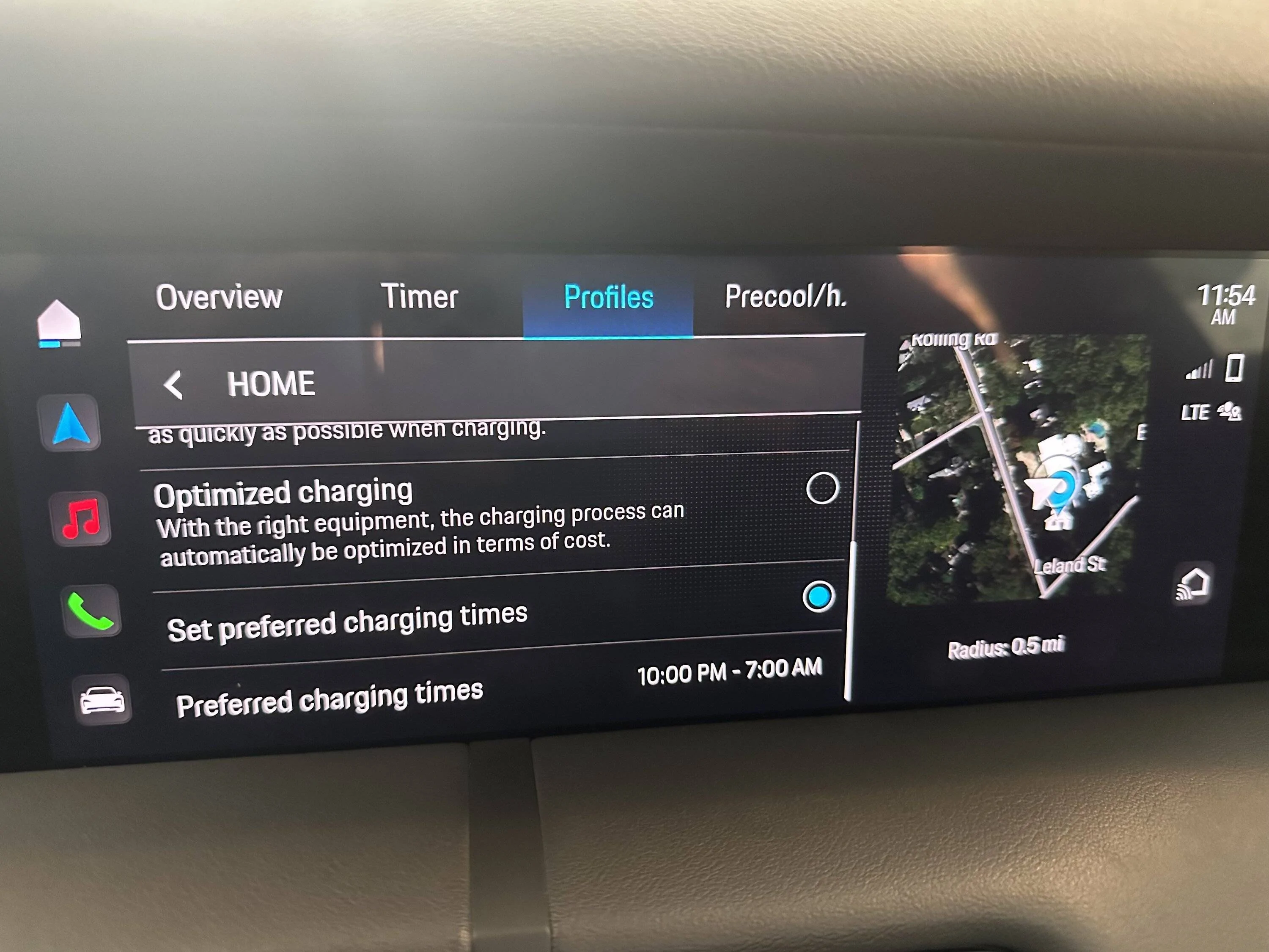

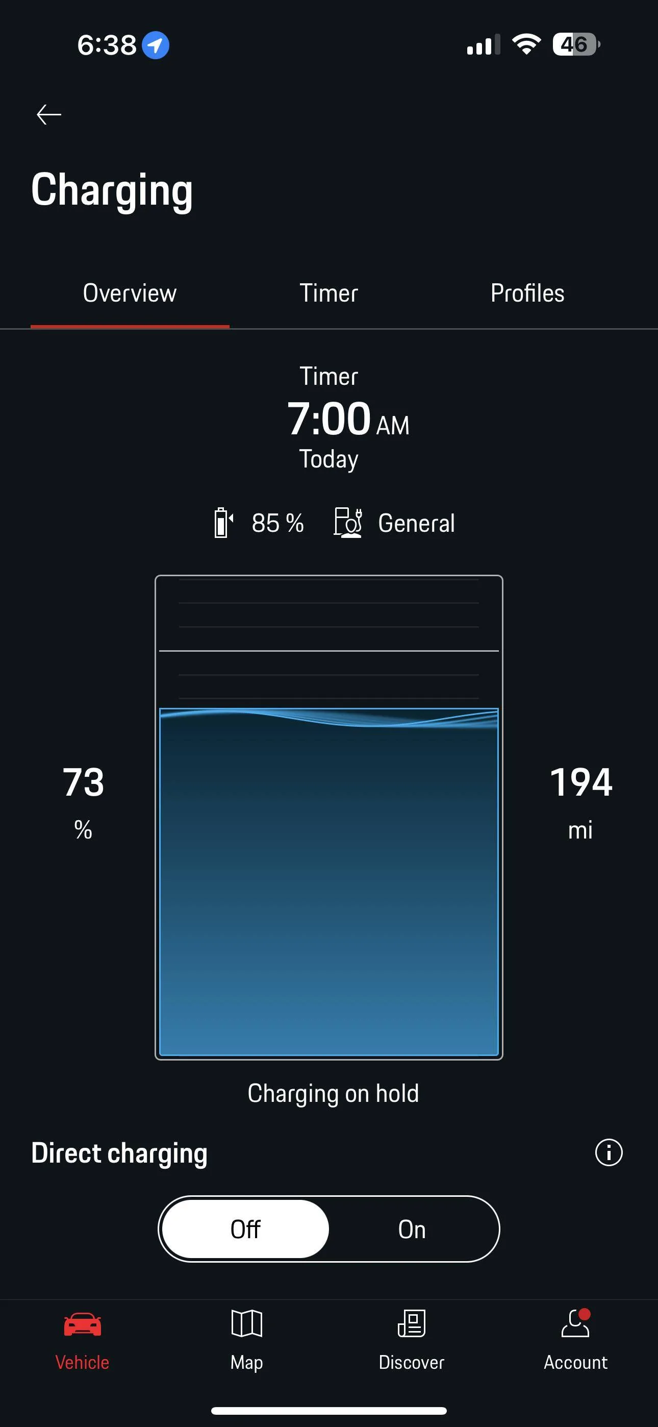

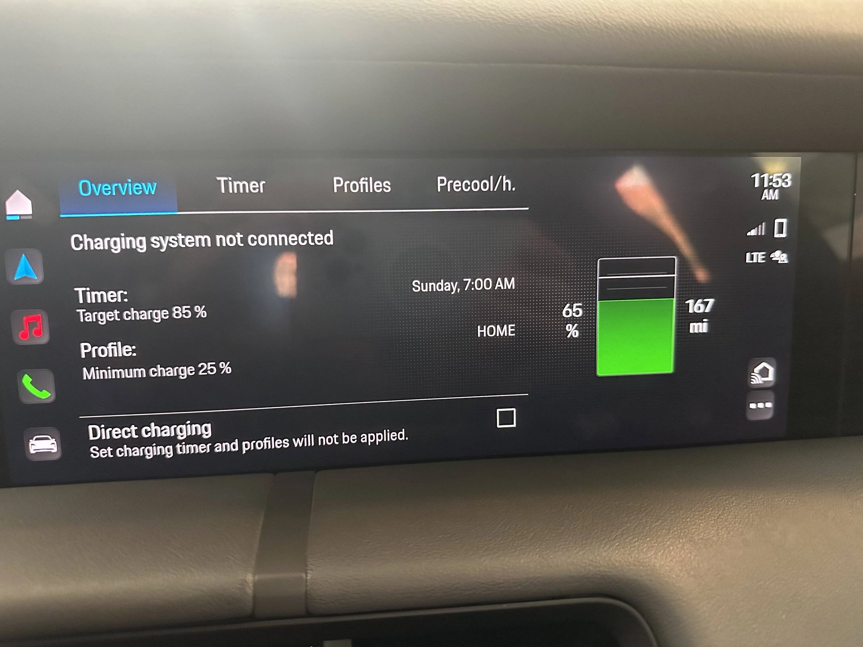

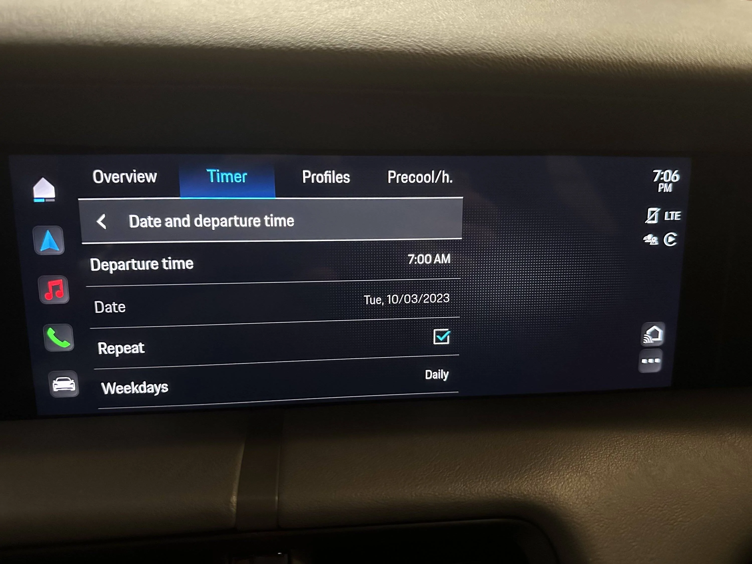

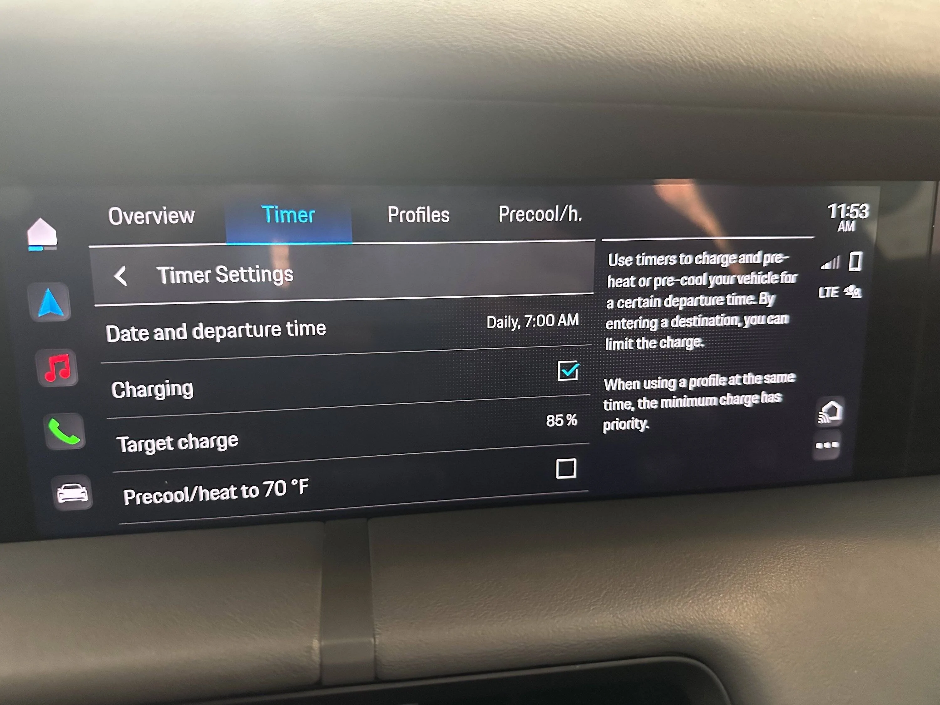

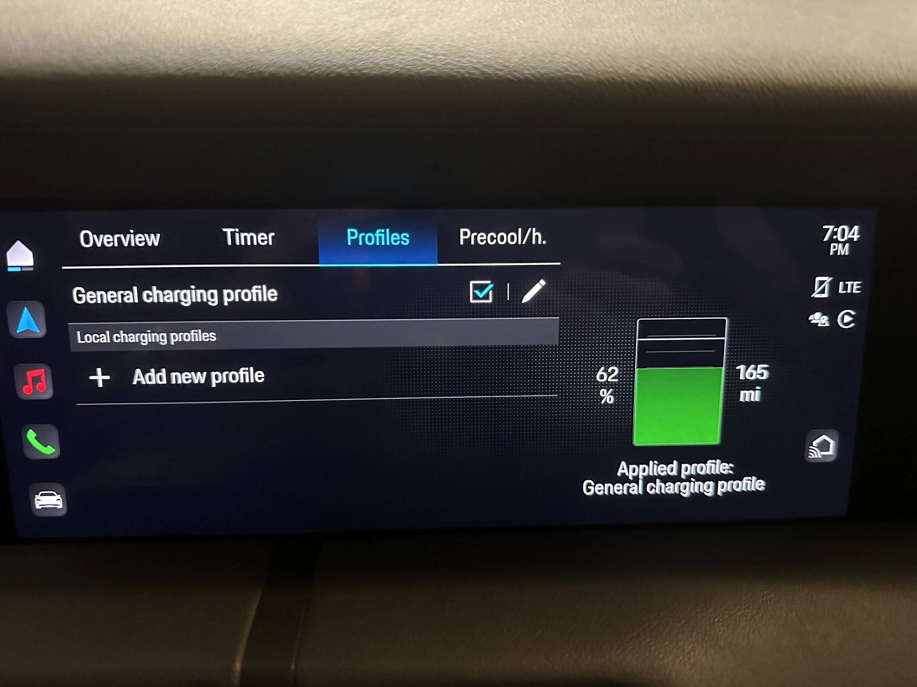

I’ve never been able to get charging timer to work
These are my settings
What am I doing incorrectly, please?
every morning, with power plugged in from Chargepoint device, it always says “charging on hold”

In your general profile, lift up the minimum charge from 25% to 85%, or the charger will pause until the right time to reach the target charge by 7:00AM. Same result?

Setting minimum charge to 80% gets the job done. Plug and play.

It’s looks correct to me. You have a profile set to min 25%. That means the car will always charge at least to 25%. Then you have a timer set to 7AM and 85%. It means it will charge to 85% by 7AM. If you want to always it charge to 85% and stop regardless of time of the day, use only a charger profile set to a desired %.
