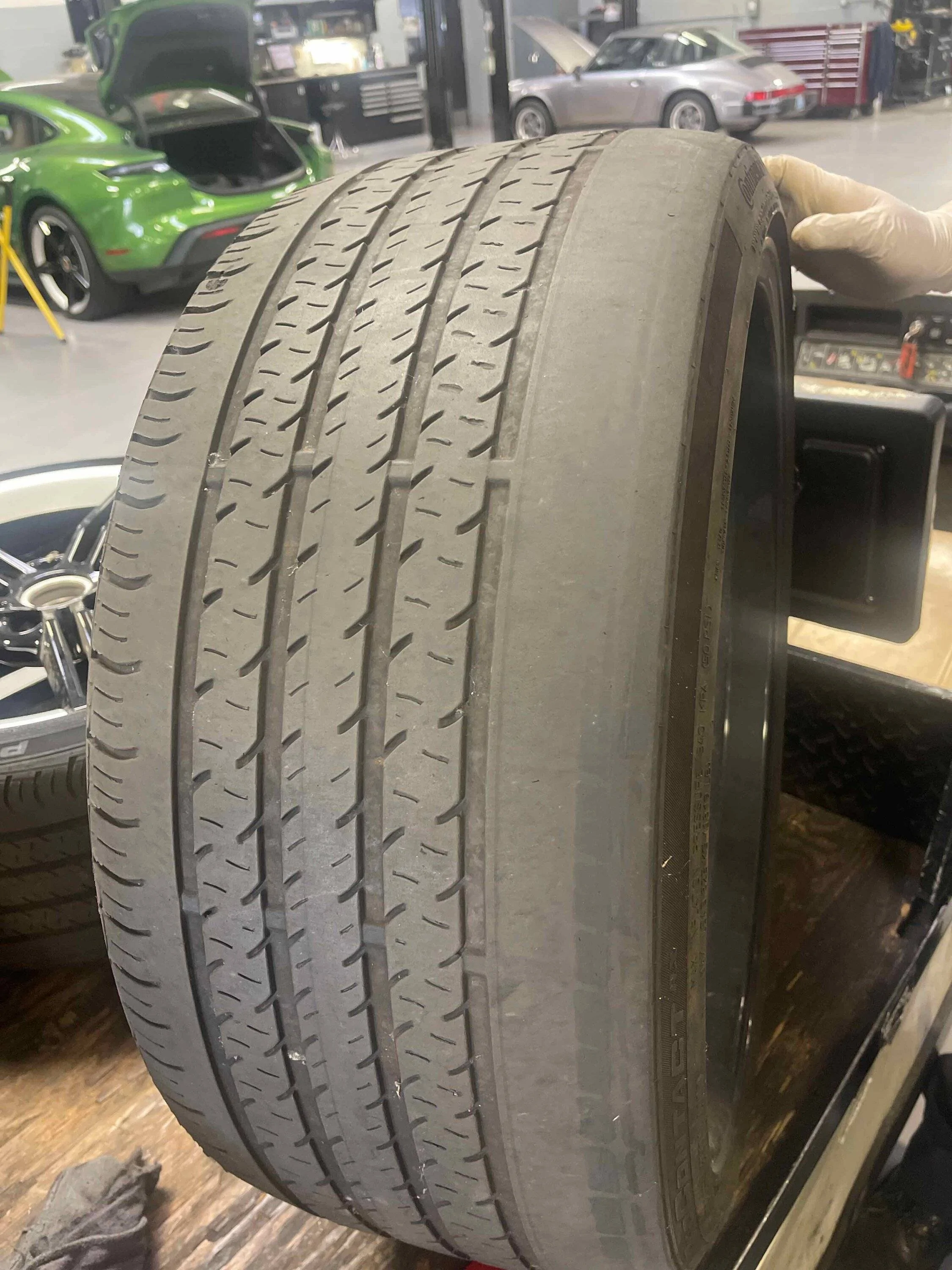

With us being on longer service schedules than ICE, it's easy to overlook issues that a service advisor would have caught. For example, I left the house this morning and got a low tire warning. The pressure dropped visibly before my eyes so I turned around and got it into the garage safely.
I had no idea the tires were this worn at ~10500 miles.
I'll have to call roadside assistance for this one. :(
I need a full set after 9600 miles. Admittedly I drive it like I stole it, and I am always in the 'lowest' ride height. Attached photos showing wear - the worst tire is the rear with the thread showing (similar t above) and the other is the front. All 4 tires show the same wear pattern.

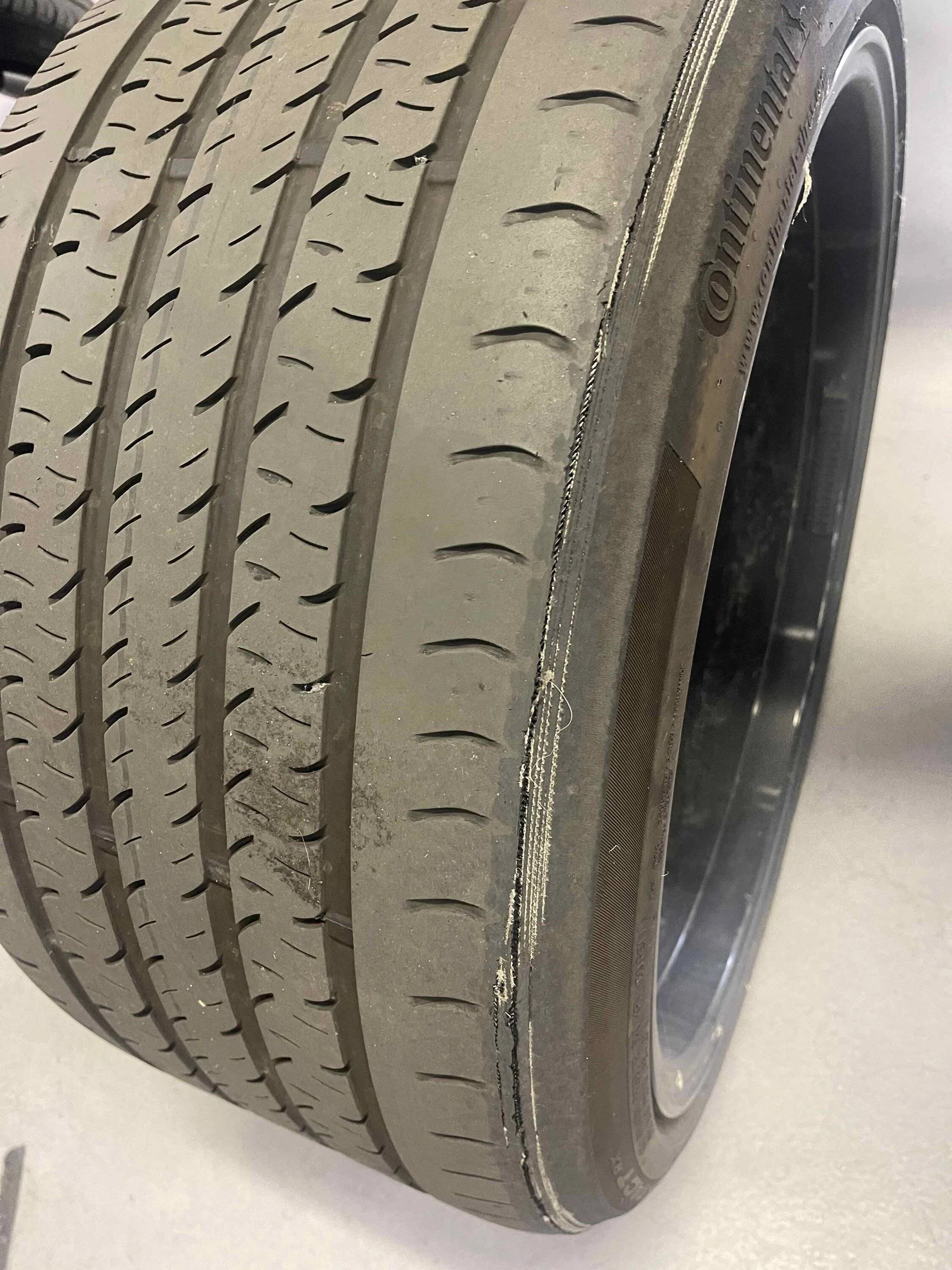

IMO, you have an alignment problem. No way should you get that much wear just on the inside of the tire. And you have wear on the sidewall of the tire. How does one even do that? We’re you running low pressures?
I had a puncture, dont recall the side but that would have been close to replacement anyway.
Porsche are checking the alignment, and implied that the lowest ride height might be increasing camber - which would not surprise me given the wear is on the inside of all 4 tires.. The alignment is costing me $1300 :/ I will provide an update once I know.

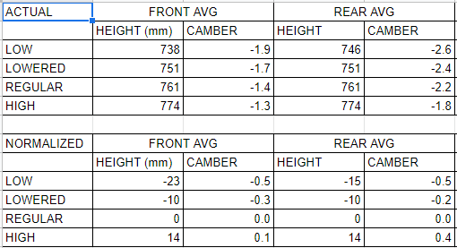

You gain about 0.5deg of neg camber going from regular to low. So yes, it is a factor. Even more so is the ridiculous amount of stock camber in the rear. [Note, this was measured on my CT with 20mm lowering links. The spec. camber values at regular ride height are closer to the 'High' setting in the below table.]

You can look at it another way, for commuting or your daily drive, less negative camber is ideal for wear but it is a detriment to performance because under cornering loads and chassis roll the outsides of the tires will be over worked. To maximize cornering performance, more camber , to a point is ideal. By having different ride heights you can have alignment settings better suited for your commute in regular ride height, or a more performance alignment when in low.
That being said the alignment is generally more biased toward performance so uneven tire wear is going to be the norm unless you go away from the specified alignment setting range.
Camber gain is beneficial for a variety or reasons, but mainly to compensate for body roll to maintain even tire contact patch pressure distribution when cornering.

I'd be more likely to attribute the excessive wear due to bad toe settings as that creates scrub and wears out the tires. On a car like the Taycan, I'd probably prefer a zero toe all around. My typical preference is actually slight toe out on the front for faster turn in. But then my 4S also has RAS, so it may not even need the toe out in the front to help it rotate.
