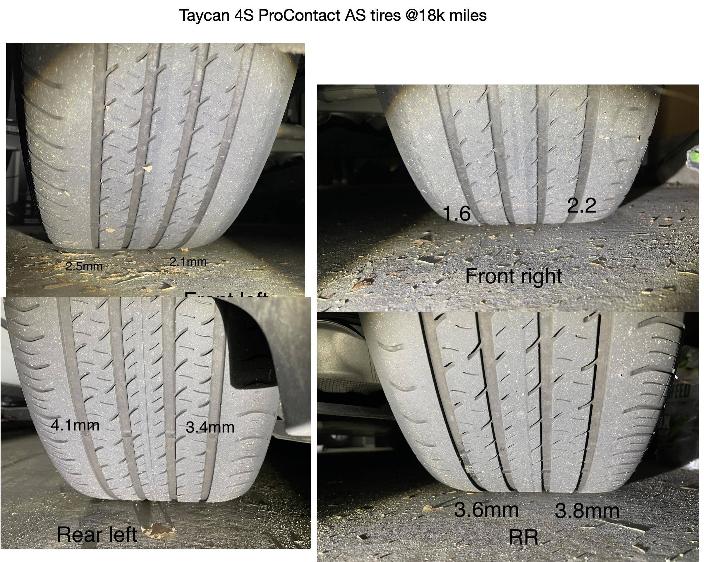

My results from 20" continentals:
They all look illegal (UK anyway) given the wear on the insides, even the RR. Your FL for example says 2.1mm (I guess this is in the groove?) , but i reckon the police here would call that 0, or well past 0. Maybe required depth of 75% of tyre would save it. Dunno.
Certainly done an awful lot better than the Derek's though!
This is indeed a great thread and your pics are a great example of camber variation on tread life. I have about 8K miles on my summer tires and when I switched wheels/tires to winter mode today my wheel guy (not a Porsche mechanic but an excellent wheel guy nevertheless) pointed out the extreme wear on the inner tread. He noted, without even taking a measurement, that the car had well over 2 degrees of negative camber. Oh how I wish I had known that allowing my inner child to drive around like a stud at the lowest possible ride height was just chewing up my inner tread.
Don’t be so sure it’s camber. My service guy said it’s the tire using different compounds on the inner treads.
I replaced with PS4S without doing an alignment, and the new tires are wearing evenly.
I did a little research last night -- because I was so pissed that I was burning through rubber so quickly -- and came to another conclusion: I might simply not be driving aggressively enough for the amount of negative camber when in the lowest ride height setting. My typical use case was lowering the chassis for maximum aerodynamics and hitting the highway at 75-80 mph, all straight line stuff. Heavy duty negative camber, it would seem, is important for high speed corning and actually spreads forces evenly across the treads, whereas with neutral camber the high speed cornering forces get concentrated on the outside edge of the tires. Going forward, I'll have to raise ride height on the highway straight-aways and sacrifice a little on the aerodynamic front (electricity is much cheaper than rubber) and then take all corners at significantly higher speeds. I might get a little chirping from the passengers getting tossed around but it is a sacrifice that they will have to make! By the way, how is the comfort and noise level with PS4S? It won't be long before I need some new summer rubber and need a good recommendation.
Replying to my own post from 1.5 years ago.
I got Michelin Pilot Sport 4 NF0 replacements from Costco, and they lasted 19 months / 16k miles of hard driving when these pictures were taken. I loved the performance, but maybe should have done an alignment in between.
For what it's worth, here are the new results. Already getting new Michelin Pilot Sport 4S (non NF0) for the fronts next.
