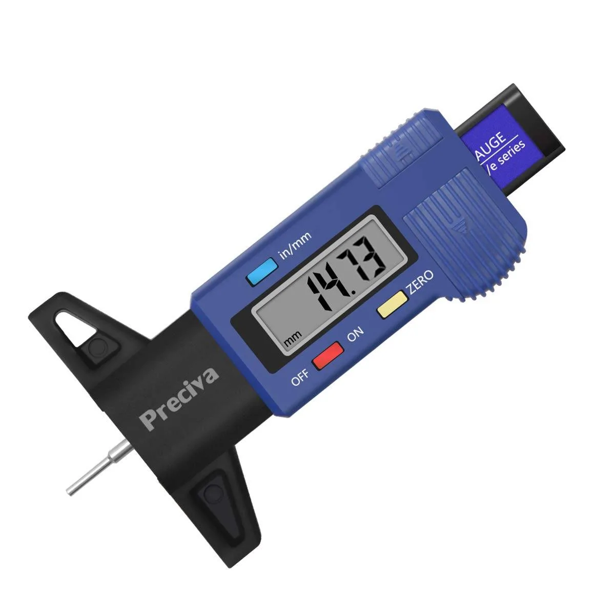

I use one of these on a regular basis
Porsche Taycan Check Your Tires! 51Vwno2XRDL._SL1200_
