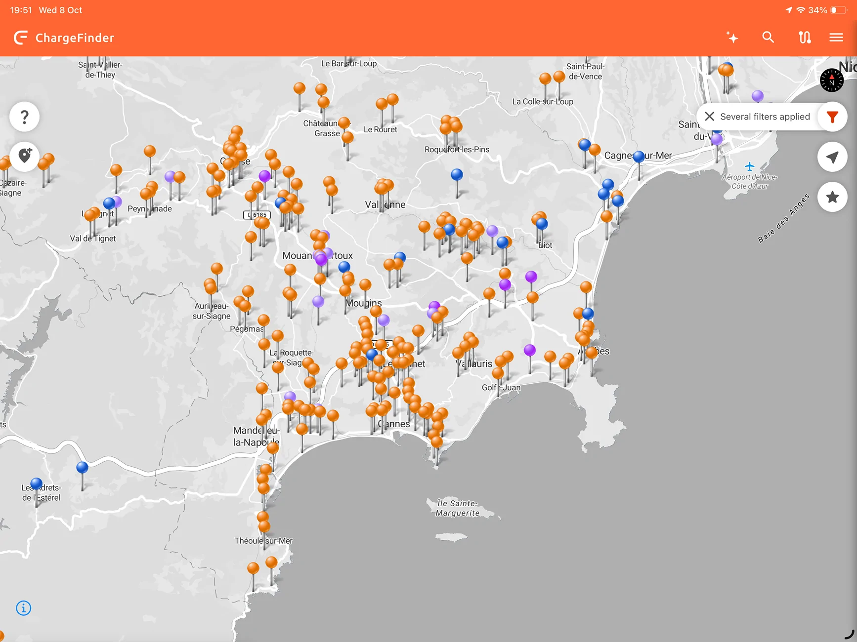

22 kW Is no problem at all at home. Around where I live we have a hell of a lot of 22 kW chargers AC and actually even higher power. See below.
Porsche Taycan Class action filed Sept 25 against Porsche IMG_2783
It is quite nice to have that power available when you are going for a meal at lunchtime or in the evening.
We recently visited friends in Stockholm city centre and there they had a hell of a lot of 22 kW chargers along the streets. I counted to at least 40 - 50 places with parking within about 300 meters radius.
So Europe has home charging as well as a lot of public charging at 22 kW.
