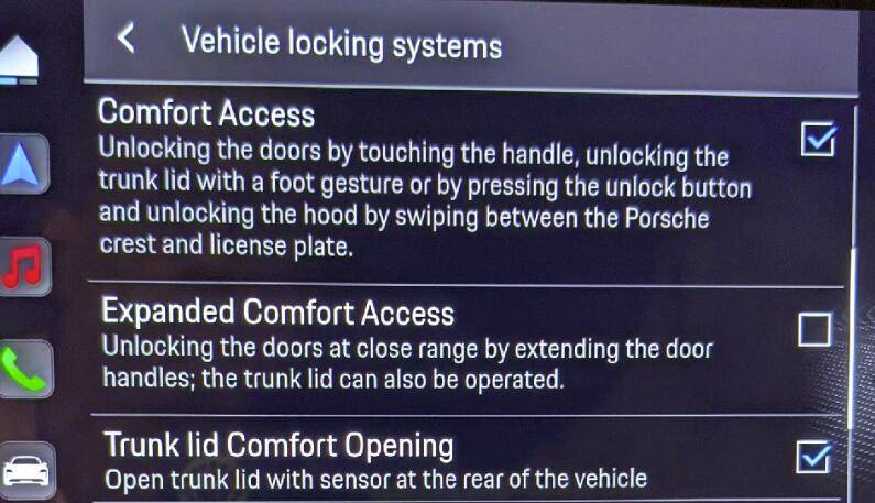

Porsche Taycan Comfort access folding mirrors? 1655911085400
Door handles presenting themselves is the Expanded Comfort Access feature on my RWD that I picked up less than two weeks ago. I unchecked it.
I use the regular
Comfort Access, and the side mirrors fold in if I touch the lock notch on any door handle, click the lock button on the key fob, or walk away from the car without locking it. For the third, apparently the car locks itself when the key fob is out of range.
NEXT-DAY EDIT: CORRECTION - when I walk away from the car the door handles retract but the side mirrors do not fold in. The doors don't lock either. Sorry about my mistake.
