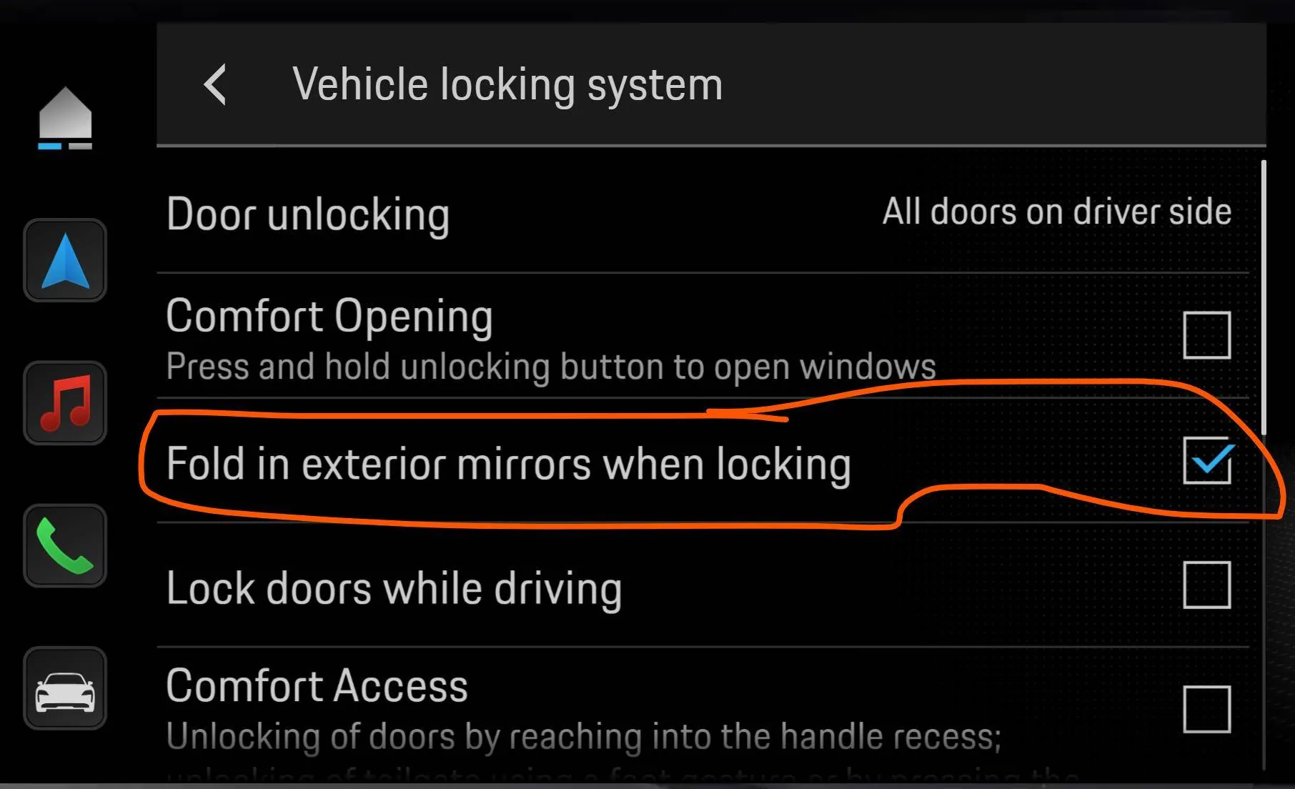

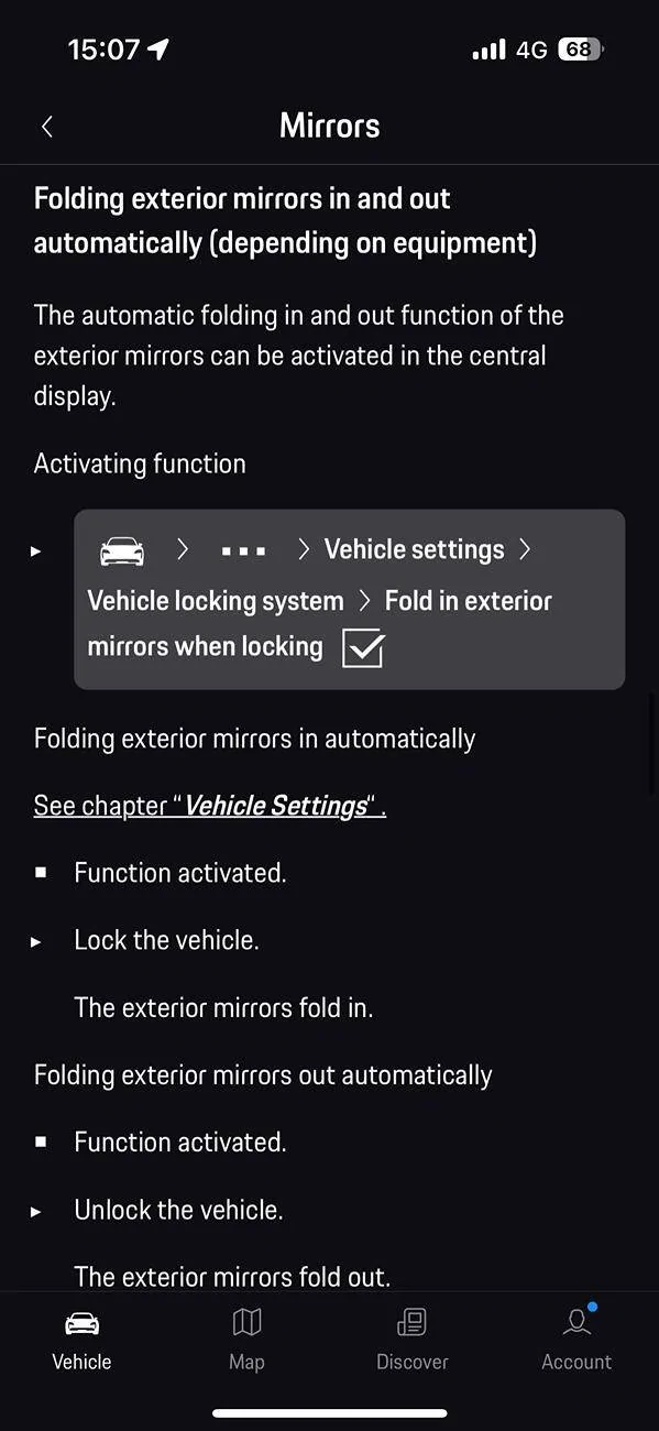

I have a Taycan Turbo MY2022 (based in the UK) and recently purchased it from porsche approved used. I have noticed that upon locking the car, the side mirrors do not fold. The PCM does not have this as an option to enable in the Vehicle Management (as other forums point towards).
Am I right that this was an 'optional' extra when configuring? I would have thought that the Turbow would at least include this as a standard feature!

This appears to be part of the Premium Pack for me in the US in a MY2023 Turbo.
This means that it would be an Option in the US if Premium Pack was not selected.
