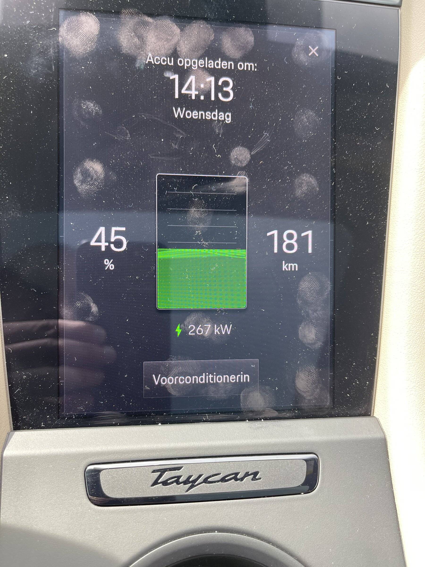

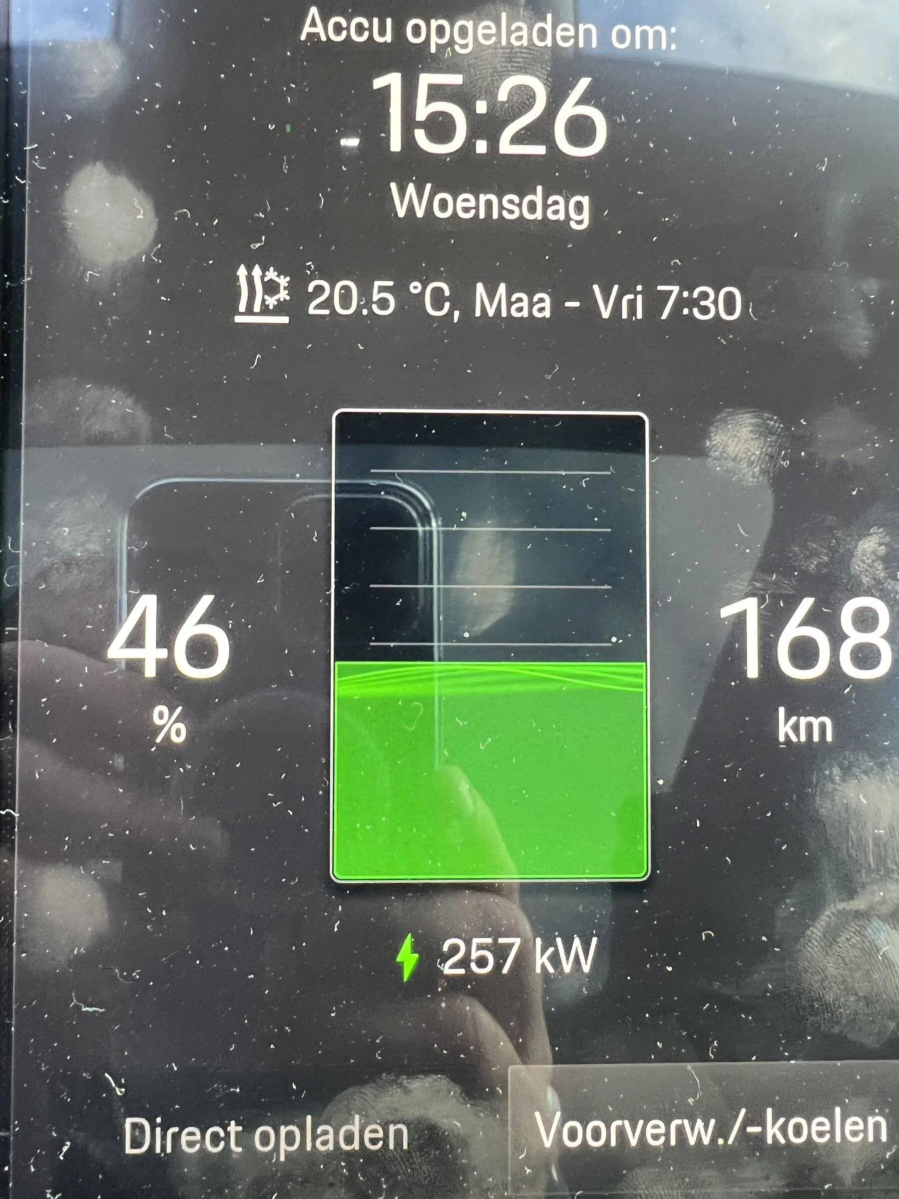

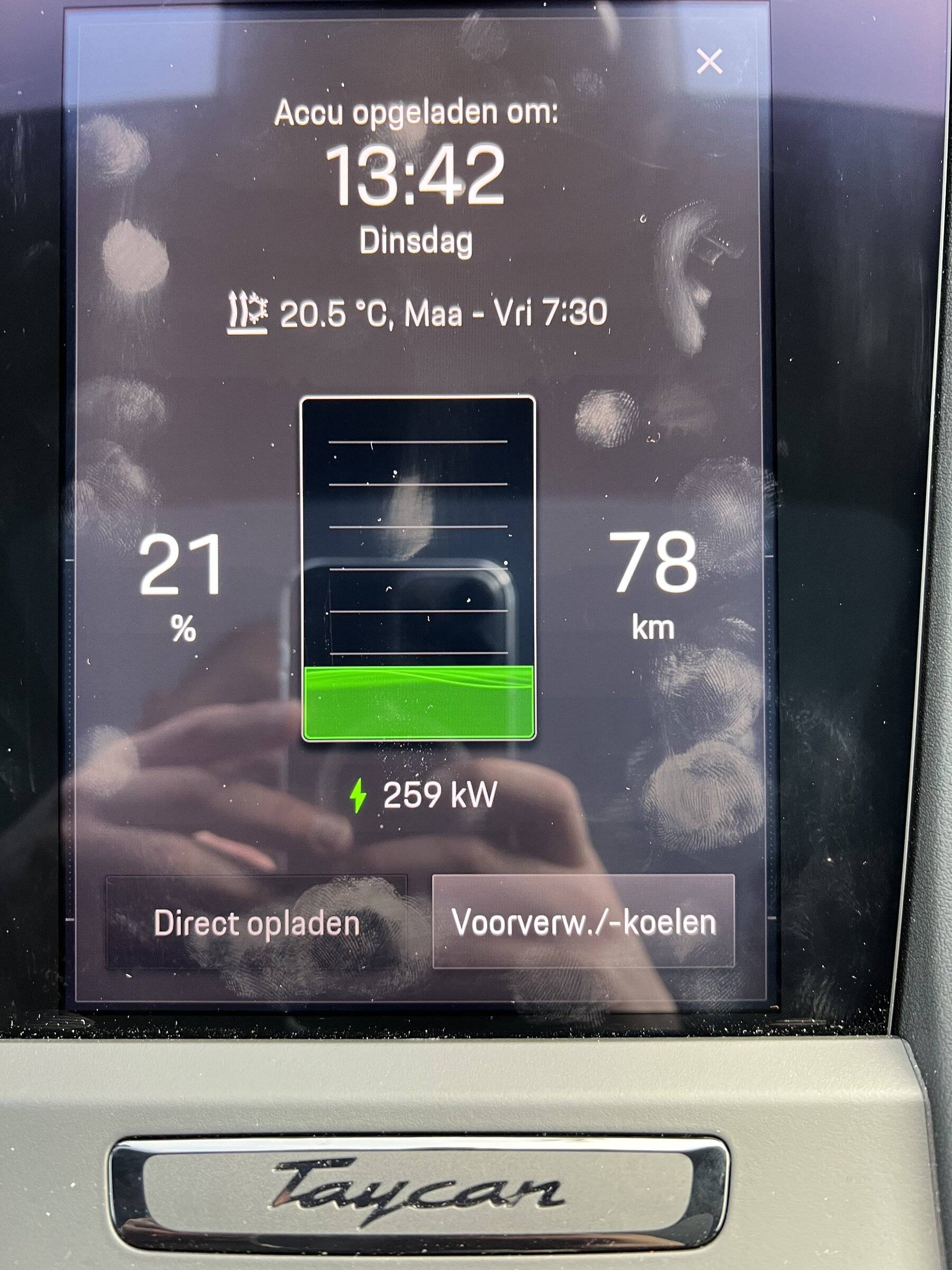

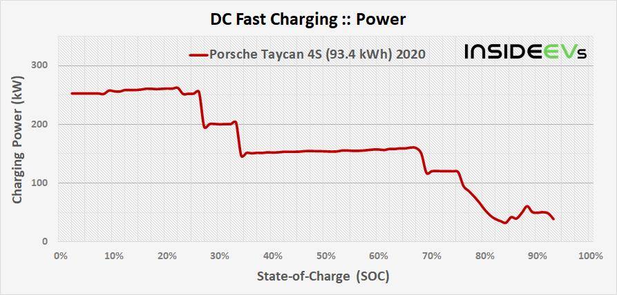

You can see that the graphics from Inside ev is incorrect.
as you’ll see on the pics below
Do you remember at which SOC you started these charging sessions? For my car the charging behavior is pretty much fitting the insideev graph. I am starting to wonder whether there is a difference in charging behavior between earlier and later cars.
I have those results with a MY 21 saloon and a MY 22 CT.
soc around 9% sometimes , much between 9-17%
