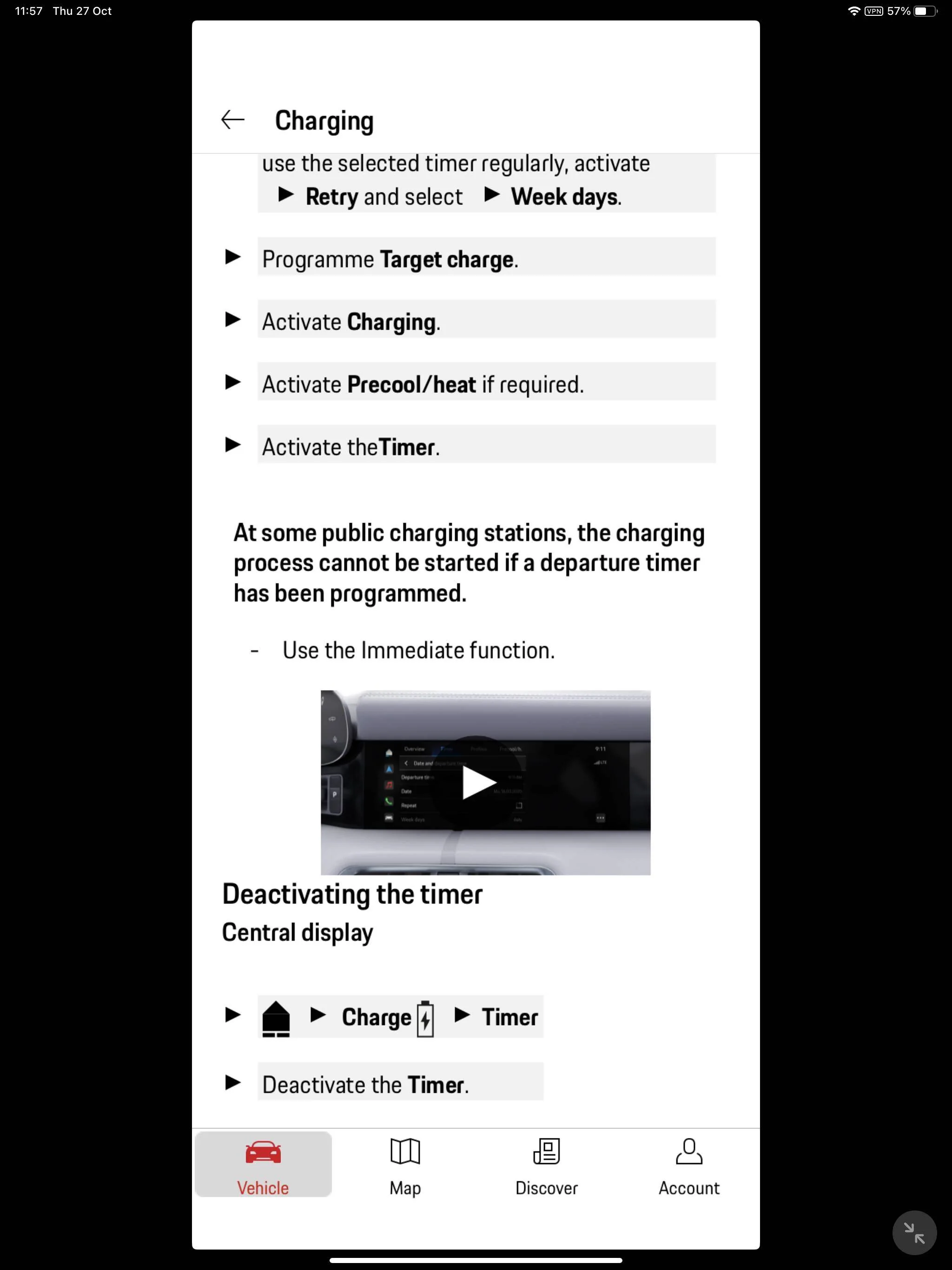

It seems a known problem to start charging on public chargers with timer. Here is an extract from the manual. As said above try using a profile with XY% instead and de activate all timers. That has worked fine for me.

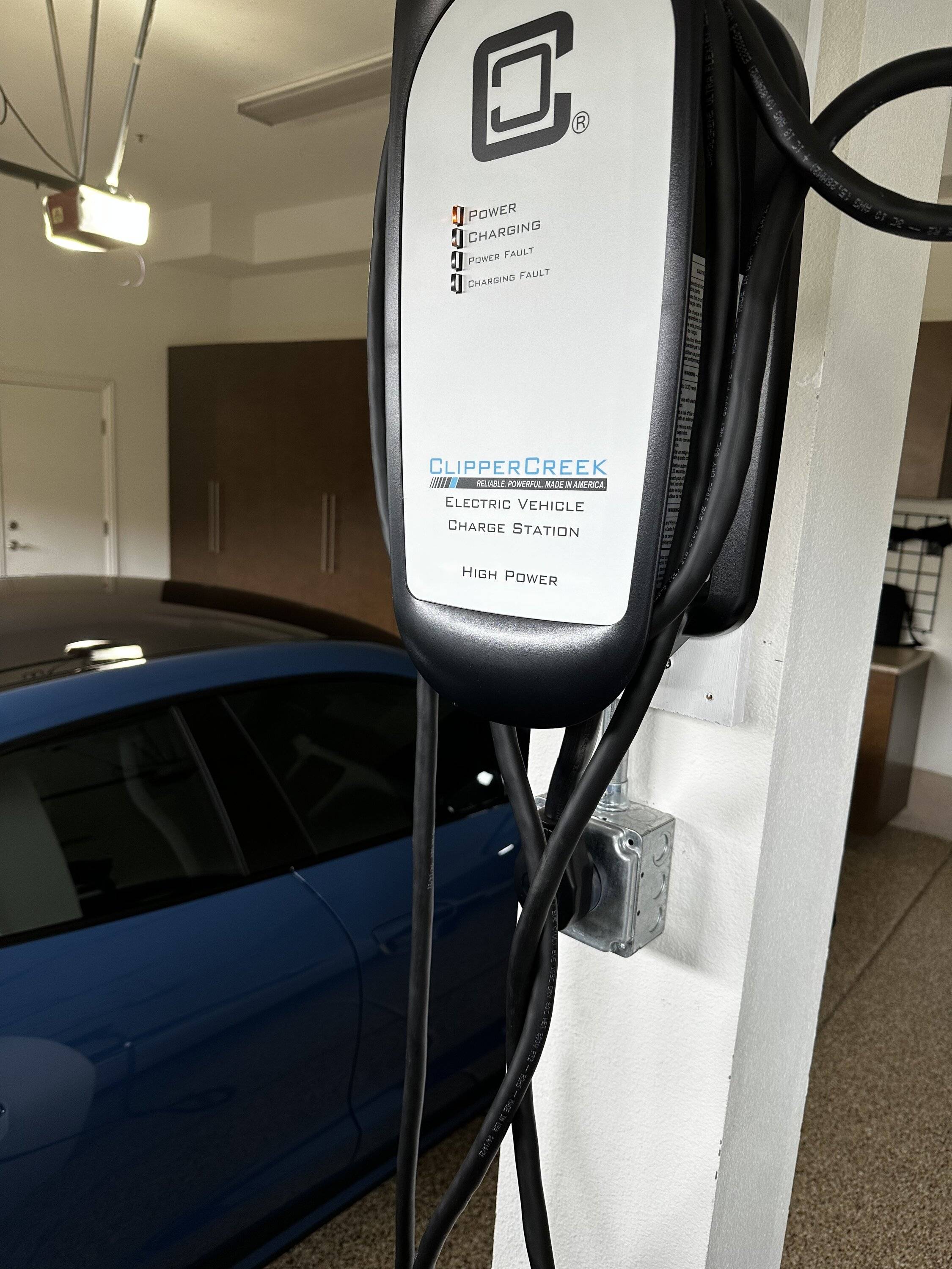

I just called Clipper Creek and had a nice conversation with their tech support. He explained the handshake process of communication between the Taycan and their unit which is causing this problem. He said that all of their units will have the same behavior so if I purchase a Clipper Creek unit for home and use the timer, it will cause the same issue. Basically if the car is not charging, there is an endless communication loop between the car and the Clipper Creek starting and ending a brief charging session. He explained that both are operating within the J1772 safety standards but it is kind of a grey area. He said CC is working on a fix and expects to have this rolled out in 6-10 weeks with new units.
Does anyone have a Clipper Creek unit at home that they cannot use with a timer because of this issue? What units out there do not cause an issue interacting with the Porsche timer?
I have a clipper creek unit at home and it works with the timer where it charges to 85% by 6 am when I plug it in.
