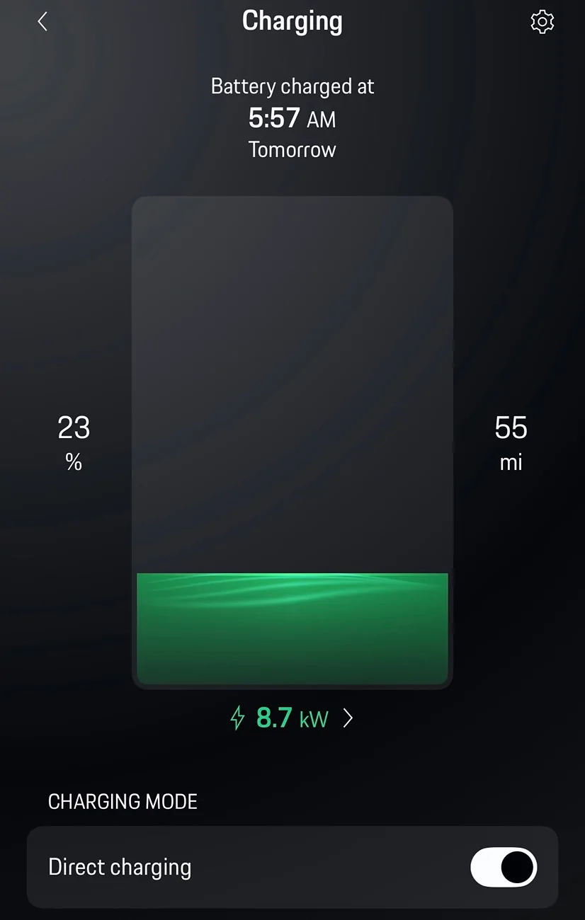

I don’t see a slider option either in the app or in the car. What am i missing?
Your profile doesn't state the model year of your Taycan, but you probably have pre-2025 Taycan (like mine), no slider, direct charging goes to 100% every time (unless you unplug it before 100% is reached).
MY22 - thanks for clarifying
his reference to the slider is akin to your 2022's charging profile and timer to limit the AC (level 1/2) charging level and time-of-use preferences. Porsche recommends up to 85%. I personally go up to 50% for daily use.
