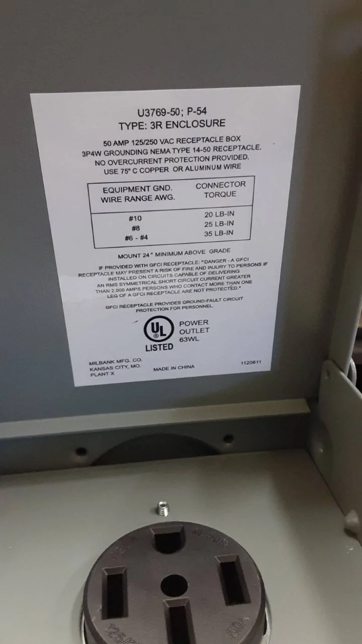

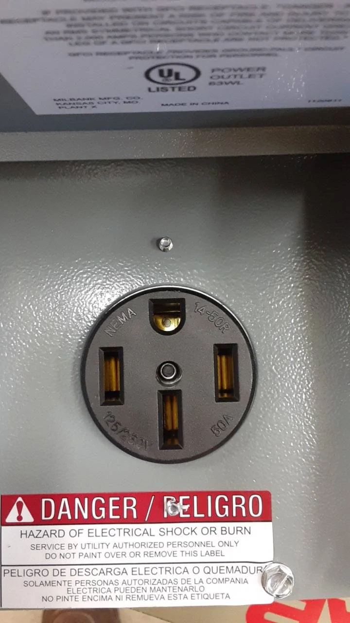

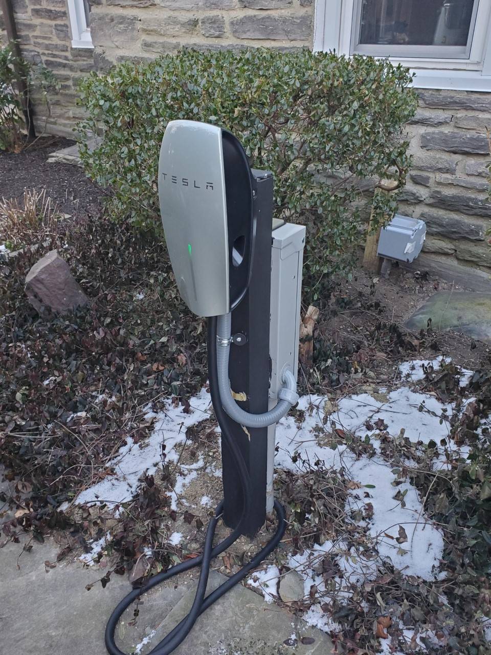

Here are some pics from another outdoor install that one of the electricians I contacted shared with me to give me an idea what I should expect. My setup will be similar - a short trench from the house across some shrubs and the station mounted next to the driveway. I could mount the EV on the side of the house but would have to navigate the shrubs every time. All the equipment on the backside is a little unsightly, would the ClipperCreek or ChargePoint have the same type of equipment as this Tesla charger?
Porsche Taycan Home Chargers - ClipperCreek or ChargePoint? thumbnail_image001

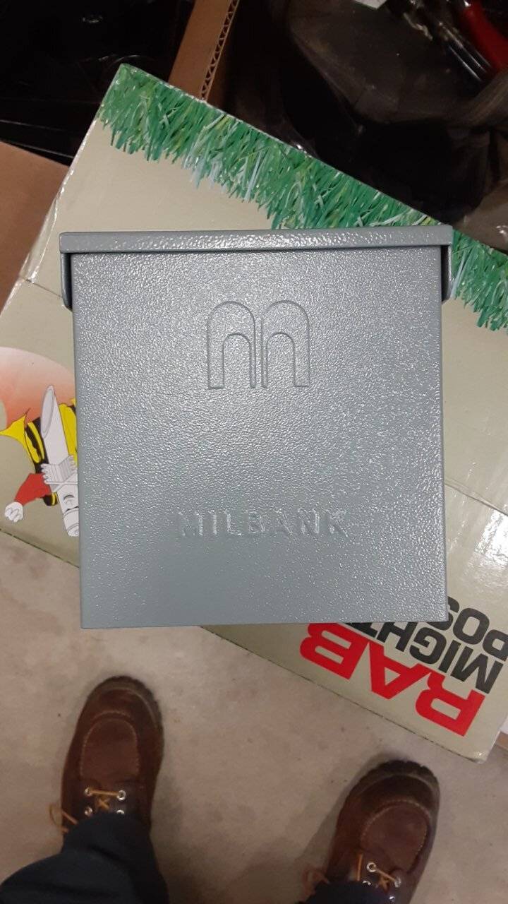

And this is the enclosure unit they use for outdoor 14-50 installs - Milbank Mfg. Co. The outlet comes preinstalled in the enclosure as a unit but the electrician said they'd be willing to get and swap in the Hubbell 9450 outlet. Maybe the Milbank is a quality product and would be fine?
Porsche Taycan Home Chargers - ClipperCreek or ChargePoint? Resized_3
Porsche Taycan Home Chargers - ClipperCreek or ChargePoint? thumbnail_Resized_2
Porsche Taycan Home Chargers - ClipperCreek or ChargePoint? Resized_2
Maybe it would just be better and tidier to do a hardwire outdoor.

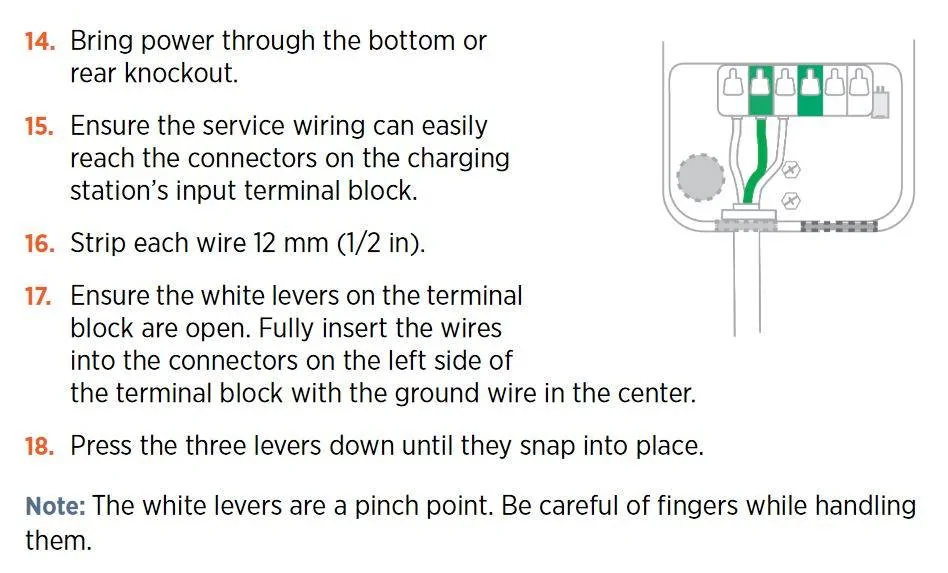

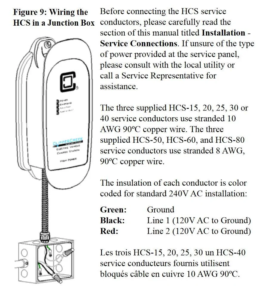

If I was to hardwire it (for 48A charging) then I would pick Chargepoint because you can feed the wire that comes from the breaker directly into the charger (you push in and there is a lever that holds it in place). Clippercreek comes with a pigtail conduit +wire that you connect to the main wire into a junction box. In my opinion this extra connection in the junction box is an unnecessary potential point of failure plus you need to add a junction box that never looks nice.
Check their installation instructions and you will see what I mean.
I see what you're saying about the ClipperCreek:
Porsche Taycan Home Chargers - ClipperCreek or ChargePoint? HCS hardwire.JPG
Compared to the ChargePoint:
