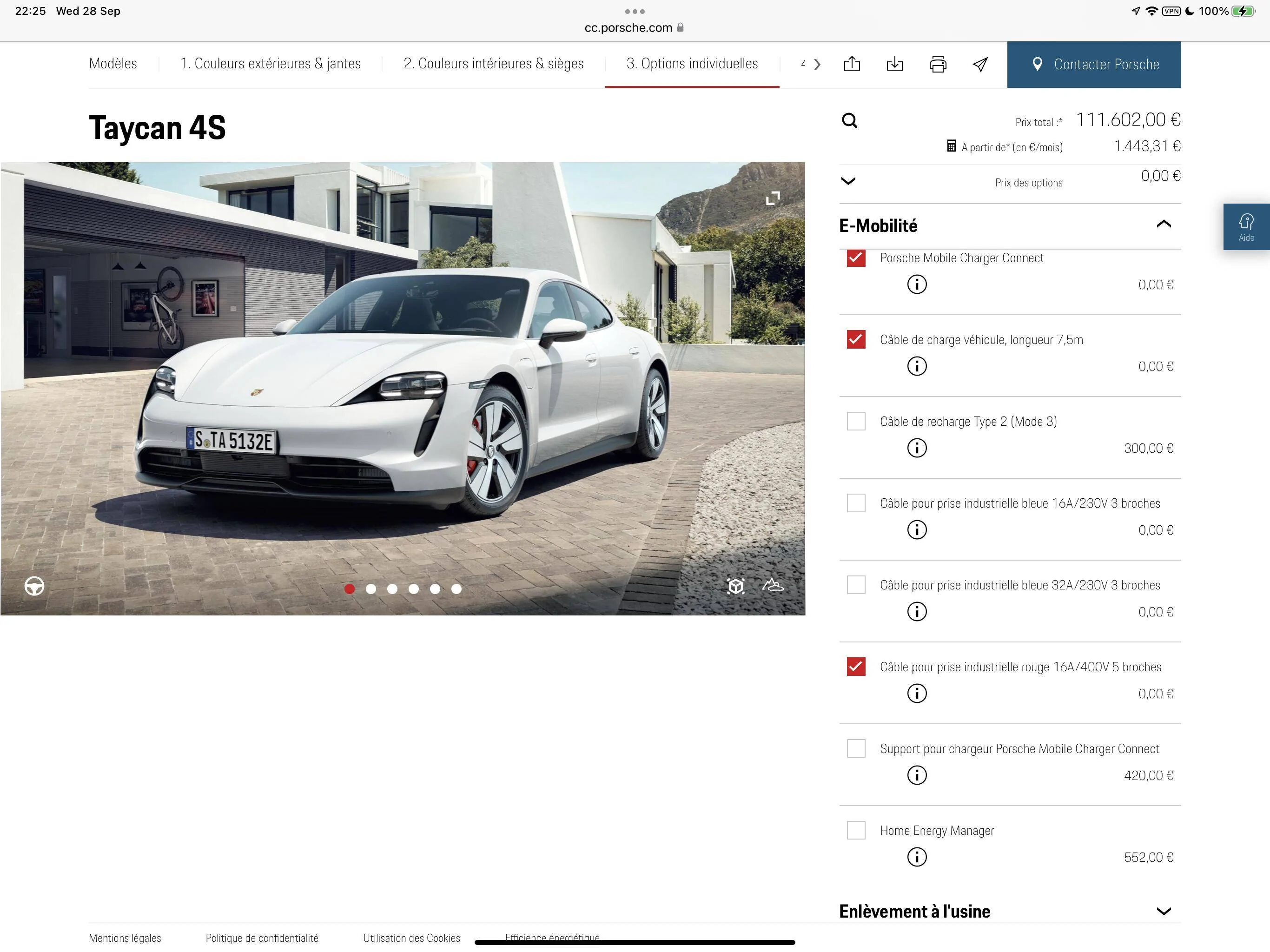

Below is a photo of the Porsche France configurator.

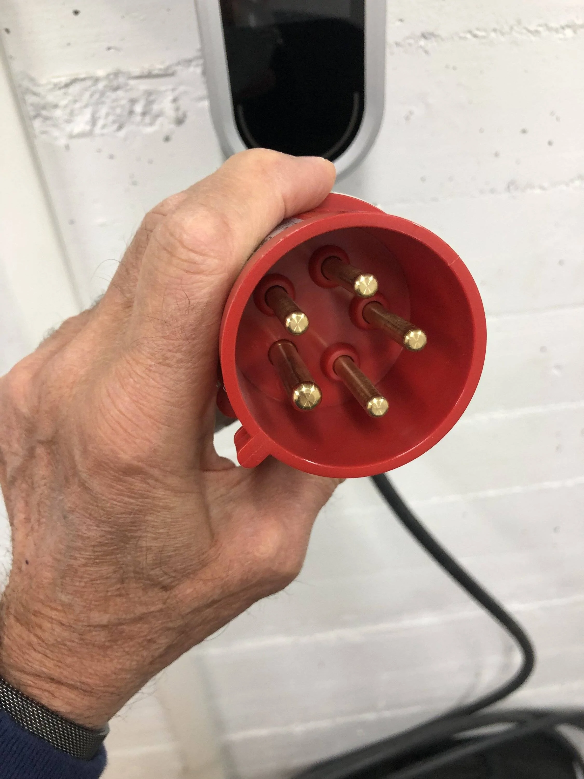

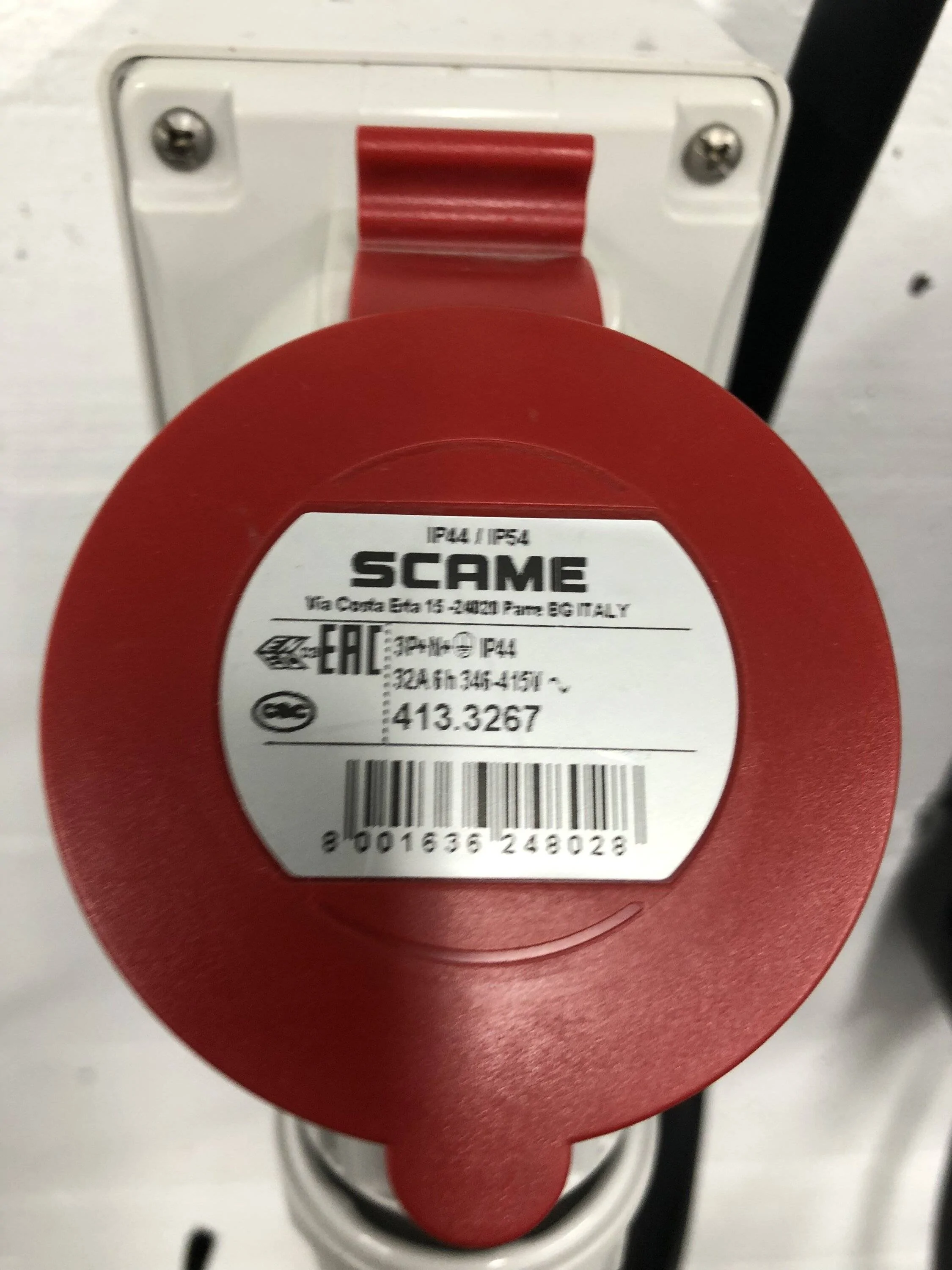

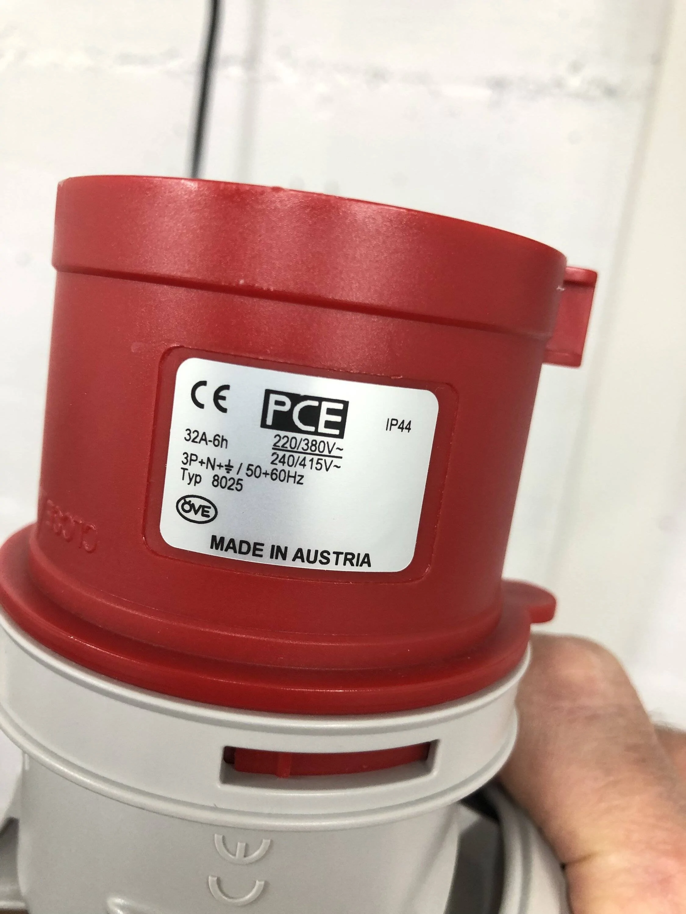

So just to clarify, is the PMCC 22kw come with a 3 phase plug. Does anyone have a picture of one?
Thanks

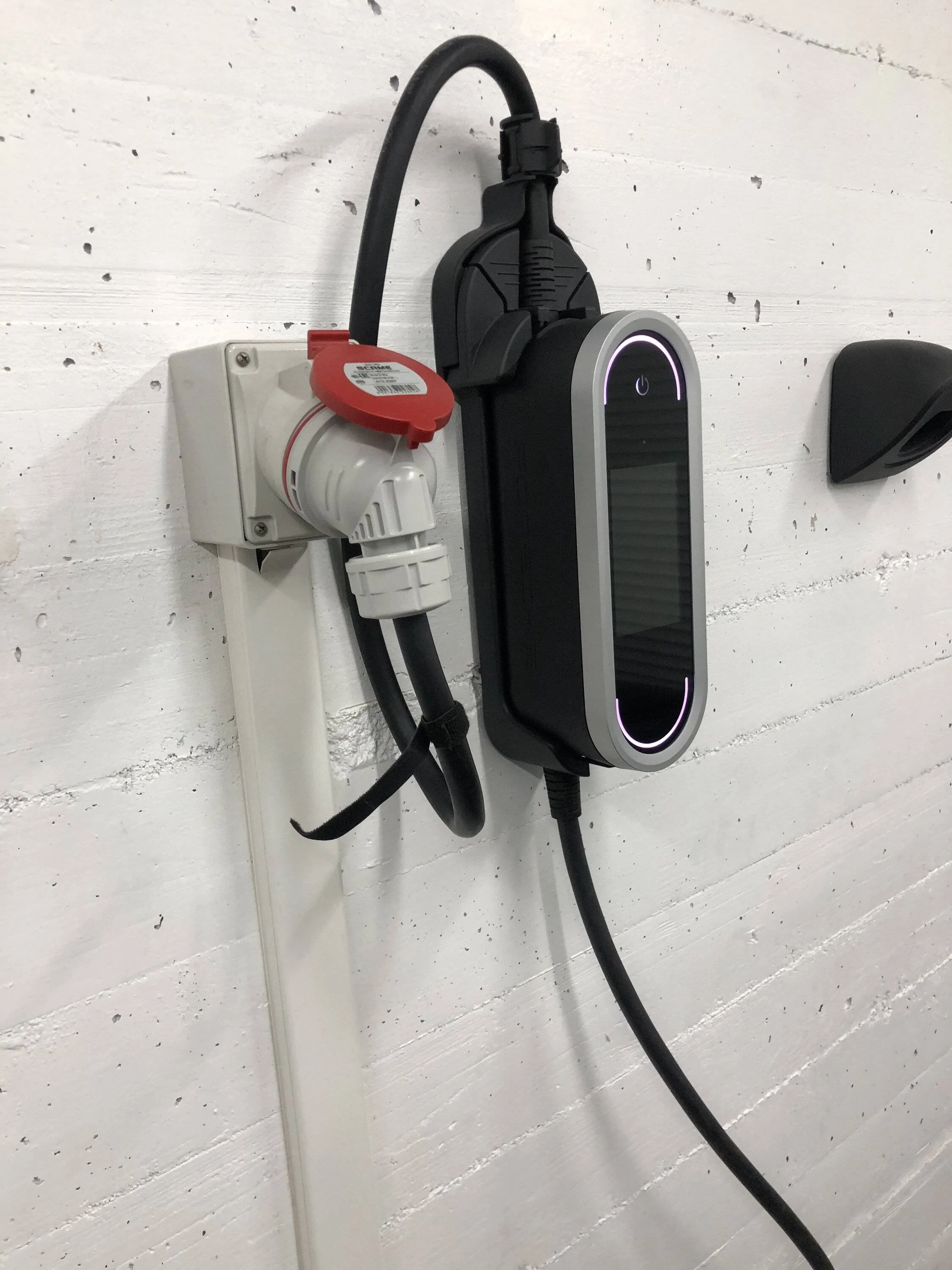

Here you go!
The plug that was installed
Porsche Taycan Newbie question on home chargers A719AFB5-F371-422F-9876-A67B6EFB2605
The EVSE installed
Porsche Taycan Newbie question on home chargers B671FA33-F1E7-40F0-8894-003E9D710BB4
The plug that was supplies 3phase plus neutral and earth protection
Porsche Taycan Newbie question on home chargers FC973E79-BD86-45E1-949C-B03318A76BA2
Porsche Taycan Newbie question on home chargers 8618B5AF-3B9F-4AB3-9B4D-6E257802CBA5

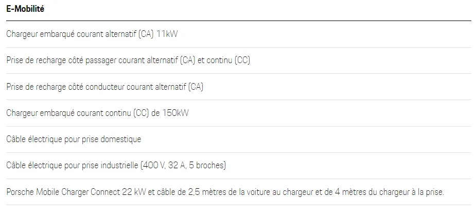

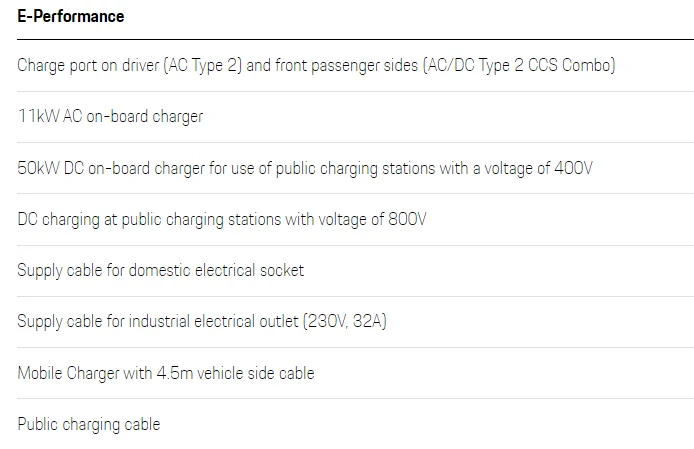

Got to the configurator and check the standard features tab for the car it will be something like:
Porsche Taycan Newbie question on home chargers 1664435038448

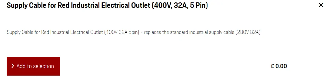

Check the line 'Supply cable for industrial electrical outlet...'. In the example above the supply cable is only rated for single phase and so you will need the following option (note that this substitutes the 230V, 32A cable you get by default).

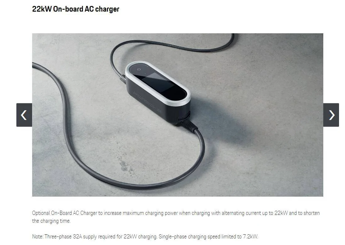

On the UK configurator the Porsche Mobile Charger Connect (PMCC) is not currently listed (this is another problem as it is not clear if this is due to supply issues or other issues).
If you can get a PMCC (and that is an 'if' at the moment) then remember that you will not be able to take full advantage of it unless you also upgrade the onboard AC charger to 22kW (perhaps you have?) and therefore your charging power will be limited to 11kW at home and at public chargers.
Porsche Taycan Newbie question on home chargers 1664435493527
To add both the PMCC (if available) and 22kW On-board AC charger is ridiculously expensive (there are plenty of cheaper alternatives) but perhaps that's not a concern.

Here you go!
The EVSE installed

My French is pretty weak but forget the PMC+ as PMCC and the correct industrial supply cable is standard equipment.
The only decision then beyond installing 3 phase is whether to upgrade the on-board AC charger to take 22kW - if so then you have a fantastic home setup and a great solution for faster public AC charging if DC isn't available.
Ensure your Electrician installs the Red industrial receptacle as pictured above and you'll be sorted.
