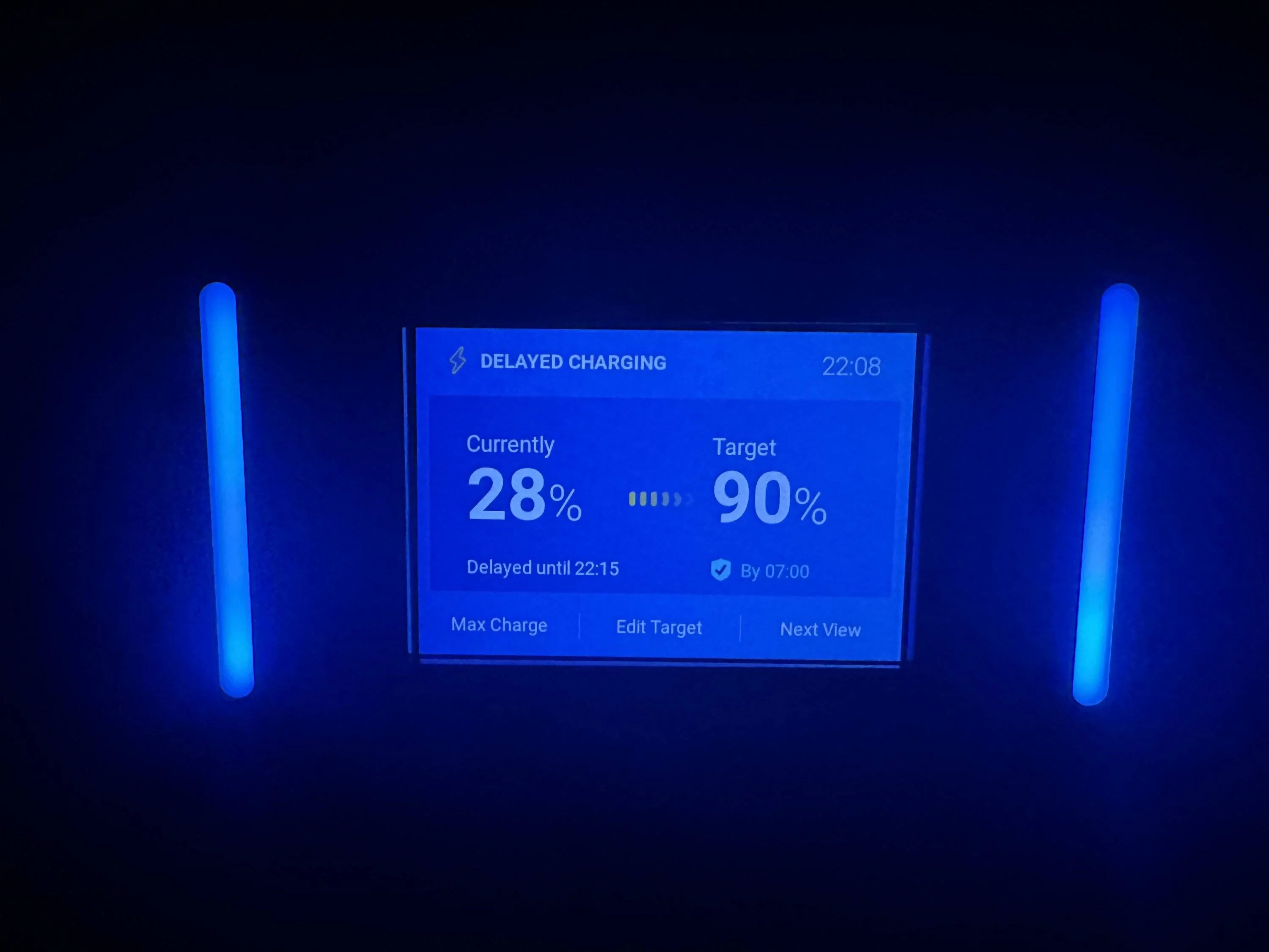

im having similar problems with my Ohme home pro and am completely losing faith in it. Support from ohme has been appalling and finally speaking yesterday they talked me through a new set of steps so that the ohme app controlled it all. Plugged in tonight, chatting error but showed charging to start at 21:15. It actually did but has just failed again.

And now at charger, despite saying charging error on car, it’s saying delayed till 22:15

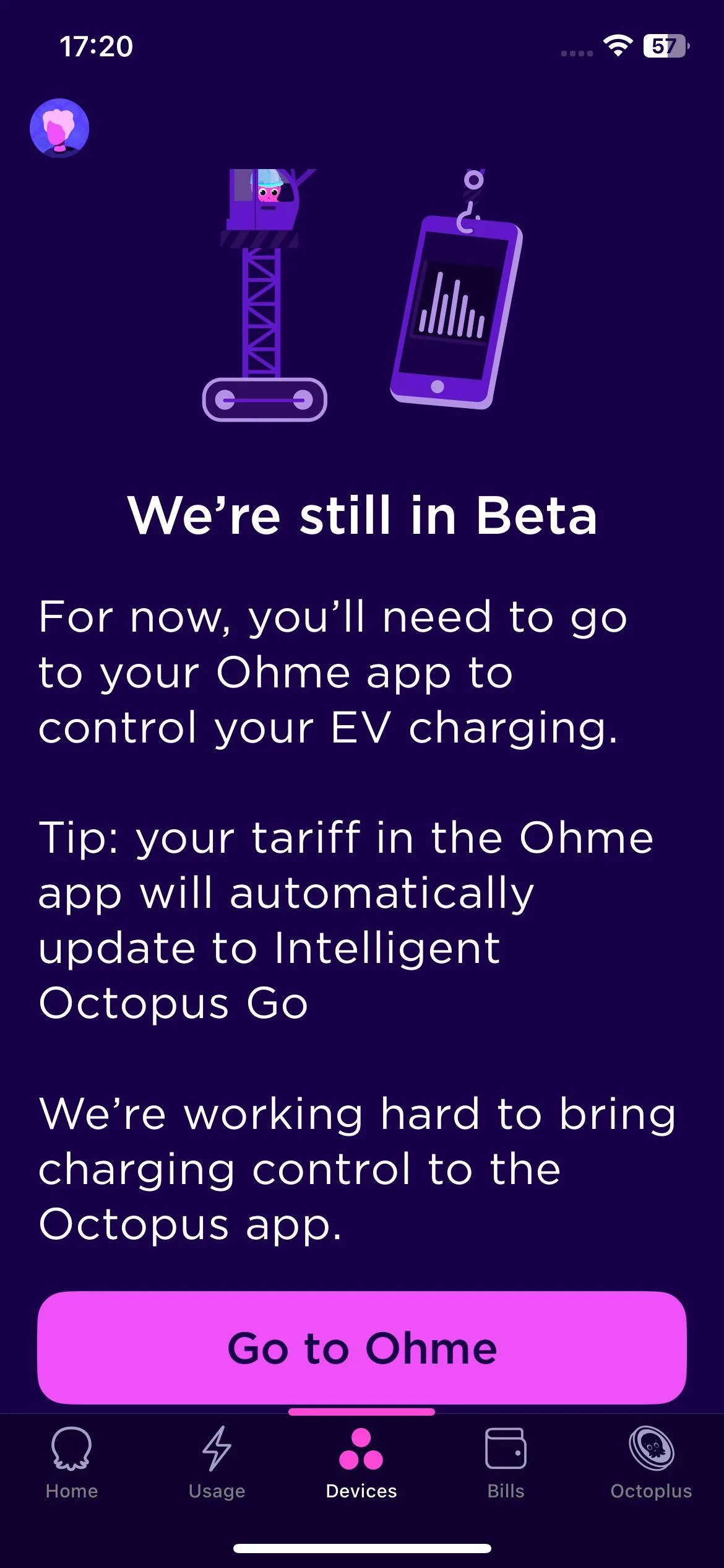

Are you on Octopus Go or Intelligent Octopus Go? I’m on intelligent OG and with Ohme, the Octopus App hands over all scheduling to the Ohme App.
Intelligent Octopus Go. That’s what my octopus app now shows after being run through the changes by Ohme on Monday.
Previously it had the charge setting and time as was car integration as opposed to Ohme.
