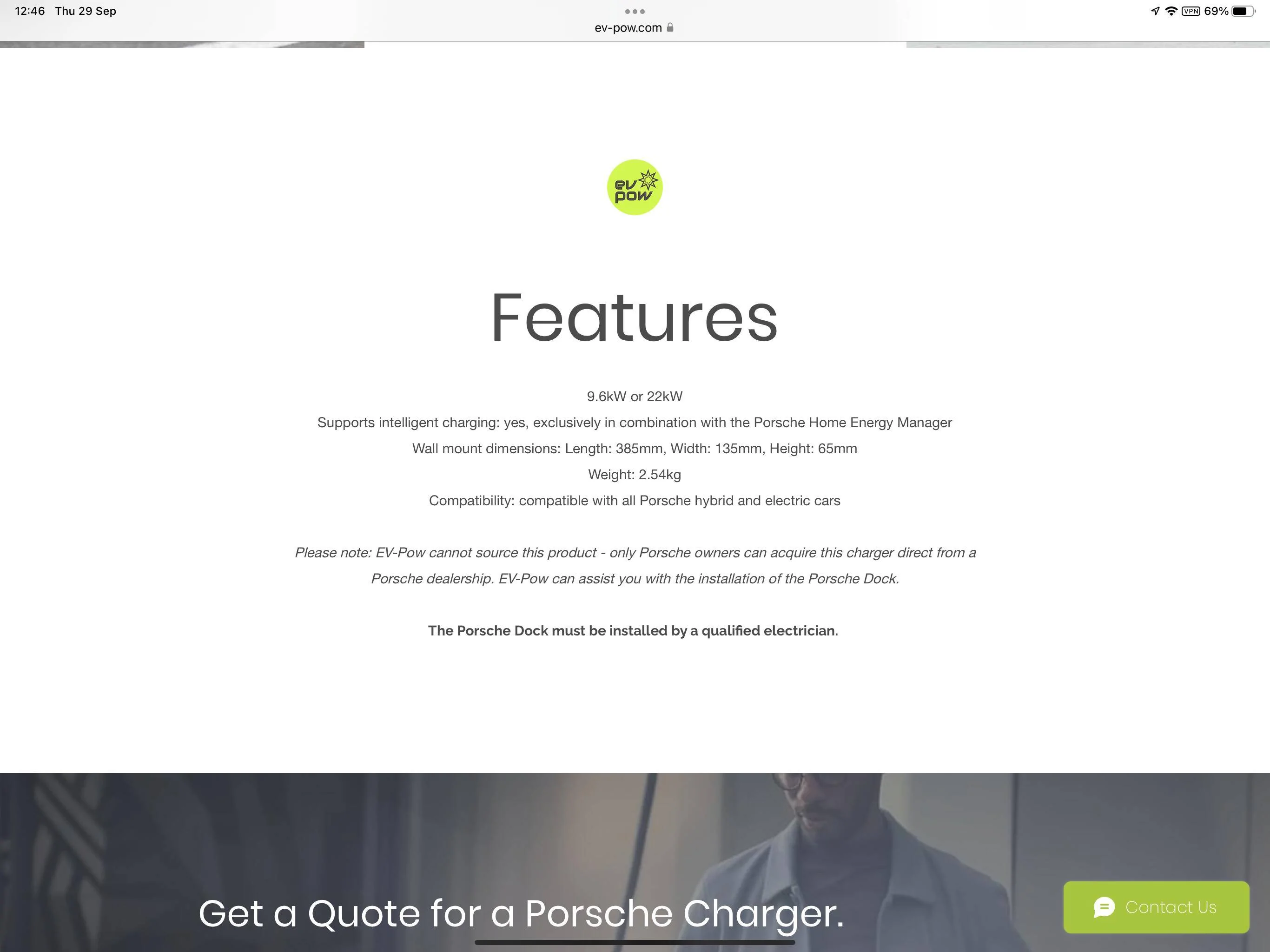

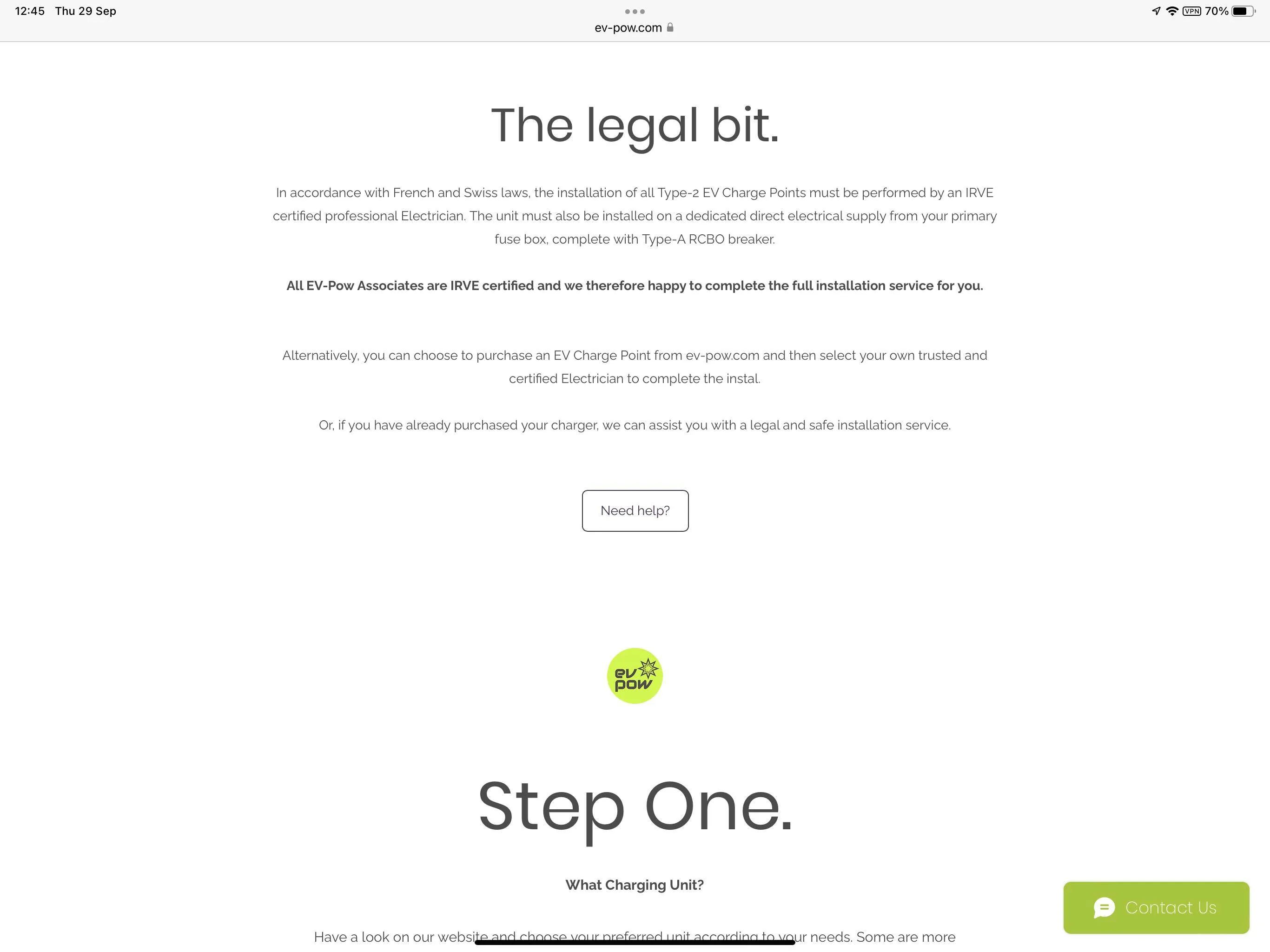

Presumably the French law about installing EV points does not apply if I'm only having a 3 phase socket on the wall installed and using the PMCC.
I am not 100% certain but I would think the law about the installation still is applicable when you connect the EVSE via a plug. There are requirements on how the earth leakage switches should be rated. But I am sure your electrician or Eneeis can advise you. Porsche also earlier offered some kind of survey etc to give the correct advise. Not sure if tht still is applicable though. Ask your dealer.
