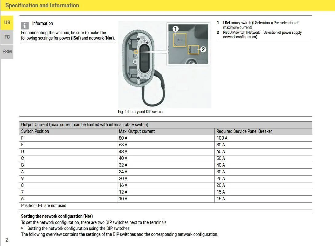

This is just PMCC (at some point later this year it will support 19.2kw) inside the docking station.
I also thought at first. But following the installation manual it definitely isn't. It has configuration options for the electrician to set it up for a hardwired connection. No sockets or changeable adapter cables.
In the US there is no approved plug type to support charging above 40Amps so any charger for 48/60/80A must be hardwired. But still this looks like a hardwired PMCC inside a docking station. It also seems Porsche has chosen to make the docking station mandatory for their 19.2kw charger which I have mixed feelings about because it is a bulky and unnecessary accessory. I have one and it is sitting in its box. All other 3rd party chargers make the hardwired connection in a small electrical box so their hardwired versions are not bigger than the ones with plugs.
